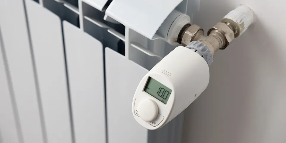

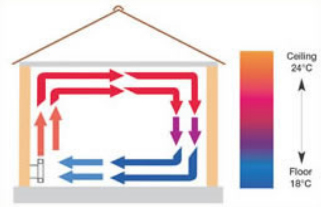

I did try the internet I found pictures like this 1769779278205.png we know heat circulates, circulation.jpg so fitting any TRV at the top of a radiator is clearly wrong, want to measure the return air. So the "Which" report clearly useless when tested on the top.

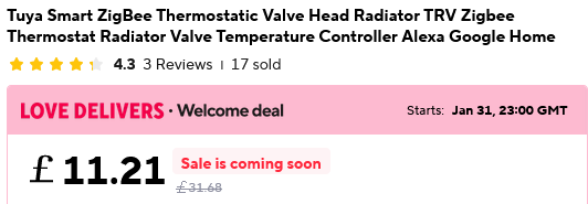

I am considering moving them to the little use flat, and getting versions with internet connectivity. There are other cheap versions
They seem very tempting.
So spec wise seem very good, but the makes I already have vary in battery life, but we have seen so many using Moes wall thermostats, and we do not see loads of bad reports.
