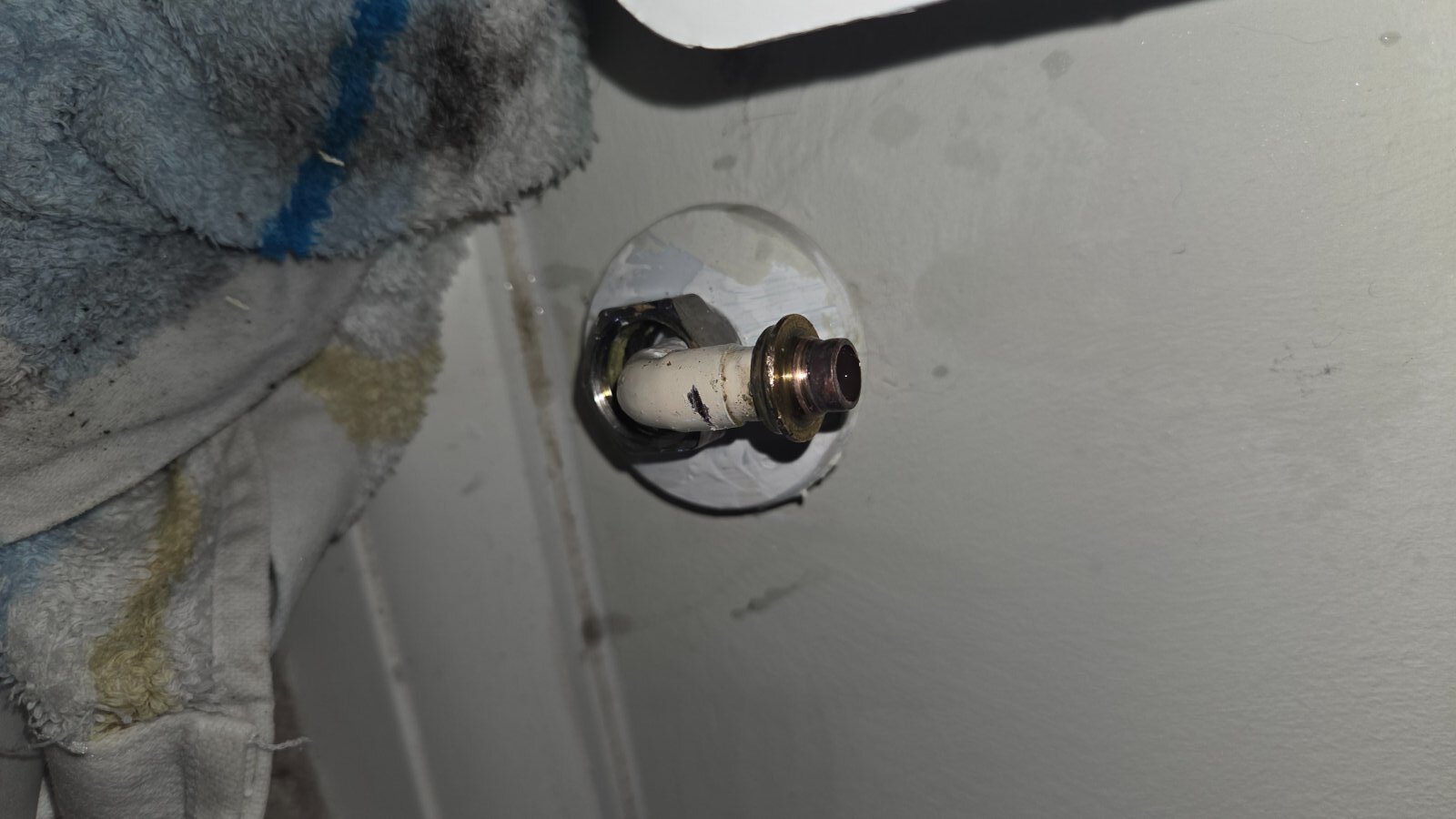

What on earth is this.
TRV was 15mm to 10mm microbore.
I have nothing to work with on the 10mm the njt fits the new trv but wont tighten.
Anyone able to help?
That's an internal reducer, but think you've lost the other part. Probably best cutting that off and using a 10mm trv
Um didnt realise that had come out! Ive just found that. (dark area sorry)
Ive got zero pipe to work with, should i go get another reducer?
You have the bottom half of one of these.............
