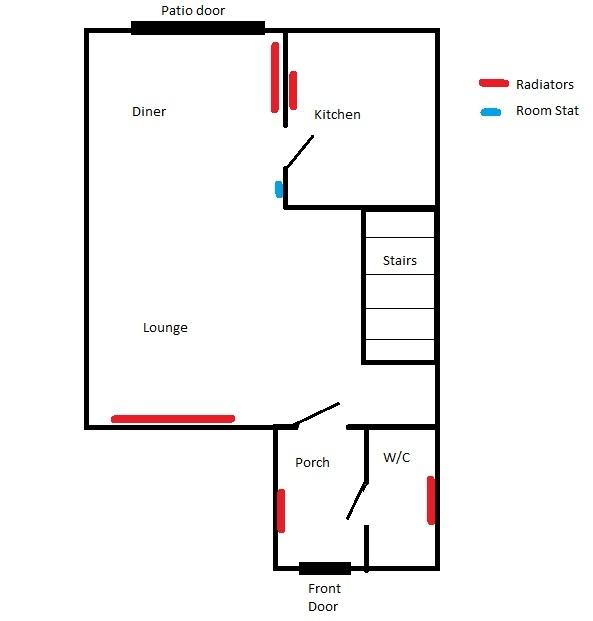

Hi all,
I'm currently looking at installing TRV's on my rads.
I just want to check that I'm doing things correctly.
I am planing to fit TRV's to all bedrooms and bathroom upstairs. However I cannot decide on downstairs.
I have an open plan lounge / diner, the stairs are in the lounge and kitchen at the back of the house. The room stat is at the diner end of the room near to a radiator, I was Not going to fit a TRV here, but not sure if I should fit a TRV at the lounge end of the room or not?
Also would you bother putting them in the W/C and in the porch?
Hope the image helps!
Can anyone advise?
Many thanks.

I would not fit a TRV to either of the rads in the room with the room stat. The two spaces are effectively 'in contact' and with one rad shut down from a TRV the other may never get the room hot enough for the stat to operate.

Defo fit them on the kitchen, porch and loo.
Don't fit one on the one near the room stat, it's up to you if you fit one to the other one.
If it were me, i would. You might as well as the system is drained down and only cost a few quid.
