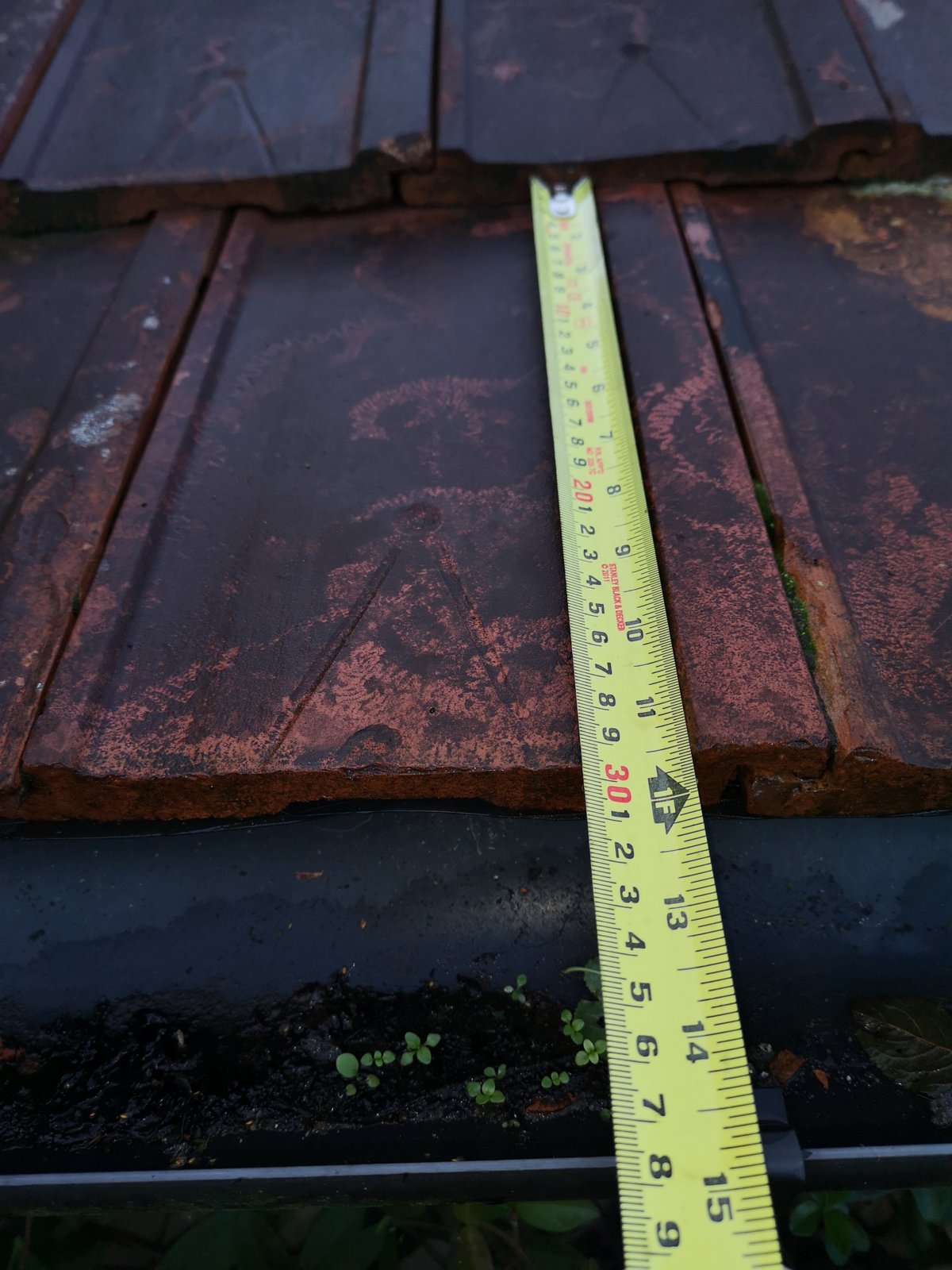

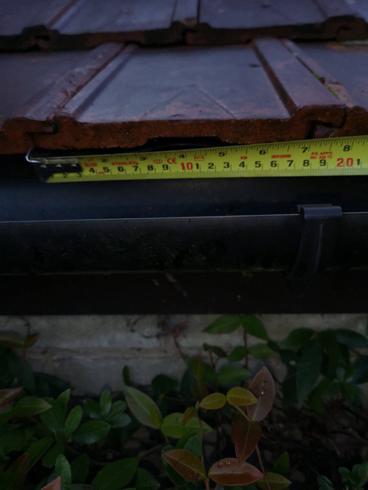

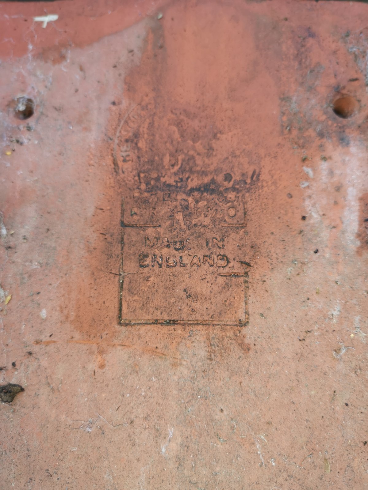

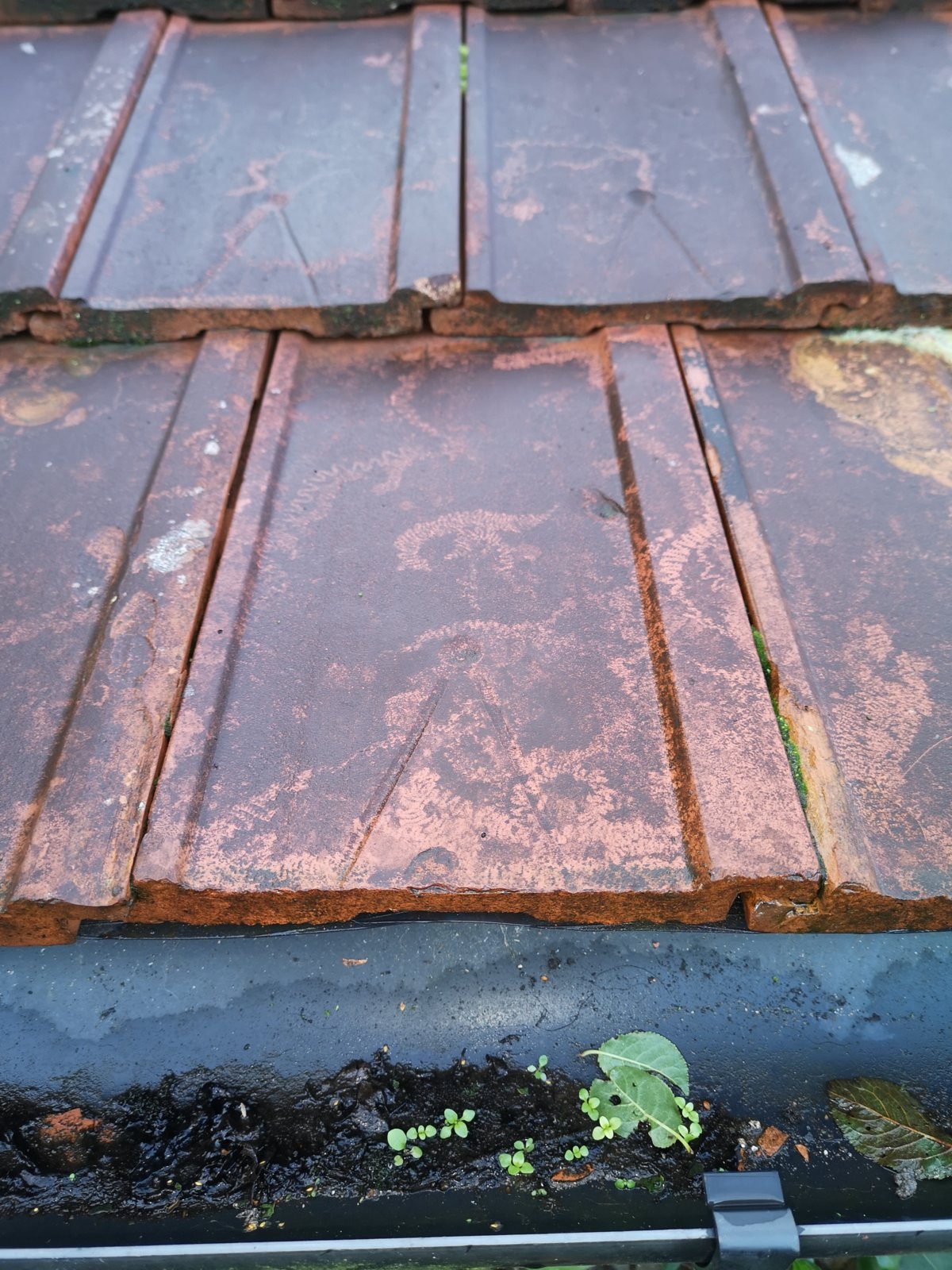

Greetings all,
I am trying to identify the style and who made/still makes these roof tiles. I know that they were made in England and we're used in the Norfolk/Suffolk area but apart from that I am not having much luck.
Any help would be much appreciated.
Probably 15 of them to cover what are broken now, what I brake when replacing the already broken ones and some for the future.
I don't know where you're based, but there's an architectural reclamation yard in Stokenchurch, west of High Wycombe, and they will very probably be able to help. The rarer they are, the dearer, obviously. I almost bought a house in south Buckinghamshire some years ago and those tiles were on that. Local roofers did the sucking their teeth routine when i enquired about availability, but every one would have been well aware of the yard I mentioned above. http://djgiles.co.uk/
They are bridgewaters and come in 1 or 2 channels.
I managed to get some from Taylors in Wisbech.
