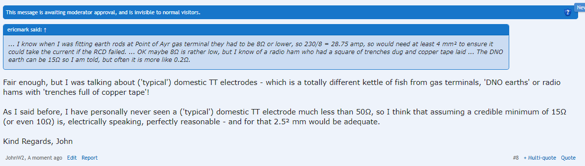

Fair enough, but I was talking about ('typical') domestic TT electrodes - which is a totally different kettle of fish from gas terminals, 'DNO earths' or radio hams with 'trenches full of copper tape'!
As I said before, I have personally never seen a ('typical') domestic TT electrode much less than 50Ω, so I think that assuming a credible minimum of 15Ω (or even 10Ω) is, electrically speaking, perfectly reasonable - and for that 2.5² mm would be adequate.
Kind Regards, John
