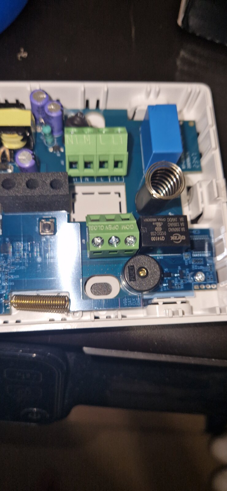

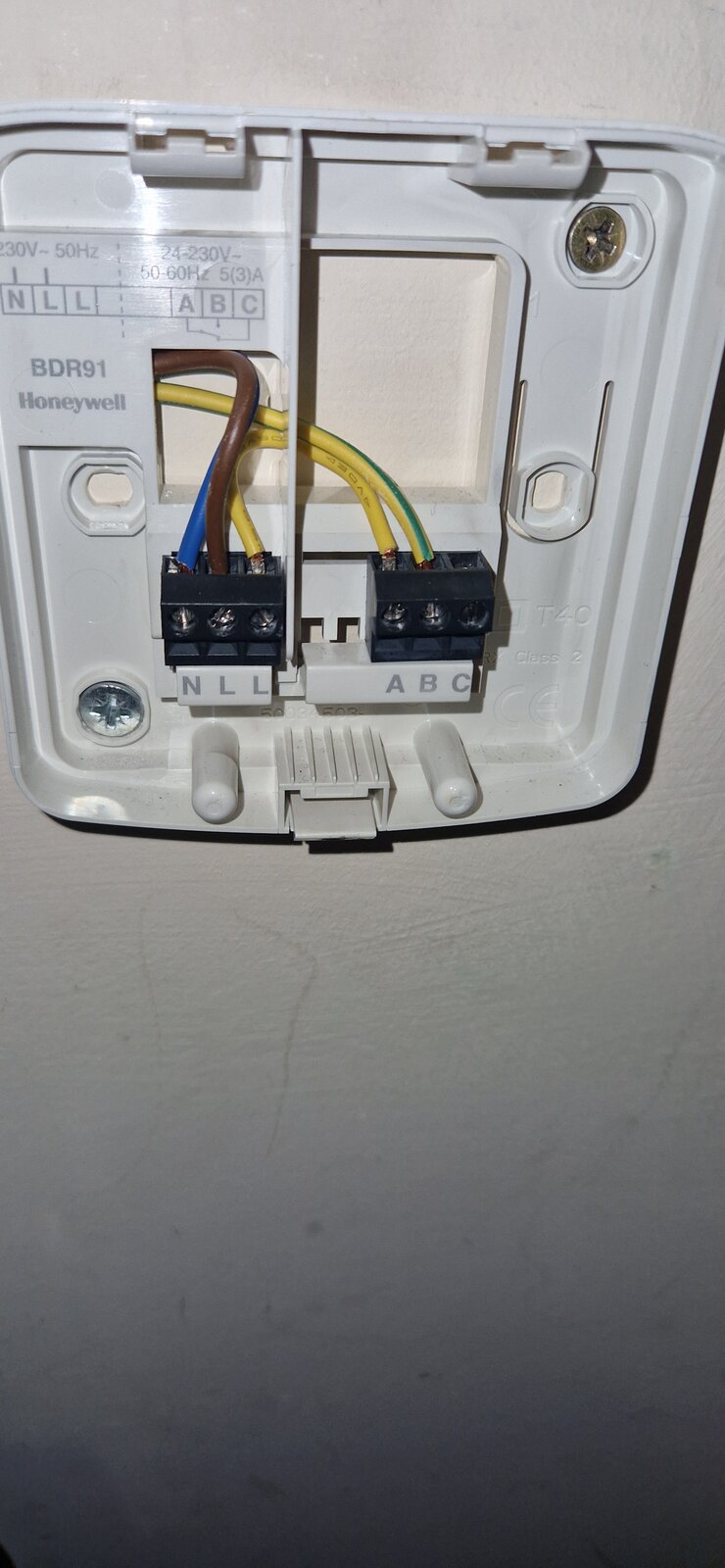

Which wires from the old honeywell receiver ( dia.1) go to the new wireless tyua t9w-rc 240v (dia.2) much appreciated for any help . Have no heating/ Water Atm ‍♂️

L to L, N to N, A = Link L1 and Com using existing wire and B = Open. You might consider putting some brown sleeving or brown insulation tape on the green/yellow wire. Why don’t you have hot water if all you’re doing is the room thermostat?
