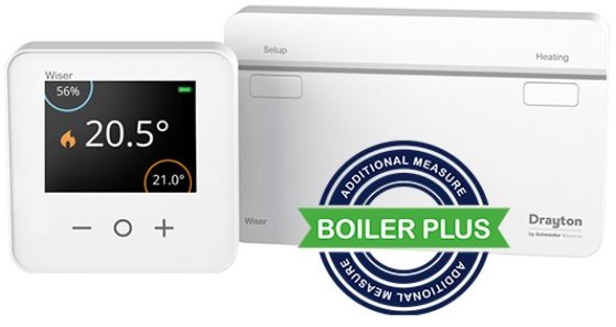

There are several Wiser starter kits. For a straight swap of an existing wired thermostat on a combi boiler (ie one without a separate hot water cylinder) you should have the 'wired version' of the Wiser. With the wired version then the wires from terminals 1 & 3 of the Honeywell T6360B simply go to COM and NO at the Wiser instead. And the existing boiler time control is set to be permanently 'on' 24/7 allowing the Wiser to take full control.
However from your description it sounds as if you may have the version with the separate wired control box like this....
....if so, it becomes more complicated. This is really for systems where there isn't an existing wired thermostat and the thermostat installation is from scratch. So to answer your question, if you do have the Wiser with the control box, the best way forward would probably be to exchange it for the wired version.
However if you did want to use the wireless version, unless you were happy to have the control box on the wall where the existing thermostat is then it would need rewiring. Also, if there isn't a neutral connection made to terminal 2 of the Honeywell T6360B [some installations have this connection and some don't] again some rewiring would be required.

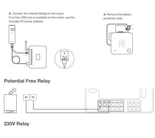

Am I right in thinking that the wireless receiver/extension that I can wire into the boiler would only be of use if I have a wireless thermostat or for hot water? As I have a combi boiler and will fit a wired Tado thermostat, I presume I won’t need the wireless receiver, simply the internet bridge which I have connected in my router
That's generally the idea. The wires shown from the boiler as 'RT' [Remote Thermostat] in the diagram below are those presently going to your Honeywell thermostat terminals 1 and 3
11-jpg.222156
You can use a wireless thermostat with a combi and they frequently are. For example in a new installation, or with one that already has an existing wireless thermostat. The wired receiver can be connected at any convenient point, usually next to the boiler, and then the thermostat can be positioned in the best location without the need to run a new cable out to it.
Where there is a hot water storage cylinder, then the wired receiver would replace the existing programmer. The heating / hot water control wires are already at the programmer, so it's a swap of the existing programmer for the wireless receiver.
