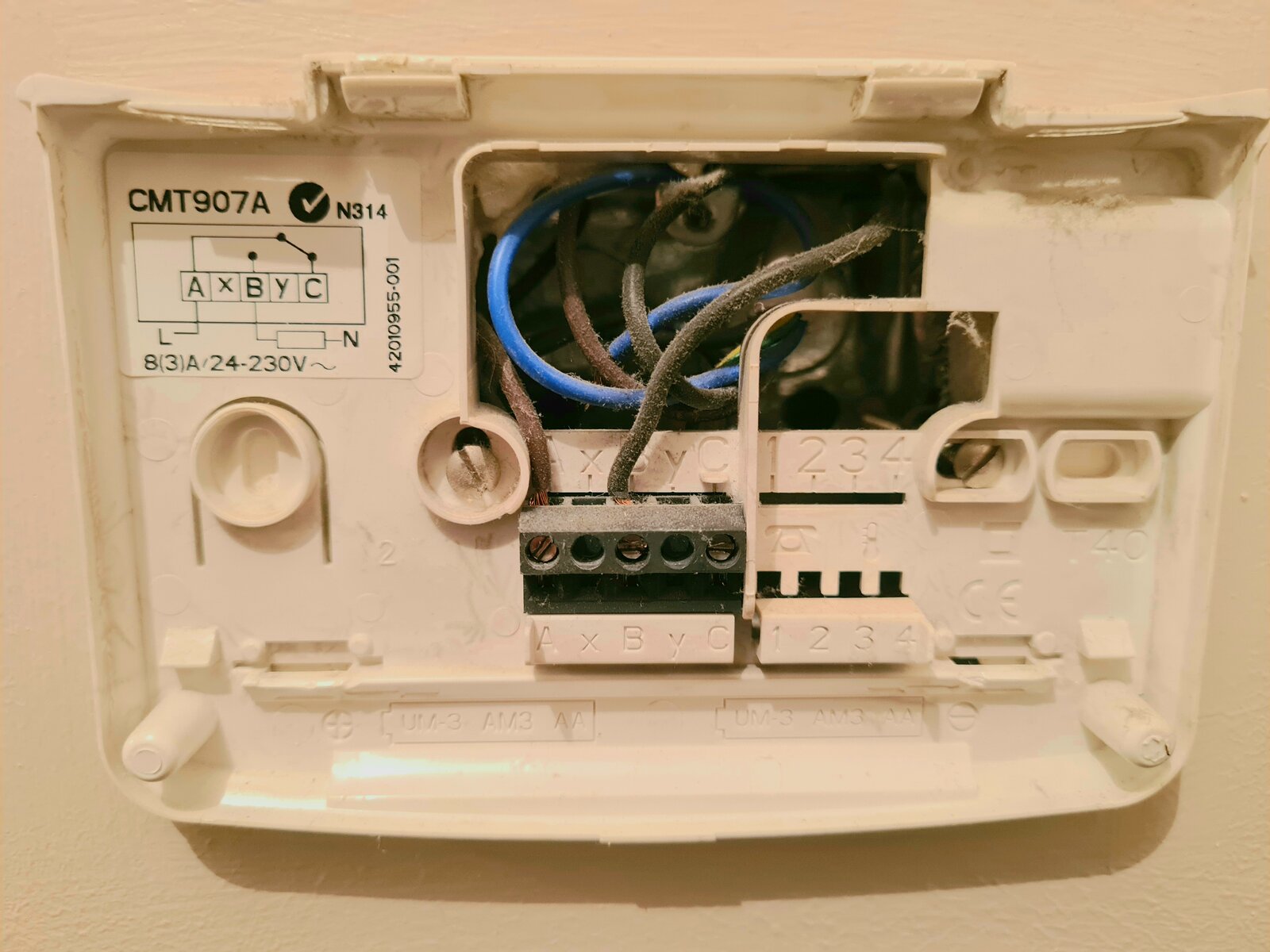

Hi,
I'm trying to figure out the easiest way to fit a smart thermostat.
I currently have a honeywell cmt907a backplate with cm907 thermostat on top which has two wires going into it... If I've looked at it right (photo attached).
A: live
B: switched live
Other wires available are a blue (neutral) currently unused and green/yellow earth.
I do not want to add any other wires such as a 230v live wire. The tado smart thermostat uses batteries I believe. Which wires would need to go where?
I have a Baxi Duo-Tec Combi 28HE boiler.
If any one has other suggestions for smart thermostats, feel free. Looking for something inexpensive I can control from my phone.

From what I have read it seems that it should be wired as follows:
A (live) goes to COM
B (switched live) goes to NO
Could someone confirm this is right?

Yes this would seem correct, based on information you’ve supplied.

You can use the wires if you simply want to use it as a thermostat, but you want to control it with your phone so you need the extension kit
There is a wired version of Tado for combi boilers that comprises a battery operated wired thermostat [so no wired bridge required] which would replace the Honeywell CM907. It comes with a separate internet bridge that provides the link to the internet. The internet bridge plugs into the router and is powered via a USB power supply.

Thanks! This is the version I went for deliberately to avoid needing wired power. Looks simple enough. Should arrive tomorrow :)

This is incorrect. If you look at the post from stem above, you'll see the wired version doesn't require wired power and does work just the same (minus hot water control) as the other including smart features. Your phone talks to the internet bridge which sends messages out to the thermostats.
