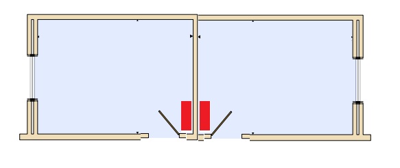

A dividing wall between two ground floor rooms is just one brick/block thick.
What would your thoughts be on placing one 47 kg radiator on either side of the same wall at the same point (different rooms) as indicated by the red coloured boxes on the schematic attached?

As sketched, the radiators will stop both doors opening fully, but I guess you could tolerate that, as long as you fit some sort of stops to prevent the doors crashing into the radiators.
