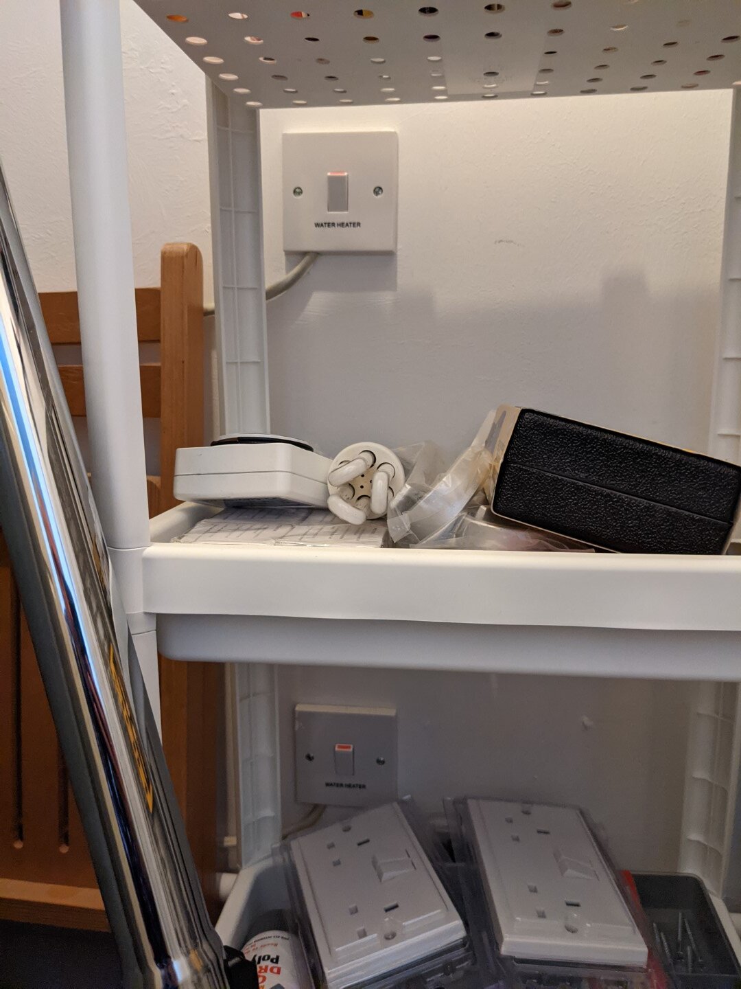

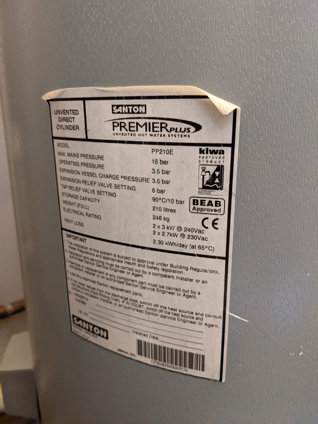

I live in a flat that has a Santon Premier Plus PP210E direct unvented cylinder.
I am trying to improve my electricity use and noticed that there were two switches (I think fused spurs?) for the hot water tank - neither are on a timer and both are permanently on. Is this usual recommended practice? Water usage is low (solo occupant, morning shower, occasional dishwasher or washing machine cycle, etc.).

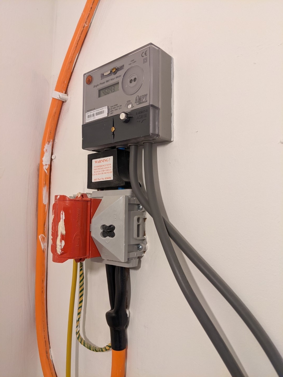

Previous posts mentioned Economy 7 supplies but I only have a single rate meter and there are no timers anywhere.

Photos as below:
You could turn the bottom immersion heater off and see whether just having the top one on gives you enough hot water. Won't make a massive difference as the cylinder is very well insulated but every little helps. Your heating will be a large part of your electricity usage I expect

Wow, that's quite a lash-up
LOL yeah the quality of building work was 'interesting' (had a few NHBC claims), hence why I was a bit unsure if they'd done the right thing when it came to no timers, etc. :)

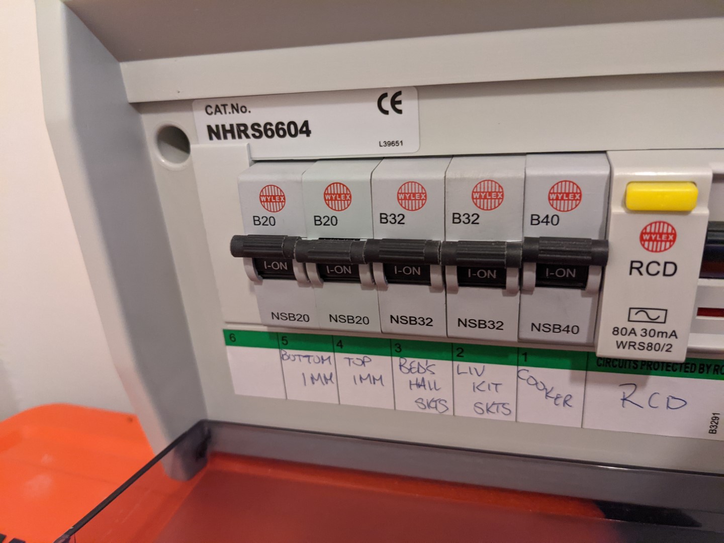

It's usual for the bottom element to be on overnight on cheap rate, and the top one to only be used in the day if extra hot water is required. Dual rate meter and either 2 consumer units or a split type with day/off peak sections.
In your installation it's a single rate meter and single consumer unit, probably done because it was cheaper to install that way.
