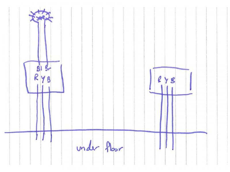

Next to my lounge door I have a switch. Other side of lounge I have another switch.
Before the plasterer came round and took off the switches off, theyworked fine as a on/off on off at both points.
Wires I can see (ignoring earths).
Switch 1 - Next to door - red (hot), yellow and blue coming up from the ground
Switch 2 - Next to window - red , yellow and blue coming up from the ground.
AND blue and brown going up to the light
Light - blue and brown
Switch 1 and 2 have the following -
Common, Load, L2 terminals
Can someone give me an idea of what I need to do to get these to work?
Thanks holmslaw, but this isnt the circuit I have...
The light is not on a loop.... The only hot/live wire is the red one which comes up from the ground into switch one.
See my rather poor drawing of what I have... switch one on the right...
Have you actually looked in the ceiling to verify that not only does the light fitting only have 2 conductors going to it but that they really are the same two that come from the switch, and that you haven't got a loop up there with a junction box?

anyway - yes def no loop up at the light. Wire runs straight from the LH switch up wall to the wall light light and no other wires to or from light
holmslaw and/or others...
ok - I did as you suggest but am now completely flumuxed....
I connected the RHS R-C, Y -L, and B-L2....
But!!!! at the LHS and using a Electric Screwdriver to check which ones were live... all three R,Y,B seem to be live.. no matter whether the switch is on or off...
In fact touching the terminals of the RHS with the screw driver they are all live when switch is on or off...

multi-metre - have one of those .... but without knowing which is the Neutral..... i wasn't sure how to check.... hence I just checked the light on the screw driver. Which came on for all three wires!
Those screwdrivers do not tell you anything useful, and can be a hazard. Around here we think the following should happen to them:
