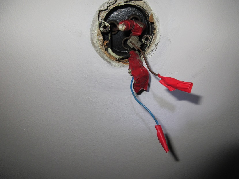

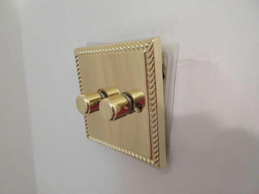

so there is a lounge with a central light and 2 wall lights.
all three lights are controlled independently by a 2 gang 2 way dimmer switch.
it is a loop in arrangement with 6 cores and no earth. Here is a photo:
these cables are being changed for new cabling as it is brittle and well past it's use by date, as well as lacking earth.
The wires you see are on a 6a MCB lacking RCD protection, that has been switched off and will remain off until a new installation is provided.
The new installation will likely run off a RCBO, or failing this a 6a MCB with indpendent RCD. This is understood to be within the regulations.
Would someone be kind enough to take the time to do a schematic of how these cables are likely to run illustrating each seperate core as clearly as possible, so that I can understand it better? If this is too much to ask, then fair enough and thanks for reading anyway.

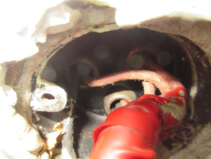

It looks like the loop is not there, so must be at the ceiling.

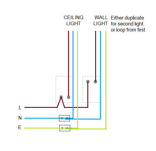

As you are having it rewired I would suggest running the supply to the switch.

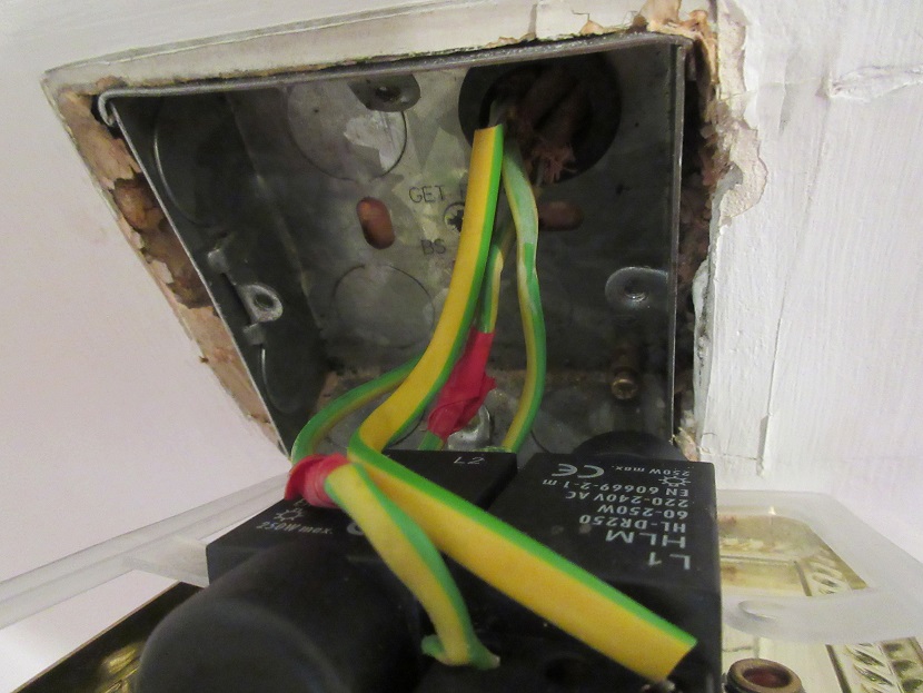

Efli has it right, when I've rewired and replumbed for that matter, I've tended to ignore what's there, remove it, and install fresh that I know is correct then it's less effort to get something working. What's there as you say is old and someone's had a laugh with earth sleeving in the second switch!
You can't have 2 way switching in the traditional sense with a dimmer (does it behave strangely at the moment?) involved so either change to standard switches or have one switch. You can either do eflis wiring or Google for: 2 way lighting circuit looped at switch. Or if you prefer you can loop at ceiling.
There are a multitude of sins in that switch wiring alone:
Earth sleeving used on live conductors
Metal switch plate not earthed
and probably others
You have some work to do to regularise that circuit, and probably the rest of the house if it is to the standard of the lighting circuit!
and probably others
A rewire might be your option.
Interesting comment - is that intended to be a general statement? If so, why do you think that many dimmers have COM, L1 and L2 (or however labelled) terminals?
