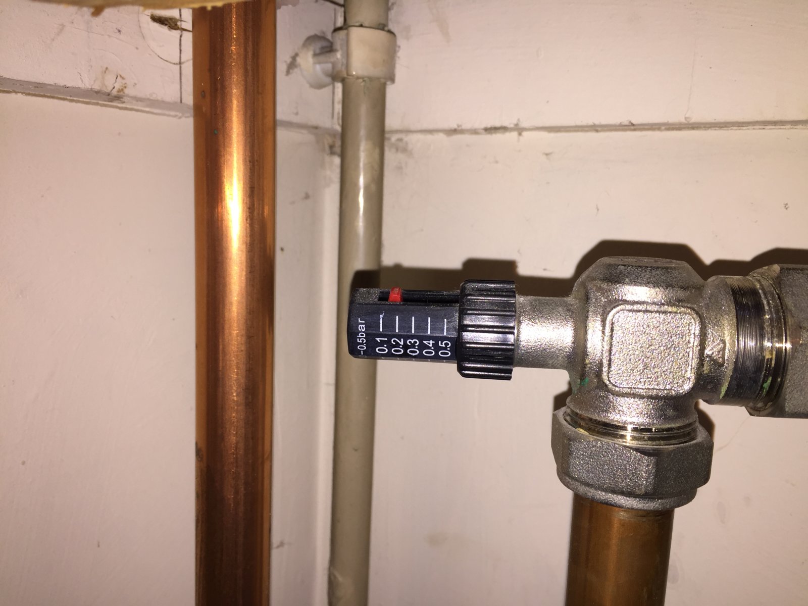

and look what I found installed in the airing cupboard tucked away under the shelf! any idea how to set it? when the plumber fitted it the system was drained so at best he would have guessed at the setting.
It looks to be installed in the correct direction. That said the output pipe is very hot all the way to where it joins the rest of the returns to the boiler suggesting it's allowing some water to bypass the 2 port valves even when one (for the UFH) is open.
Although the zone valve to the UFH is open, it could be that the blending valve is moved all the way to full re-circulate therefore there is no flow through the zone valve.
The auto by-pass ought to be sufficient (assuming that you have at least 4m of pipe between boiler & airing cupboard.
You can not turn that valve much further than it already is but take it to the limit (0.1).
If that still has not cured it, turn one of your towel rails to max and see if that does the job.
