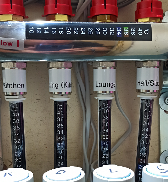

I have had a similar challenge to you, so here are some top tips of things I literally last changed/adjusted in Sept:
1. Boiler is Vaillant Ecotec Combi. Despite what is said here AND all the Vaillant documentation, it just doesn't work when you set target temp for Return (as opposed to flow).
2. If boiler LCD temp display flickers between different temps, it's not showing flow/return temps alternatively, the PCB is on the blink. There is an easy fix - look on Youtube (I got into trouble posting it here..). This is important, because it means that the boiler is mis-interpreting the flow temp, so shuts off and goes anti-cycling before you get sufficient hot flow running through that manifold.
3. I replaced the manifold pump with a DAB EVOSTA 3 60/130
4. I replaced the flow regulators with these: https://www.aliexpress.com/item/1005006200371906.html (you can take them off, unscrew the glass tops and clean them out - but given that they are cheap as chips - not really much point).
5. I replaced thermal actuators that weren't working with these https://www.aliexpress.com/item/1005006259715861.html (make sure you get 230V versions and NC (normally closed) if that's the way yours work). [And before anyone shouts about cheap Chinese stuff, mine were EXACTLY the same as the John Guest actuators I removed - except they didn't say "John Guest" on them obvs..
6. I then got some Terrarium Liquid Crystal temp displays (the sort of things you stick on ill kids foreheads) so that I could visually monitor flow and return temps (IR Thermometers don't work that well on copper or PEX pipe).
I have a mixture of floor surfaces served by the UFH - engineered wood, sitting on aluminium spreaders, Limestone tile on Aluminium spreaders and Limestone on solid screed. I set the CH flow to max 60C at the boiler. This results in an average flow temp at the manifold (I just set the adjustable injection therm to MAX) of around 46C. By the time the water is coming out the other end (back to the UFH) it's less than 40C and all told (I have a normal rad circuit upstairs) boiler return flow is in the low 40's (so I get max condensing to boot).
Surface floor temps on limestone/solid screed max out at 24C and just a tad higher for the other surfaces. Everything is fine and nothing delaminates at that temp etc. One final note: because the entire groundfloor of my house is UFH (4 zones) I run this 24/7 with a Vaillant V-Smart (which actually, is about as smart as a box of frogs - but that's another story) with target temps of 17C from 23:00 - 07:00, 19C from 07:00 - 18:00 and 20C from 18:00 to 23:00. In that way, the entire house fabric and contents kind of retains and releases heat, and I don't get that massive temp cycling with down drafts from cold walls and ceilings etc. I have also experimented over successive winters, and I can't tell the gas usage difference between 24hr heating and just coming on when we need it. The only difference is, it now feels cozy all the time and I am averaging a £36 a week gas bill - which includes standing charges and gas for cooking etc. Based on current usage, todays Octopus bill is estimating a yearly gas bill of around £800 - but I have no idea if that's good or bad.

Thanks, thats some great feedback! I have come a little further with this, I bought a temp monitor with a clamp for flow/return, and it shows that the manifold temp is around 42 degrees, when the mixer shows 50, so may be previously the water going in wasn't as hot as I thought. Great idea on the stick on thermometers, going to do that now...!
Also have worked out that some loops weren't labelled properly, so when we thought we were heating one room, it was doing the hall...how we didnt notice I have no idea, but that seems to be fixed now by moving some heads around.
As I still cant see the flow properly, I have just recieved replacement actuators (went for the salus self balancing) to see if they help at all, as everything else seems pretty good, I have also been playing with the thermostat settings...if I can get to anywhere near your gas bill I will be delighted, as our last one was £1800 for 3 months :(

I just turned the mixer up to max, and control the flow temp at the boiler. In that way, I can dial it down to 60C max, which is how I get the above manifold temps.
In any case, are you sure your mixer is, well, properly mixing?
Just to be on the safe side, I bought a service kit: https://www.johnguest.com/gb/en/pro...il-2014/jg-underfloor-service-kit-jg/control2 after discovering that the innards had broken up when I took it apart. It worked a lot better after that, obviously..
