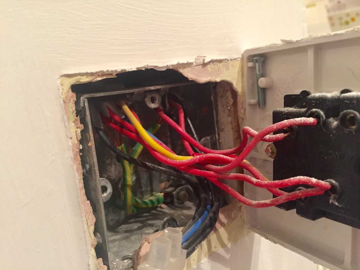

Hi everyone
Just fitted out the utility and while the walls still need painting thought I'd try and wire in under counter lights.
But sadly the wiring has confused me
(Yes I should get a electrician in but I have wired in lights sockets before just never done something like this, I think I know the answer but just want someone to confirm details)
So currently my light switch controls the lights in the utility ceiling light and feeds power out to the conservatory and a outside light, the switch has 2 toggles on it.
I have attached a picture
I want that switch to have 3 toggles that control 3 separate light just unsure what to buy or how to wire it?
Any help

Okay, so if you can get another wire down to the switch, then you would loop a live feed across to the com on the third switch, and fit the lswitched live to L1 on the switch, add the neutral to the connector block, and the CPC it the earth lug. You'd feed the cable donw behind the units, and then connect it to whatever lights you use under the units. You can go fos small linked flourecents, or LED using a driver, or even led strip lights that use a driver. You'll link the driver into the feed wire using a choc box.
In the switch box you will find feeds connected to the Common terminal and neutrals in a connector block.
You need to replace the switch keeping all the existing connections to two of the switches and then for the third:
Loop a feed across to the new switch common and wire the red/ brown of your new cable feeding the under-cupboard lights into L1 of the corresponding switch. The cpc (earth) goes to the earth terminal and the neutral to the neutral connector block.
Feed this cable down the existing capping where the other cables are (if possible). If not, you'll have to cut a chase (avoiding the others), making sure it is not outside the box width (ie in safe zones).
The other end goes into the loft space and down again to the lights. But making this cable in a safe zone may be problematic.
To understand safe zones, look them up here in the Wiki.

Under-cabinet lighting. The exact type of lighting doesn't really affect the switch and wiring from it. The same switch can turn on and off fluorescent lights, LED pucks, LED strips, whatever you want. The only exceptions might be if you want something like remote control dimming and switching where you might bypass the wall switch completely, but you did say you wanted to control the lights from a three-gang wall switch. Still best to decide on the lights first since you might want to tuck LED drivers away somewhere other than right under your cabinets, and then you'd need to run the mains wiring to there.
