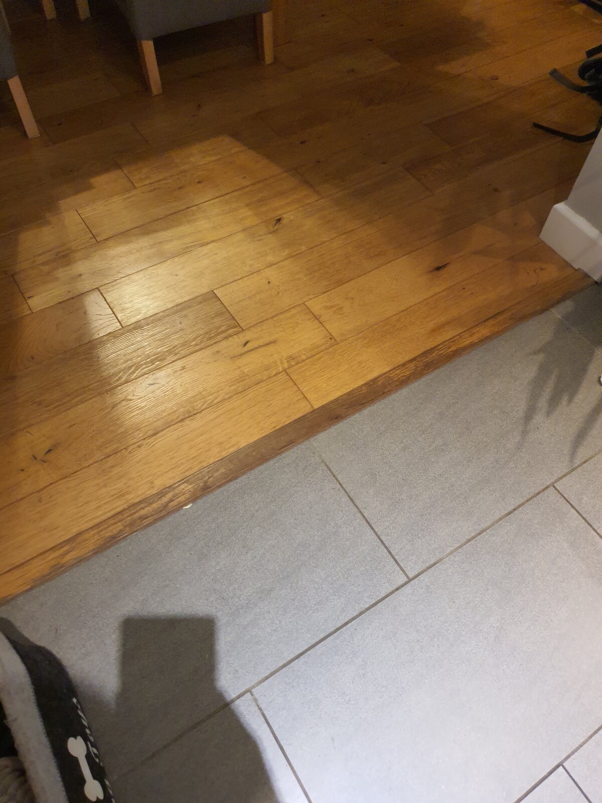

As for insulation, I'm not convinced there is any. It's very hard to say what's under there. All I know is I had to lift some floorboards under the stairs once (no UFH there), and there were just floorboards and a void/crawl space under the house. I thought it wasn't great, but it wasn't until I spoke to a friend who was having an extension and UFH fitting and he told me about the masses of insulation boards going in :cry:.
The house is detached, open plan and has quite a few windows and doors. We also have two solid walls, which I'm hoping to get external wall insulation fitted in the next couple of years. So, definitely not the warmest house on the street.
Fortunately, we do have a log burner which does help out downstairs.
I've attached an image of my downstairs flooring, tiled kitchen and hallway, and engineered wood flooring. As you can see, it's very difficult to tell what's underneath. I've spent a fair amount of time wondering how I could insulate under the floor, but it's kind of difficult now.

If you've got wet UFH and engineered wood or tile, plus you know that the house has a suspended timber floor then the long response time could be because the UFH has been fitted into grooved cement boards on top of the original floorboards (or on top of some skinny insulated boards on top of the original floorboards..) and then engineered wood on top. Absent any insulation under the UFH pipes, more than half the heat will disappear into the void beneath them.. The more insulation the better, but low amounts (10 to 40mm as one typically sees with under-tile boards) aren't going to work well
If you can fit into the void, you can insulate it, though it might not be the most pleasant job.. I've always wondered whether, if I had that floor construction, I'd take the easy route of using a blower to completely fill the under-house void with EPS beads..

I would have expected your overlay boards to be insulated? if they aren't, then heat will be leaching away and you'll need to address this at some point. If you can get under the suspended floor, fitting PIR tight to the underside of the floorboards should help, or rock wool.

I thought those cement boards might be in use, but I can't prove anything until I get some access. This might be some time as I don't fancy wrecking the wooden floor. I may have another nose under the stairs when I get the time and see if I can figure out what's going on under the floor.
I'm quite tempted to just rip it all up one day and replace the wood and tiled floor as they aren't the nicest tiles and it's stressing me out to think of all that heat/money I'm potentially leaking into the ground. If I did remove the current floor coverings and exposed the joists, would it be a case of just pushing Celotex in between the joist? Is this sufficient?
