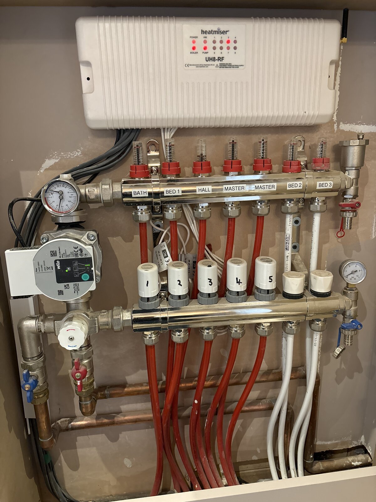

Underfloor heating problem
So, with both on the D/stairs heats up but on D/stairs only the flows are as was but no heat which IMO means boiler can't be running?
With just turning on any room down stairs with upstairs off, the manifold and pump kick in also the boiler but it never draws warm water through the pipes.
The boiler on but I don’t think any steams coming out of the flue
If the D/stairs is circulating water but if there isn't a temperature difference dT between the top manifold where you have a temperature/pressure gauge and the bottom, return manifold then the boiler "cant" run as there is no heat demand, what temperature is this .gauge showing with d/stairs running on its own vs with both running?

Its possible, if unlikely that the flow/return pipes are incorrectly installed in the d/stairs UFH, what is its mixing (TMV) valve set to and with both systems on what is the indicated temperature (on the combined temperature/pressure) gauge and does the return (bottom manifold) feel substantially cooler than the top manifold?.
Yes bottom bar feels a lot cooler than the top one.

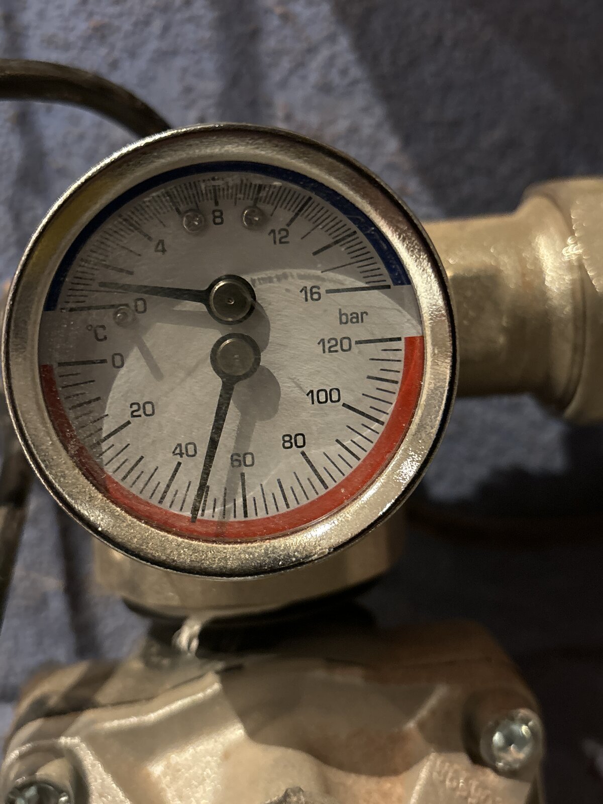

It’s a gas boiler alpha. Readings picture with upstairs off !
The warm water pipe just goes completely cold within a few mins of shutting everything off upstairs and the temp just keeps droppping on the dial.

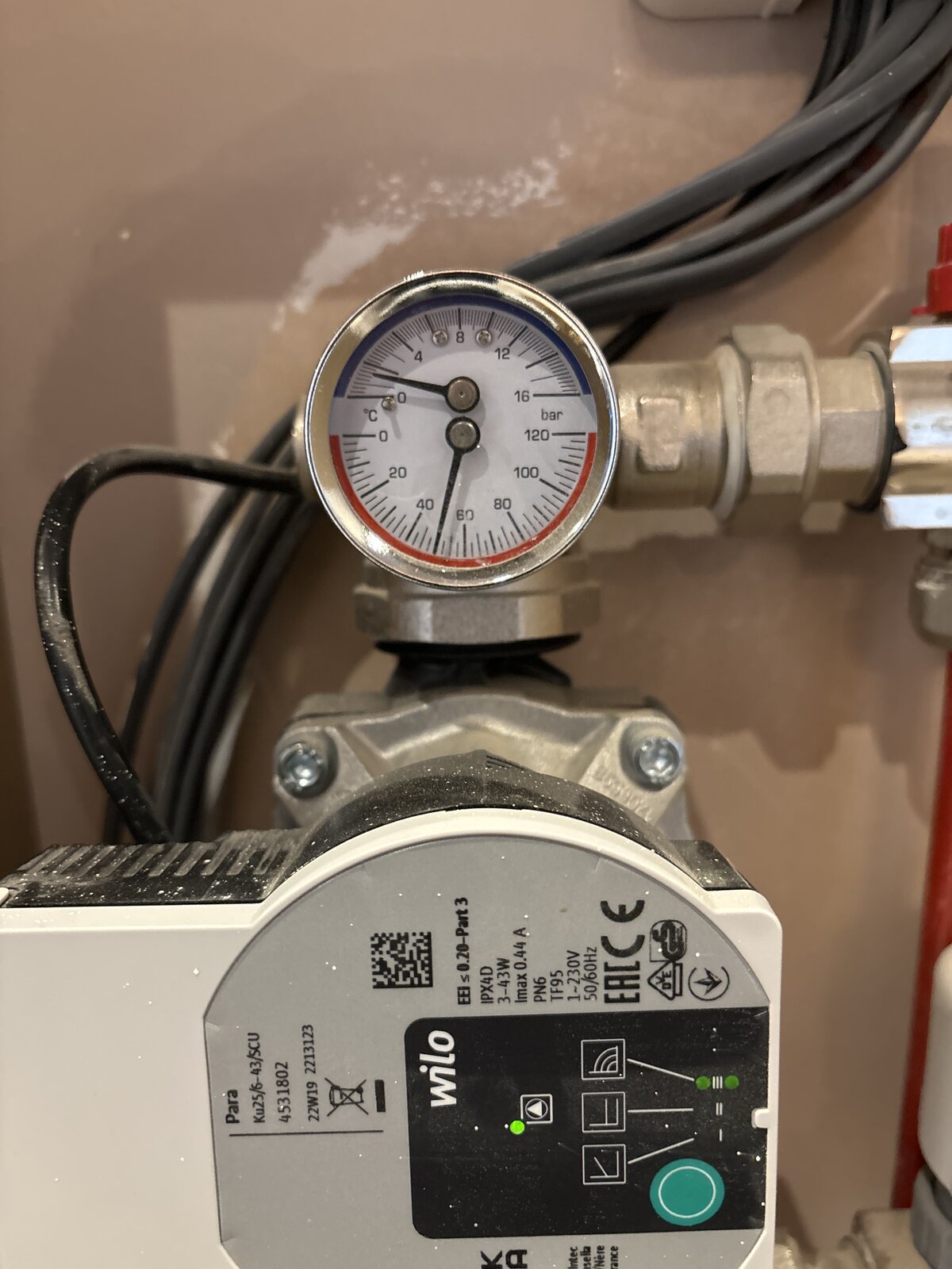

You are saying the d/stairs goes completely cold??? when u/stairs shut down. If so take a set of readings off the u/stairs with both on and a set with the d/stairs off, U/stairs on only. I want to see the U/stairs UFH demand when running on its own particularly (and also with both u/stairs & D/stairs on).
Yes when the upstairs his turned off and downstairs his left running. Running just upstairs with landing on

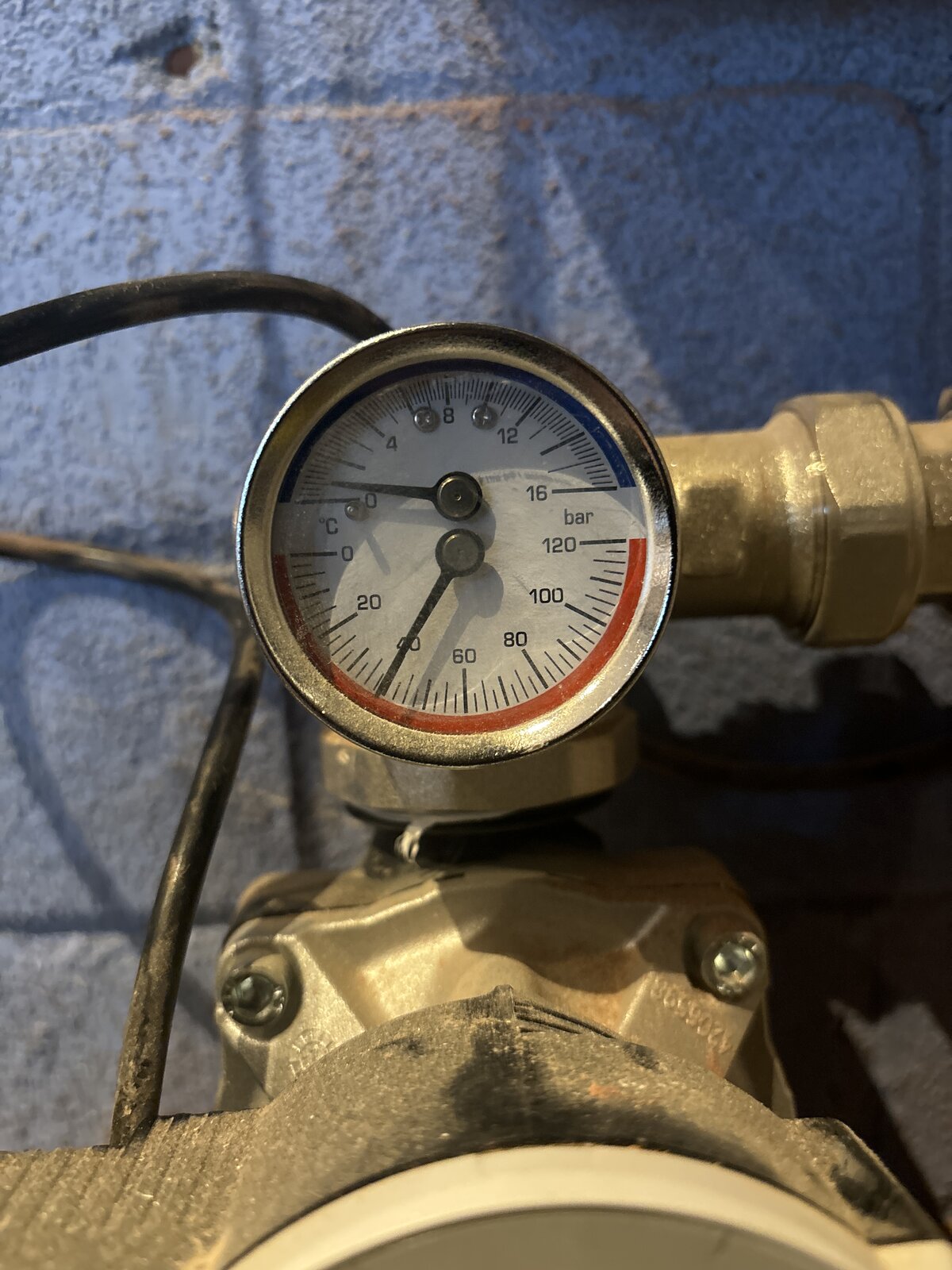

So, just to be clear in my own mind, the U/stairs will run on its own, is that correct?.
If so can you take two sets of readings as requested
I am trying to see if the u/stairs heat demand is the same or more (when running on its own) than the d/stairs
