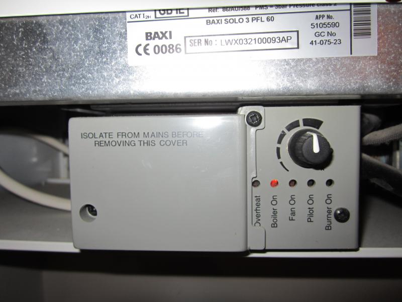

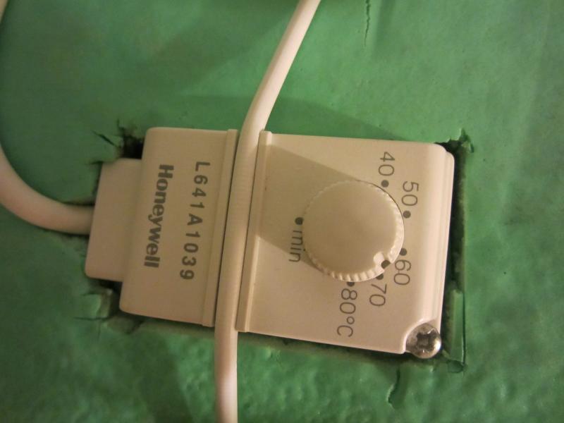

Secondly, I "think" I have heard that the water from the boiler should be set to 65 degrees. Now, is this the water temperature on the side of the cylinder in the airing cupboard (Photo below).
Or do I set this physically on the boiler? (Photo below)

Might be able to help with some items for you. The cylinder thermostat is to control the temperature of the stored hot water supply to the kitchen / bathroom taps. It's nothing to do with the underfloor heating.
The boiler thermostat is where you set the temperature of the hot water leaving the boiler. However, there likely will also be a thermostatic mixing valve near the pump / manifold that controls the temperature of the water in the underfloor section. Underfloor heating does operates at lower temperatures than radiators, as it has a larger surface to emit the heat from and I guess so that you don't burn your feet.
Condensing boilers are generally stated as operating more efficiently with low return temperatures, but yours looks like an old non condensing Baxi Solo. The Solo has a thermostat that maintains the water leaving the boiler at the temperature set by the small knob, so it turns the gas on and off as required. If it kept running permanently the water would boil. The switching on and off you describe sounds perfectly normal.

Cylinderstat should be at 55-60 and boiler 60-65 C
