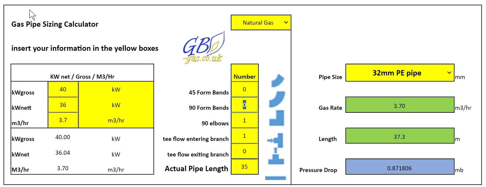

A few years ago I relocated the gas meter away from the house. I then dug a trench and buried a yellow gas pipe MDPE 32mm, that would run from the gas meter to the house.
The heating engineer who visited to connect the services took a look at the emerging pipe and said it is not right and I need a "trackt" pipe or something similar.
She also mentioned that the gas meter may be too small to handle two boilers and the gas pressure may drop a lot due to the large distances involved.
Could anyone please advise me, do we know the pressure at my new meter location? Is it recorded anywhere? Why is my yellow gas pipe not suitable so that the engineer is refusing to use it?

Old system - underground pipe to gas meter, about 70-80 meters. Gas meter to boiler about 20 meters iron pipe. Two more outlets for gas fire and gas hob.
New system - underground pipe to gas meter, about 30 meters. Gas meter to boiler about 33 meters MDPE 32mm pipe. No boiler installed yet.
1. Yellow MDPE is not allowed above ground. All pipe above ground must be metal.
2. She is referring to Tracpipe which is a corrugated stainless steel, flexible, pipe. Presumably you could all use copper or steel.
3. The pressure FROM the meter into the gas carcase is regulated. Around 21 mbar plus or minus 2 mbar (from memory)
1 and 2 : So all I have to do is connect a copper pipe to my underground yellow gas pipe and all is good?
3: Are you saying that regardless of the mains gas pressure, once it goes past the meter it drops to 21 mbar?
21 mb as it leaves the meter, so depending o length of run you loose pressure , so how far is it and what size boilers
So find out boiler size then using online pipe sizing chart you will find the answer ,only 1 mb drop is the rule
OK, I have done some reading, it seems for the length of 33m MDPE 32mm I can accommodate about 40kW.
This is OK for a 30kW gas boiler which was my intention.
If I wanted more appliances, would I be able to ask for the gas meter to provide two separate outputs each with its own 21mbar pressure?
