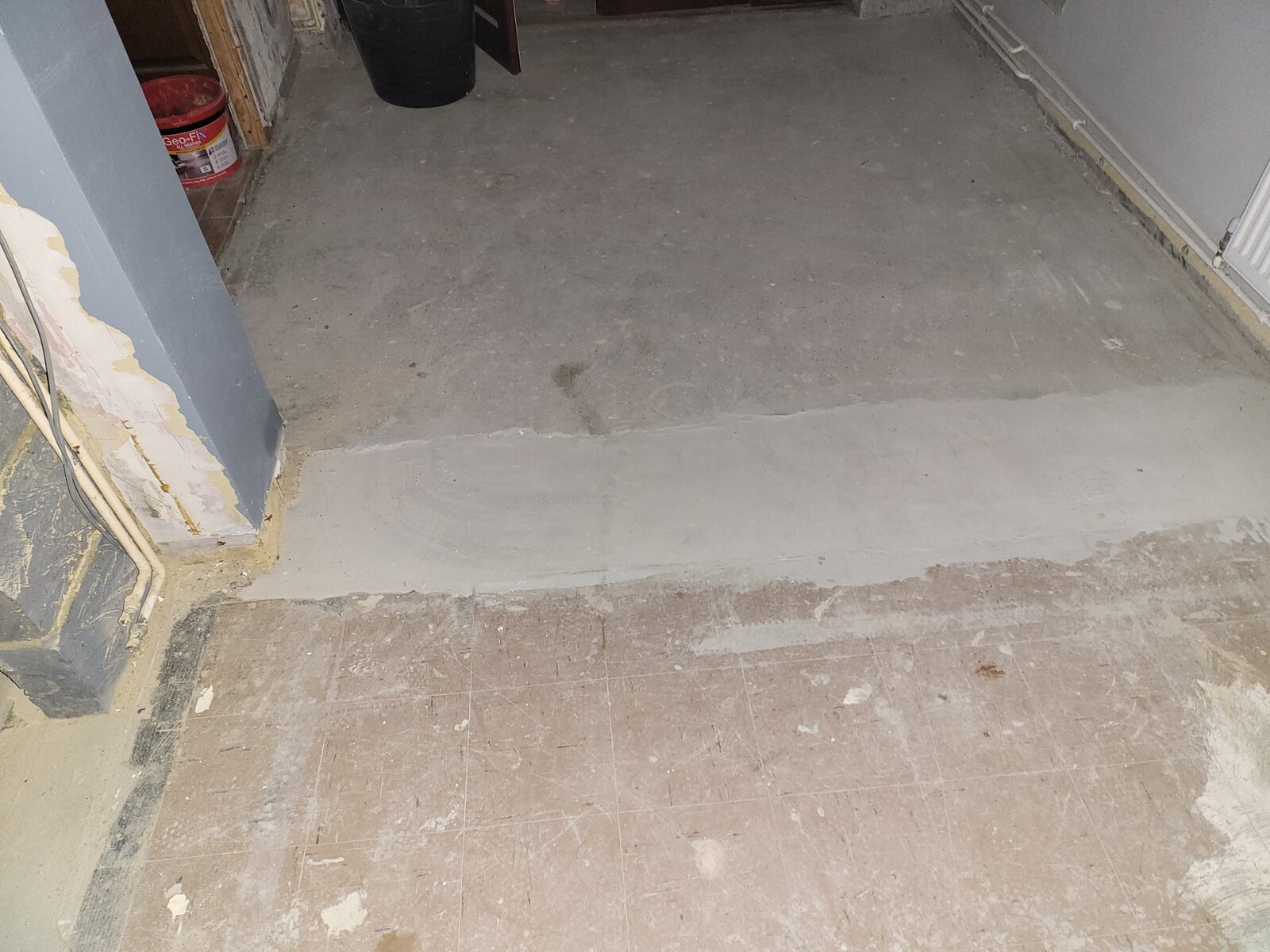

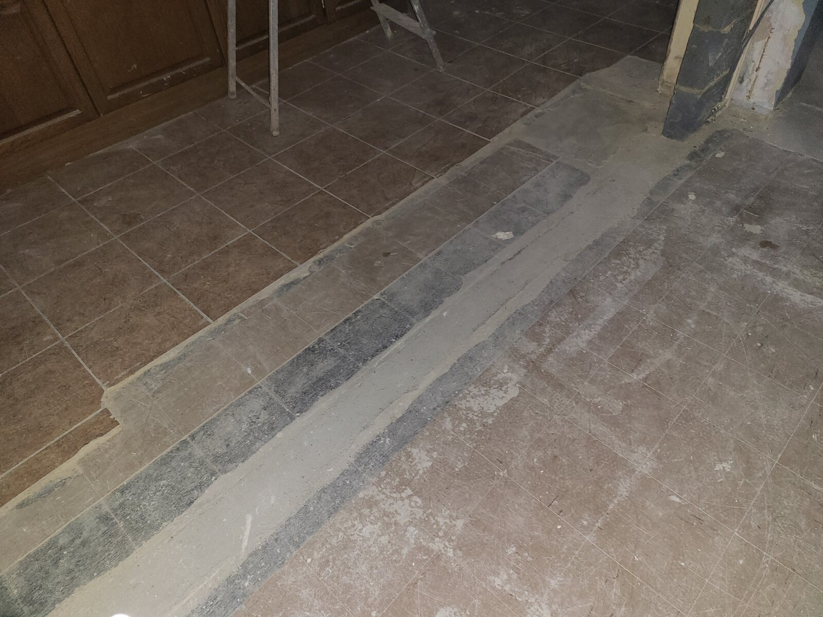

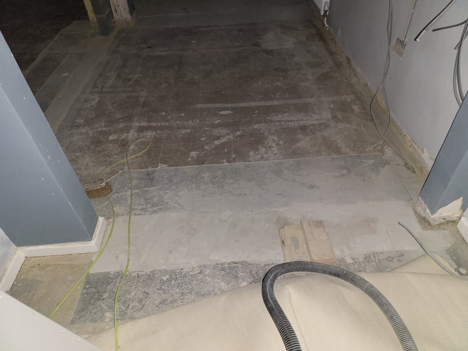

Hello, before installing LVT I need to even out the concrete floor but it's difficult how I should proceed..
Should I use self levelling compound or concrete + sand??
Thank you
The first picture - 2 to 4mm gap between lounge and dining room
The second picture - 8 to 12 mm gap between kitchen and dining room
The third picture - 5 to 8mm di
fference
If having LVT you need to remove all the vinyl tiles. ( wet tiles , gloves and double bag them.
then you test for moisture. Does the conc have a sheet damp proof membrane, you should see it around the perimeter if you have one. Then you want a smoothing compound ( self leveller )
Underneath concrete I found some plastic things, seems like a damp proof membrane.
So the tiles off and then self leveller is the only option??
