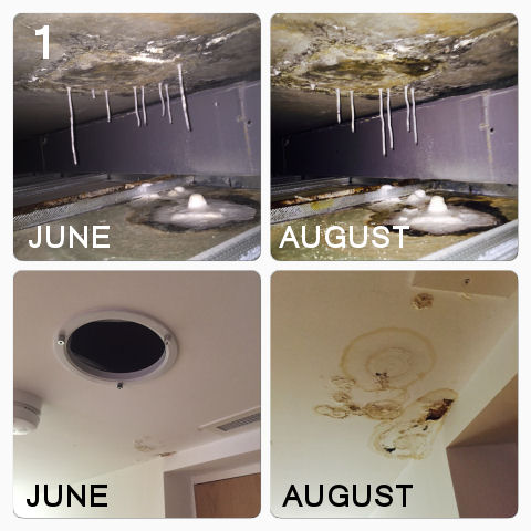

However, back in June the owner of an apartment on the 2nd floor that is close but not beneath the penthouse also complained of a damp patch in his flat. I looked at it and took some photos.
Photo 1 shows the damage in the apartment back in June and now. By removing a light fitting I could see how the water was dripping down from the concrete roof above, causing the stalactites. This was obviously an old and slow leak. It is currently dripping enough to leave about 200ml a day!
Back in June I told him that we knew what the poblem was. It was the leaking shower and that it was being taken care of.
However, several weeks later he complained the damp was getting worse and when I examined the roof was still dripping and still is.
FIRST QUESTION: Could this still be water from the shower that leaked over 2 months ago? Could enough water be trapped up there that it is still soaking through the concrete and dripping down or would you expect it to have all dried out by now? If it is that water still, how long may this go on for and how could we speed up the process. Im assuming the concrete is very thick.

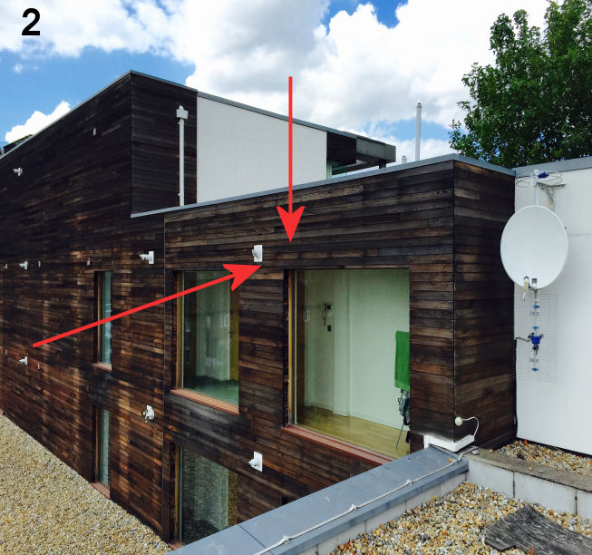

Photo 2 shows where the leak is from the rear of the building.

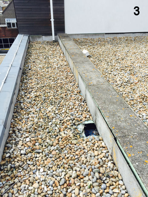

Photo 3 shows the flat roof above. There was no obvious signs of a problem but the flat room is covered by several inches of insulation and then the pebbles.
The drain in the middle was full of stones so I cleared those but I don't imagine that would be the problem, as surely the water should have still drained through easily enough.

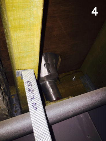

By removing another light in the corridor I could see where that drain enetered the building. Photo 4 shows that and shows how there's no signs of water on the outside of that pipe.

I'm guessing but the leak from the slab seems to be ongoing - not residue finally drying out.
Its not seeping thro the concrete its coming thro the joins in the slab pour - and perhaps there's a slab repair patch just there?
Are any pipes buried or channeled in the slab?
You could remove some panels and clean up the stained soffit of the slab, and leaving the panels out wait and watch?

A gulley guard(s) would help on the roof gullies.
Where do the roof gulley downpipes finally discharge?

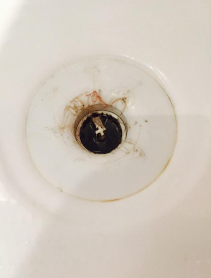

heres a photo of the hole in the shower tray. The outer circle unscrews and beneathe that was a seal stopping any water going anywhere other than down the pipe. the seal was replaced by a plumber and then some sealant applied before the plastic ring was screwed back on. Its a porcelenosa shower tray. The shower wasnt used for several weeks whilst they waited for the new seal yet the dripping continued. I dont know if theres two layers of concrete but just thought there might be. We poured lots of dyed water through that shower tray last night but none has appeared so far.

So the shower drain was repaired from above thro the hole in the tray? Originally, whose idea was it to hit on the shower drain as the leak suspect?
