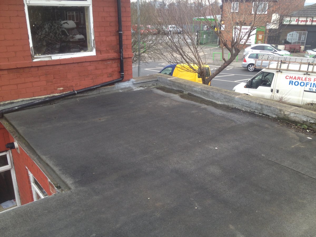

I have a leak on my flat roof. It doesn't seem to be on the roof itself, but the way water is running off and down the wall. So we are getting a leak around the window area in the kitchen. I don't have a photo of the roof holding the water, but it seems it is holding a lot of water over this edge of the building (not running away to the other side where the gutter is).
Her are some photos to help show what i mean.
Any ideas ? It may be a case of taking everything up and putting a better slope on the roof.

Those are parapet capping stones. Are you saying that your flat roof is at the height of those stones? If it is, that's your problem.
No the roof is lower down. They are 20-30cm above the level of the roof. But the water is holding next to these edging stones and i think coming in to the kitchen somehow, under these stones.
You can't have 300mm of standing water on a flat roof, so that it overflows over a raised parapet.
The water is only mm's deep because on the other side is a gutter and so i imagine the roof must drain off to that dose, but it is holding water around this parapet edge. I will try get a photo to show what is happening.
just a photo of the roof from the inside of the parapet will do
This is the roof. The roof is completely flat as had my level on it today. The section which collects water has a fall into that area, so away from the gutter side :(
I think i am just going to redo the whole roof in fibreglass and do it myself. Had a roofer have a look today as he was outside having a coffee and he said he could rejig the holding water section for about £200, but i reckon i can redo it all in fibreglass for about £800 (23 sq/m). If i don't need to buy new ply wood i can save about £200. So maybe £600

Your first post on saturday had the right idea to "take everything up and put in a better roof slope". You should also lift and do away with the parapet. You should then repair all damage and construct a warm roof to falls. At the moment you seem to have penetrating water going into the roof and the parapet walls which could mean possibilities of wood decay and electrical danger.
There can be no short cuts with roofing and the idea that a quick patching and repair fix that will give the roof local falls and can be made for £200 is make believe.
By the way, the rotting bedroom window frame has fillets of crumbling sand and cement used as caulking.

If you are going to replace then do as Vinn says strip the whole lot back to the rafters, ditch the parapet. run firring pieces along the rafters to create a fall then ply and a VCL, then insulate above to create a warm roof no need to ventilate. Fit fascia along the wall where the parapet was with an arris rail curb or fibre glass profiles if you prefer.
