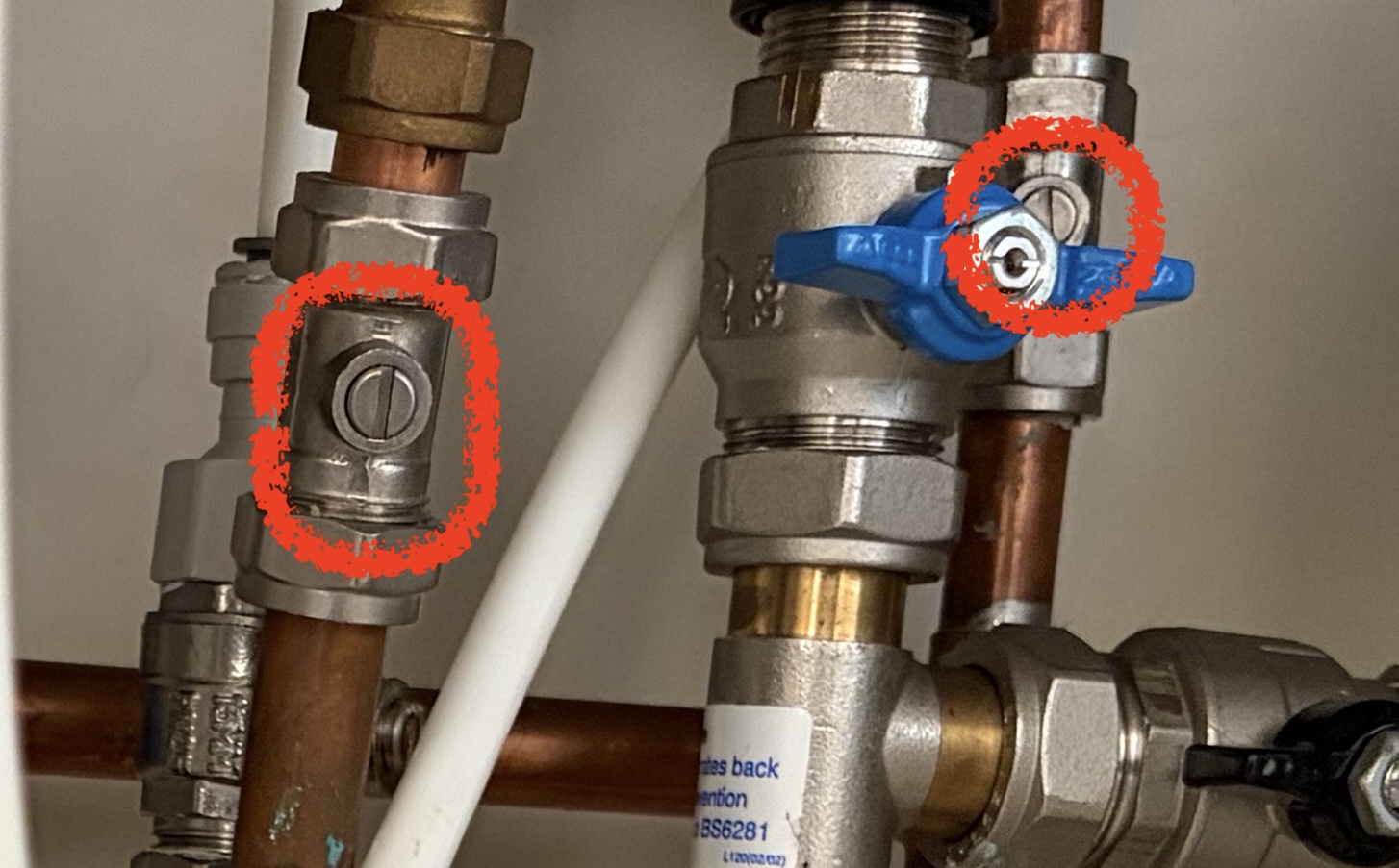

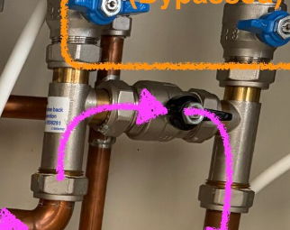

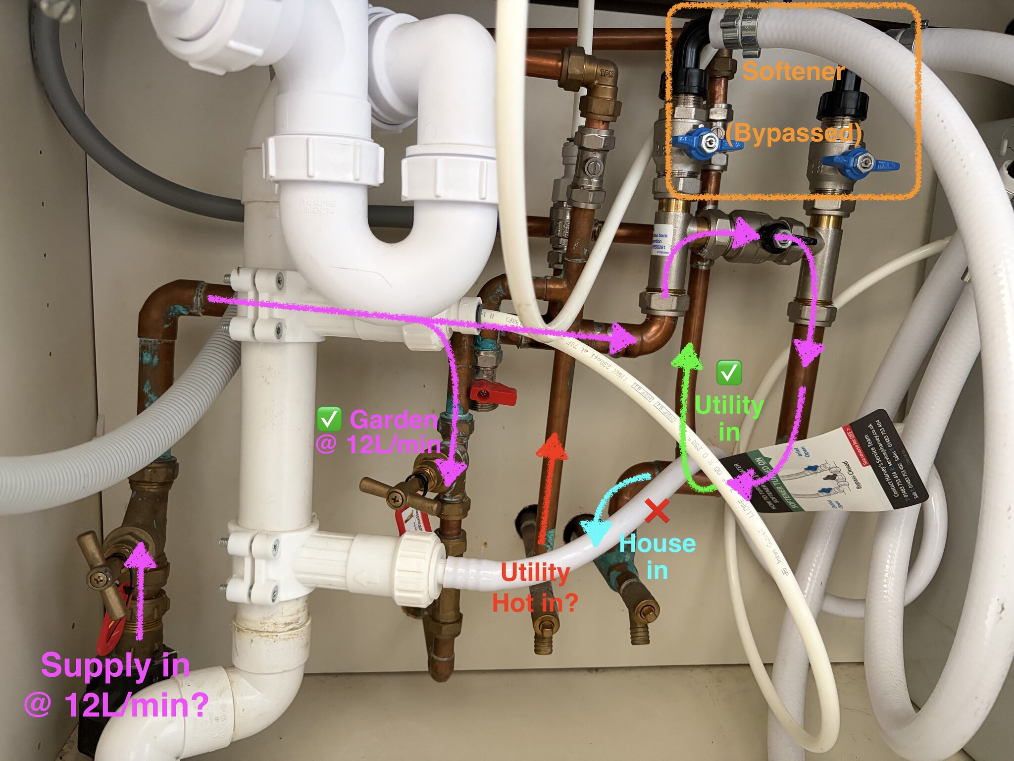

Here's my lovingly-detailed diagram of the utility room under-sink where the action is:
- Pink: supply comes in stopcock (yes, fully open!). This then goes directly to the garden tap. This is fairly powerful at about 12L/min. This then feeds through the water softener value, which is bypassed in this image (and makes no significant difference to the problem)
- Green: after the softener valve, this goes to the utility room sink above. I measured the main tap cold here at also about 12L/min and this is the only cold tap in the house with solid pressure.
- The sink also has a smaller drinking water tap which I measure at about 5L/min, but I think that's just due to the tiny flexible pipe which feeds. For filling up a glass, the pressure here is also good, so I don't think this is a relevant point
- Blue: after this leads into the main house supply (as far as I understand). It's after this that the problems start
- Red: pretty sure this is the hot water feed from the tank upstairs. Also poor pressure, but this is far from the source of the problem
Other pressure measurements:
- There's a downstairs toilet on the same level that delivers a pitiful 3L/min
- The kitchen which is more or less directly above gets about 7L/min. Strange that this is more than the toilet downstairs!
- The problem is most pronounced for the showers on the 2nd floor. You can't, for example, use any taps while someone is showering
The last engineer to come in did the best job of "debugging" the problem:
- From his opinion, the set up is modern and ought to be delivering good pressure upstairs
- It's pretty clear that the problem starts after the blue section. This explains why the utility room and outside taps are decent and everything else is not
- Cold water supply appears the source of the problem (from within the house)
- It's possible to get momentarily solid pressure in the upstairs showers if they've been unused for a few hours. You can get about 5 seconds of decent pressure before it decays to mediocre pressure. Sometimes it's just a dribble.
