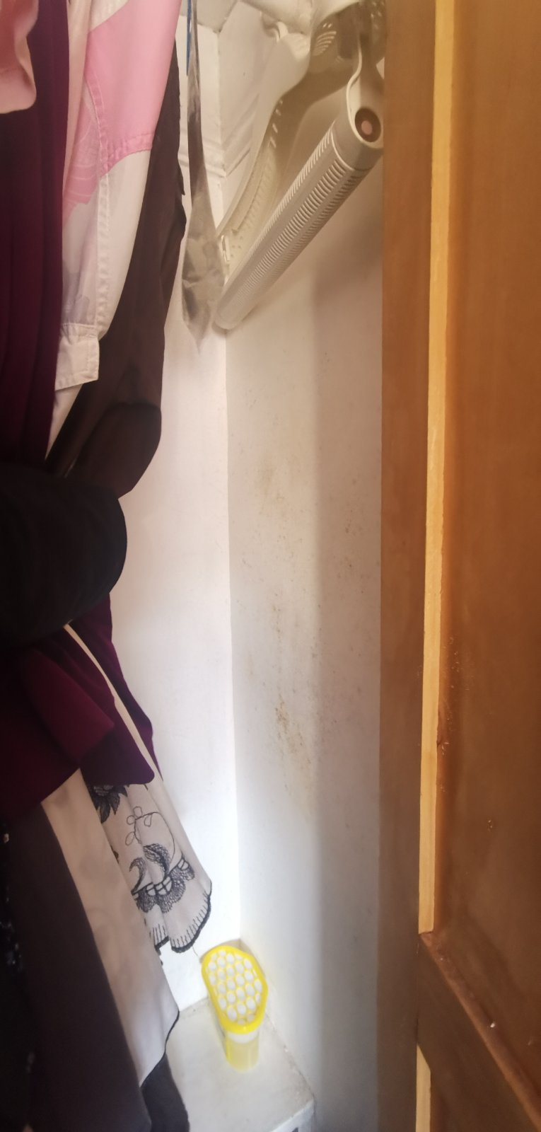

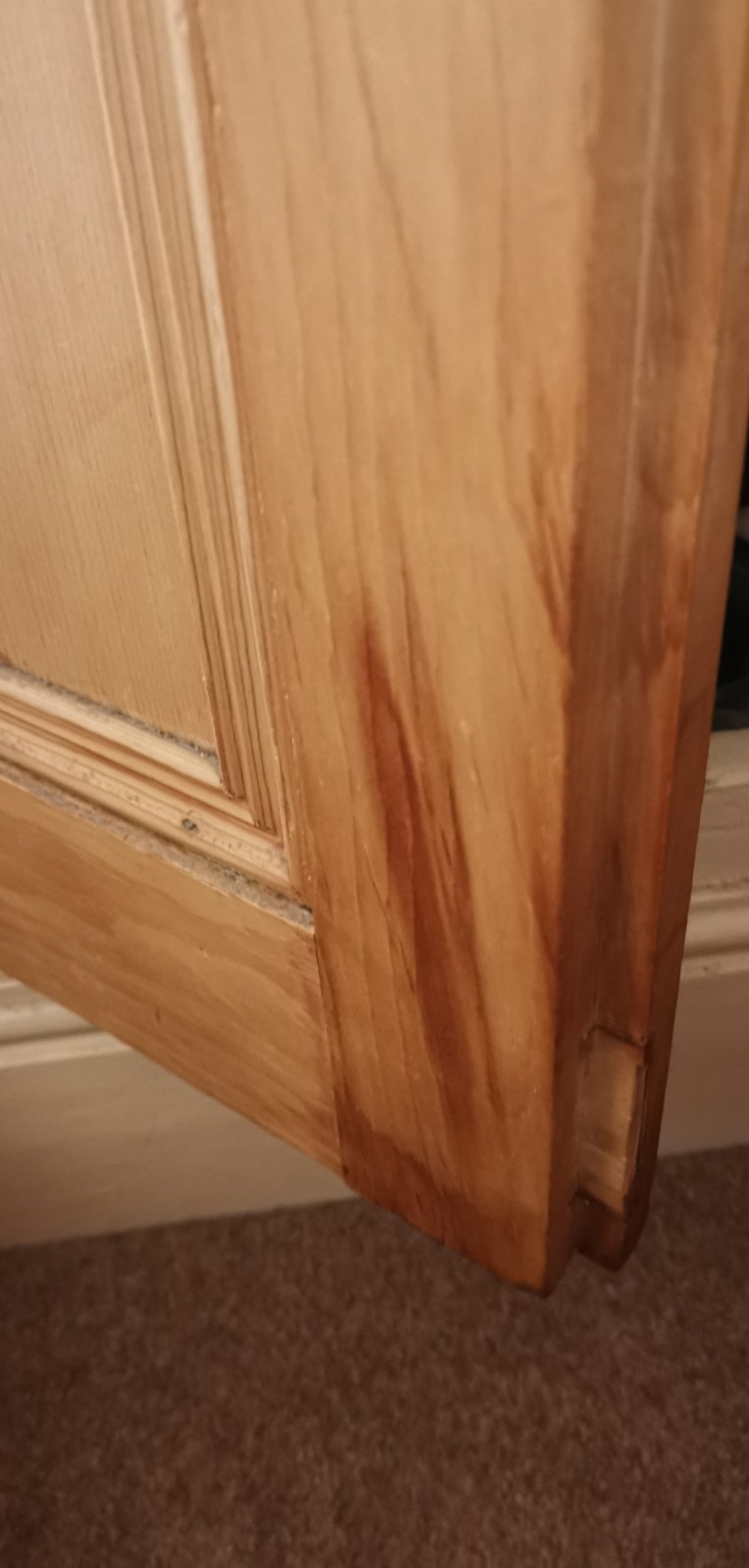

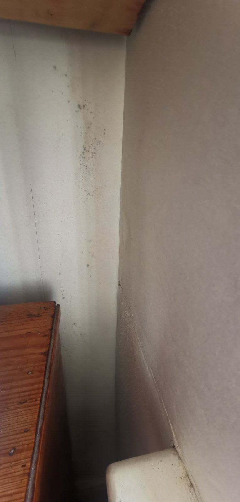

Well, despite using THERMAL paste with INSULATED wallpaper, various mini dehumidifiers including a special Lakeland coat hanger that catches water in crystals, opening the bedroom window in the day slightly and having an electric dehumidifier and air filter that has some airflow this mold persists! I cannot understand when doing all the right things why this is happening as it defied physics. The house is Victorian with no cavity but this shouldn't be an issue as other rooms in the house I have treated have been ok up to now. Would a second layer of the insulated paper be enough to stop this, and it would get rid of the forming mold as the paste is meant to kill it on contact ? Otherwise its a pain in the backside. We don't have the central heating on (can't afford it) except 5 mins here and there as we have a log burner. Even the wooden doors to this cupboard we had stripped of paint 26 years ago still attract moisture! I even sprayed one of the walls with mold blocker which hasn't prevented it coming back.

Mould is from condensation.
Drying washing without a dehumidifier or no extraction when showering or cooking all cause condensation.
You have to reduce the moisture you create.

Your wall is saturated and cold which creates condensation mould. Insulated wall paper won’t make a difference. Build a stud wall/ walls and create a gap so cold and damp isn’t transferred from the walls. Keep the room warm thereafter

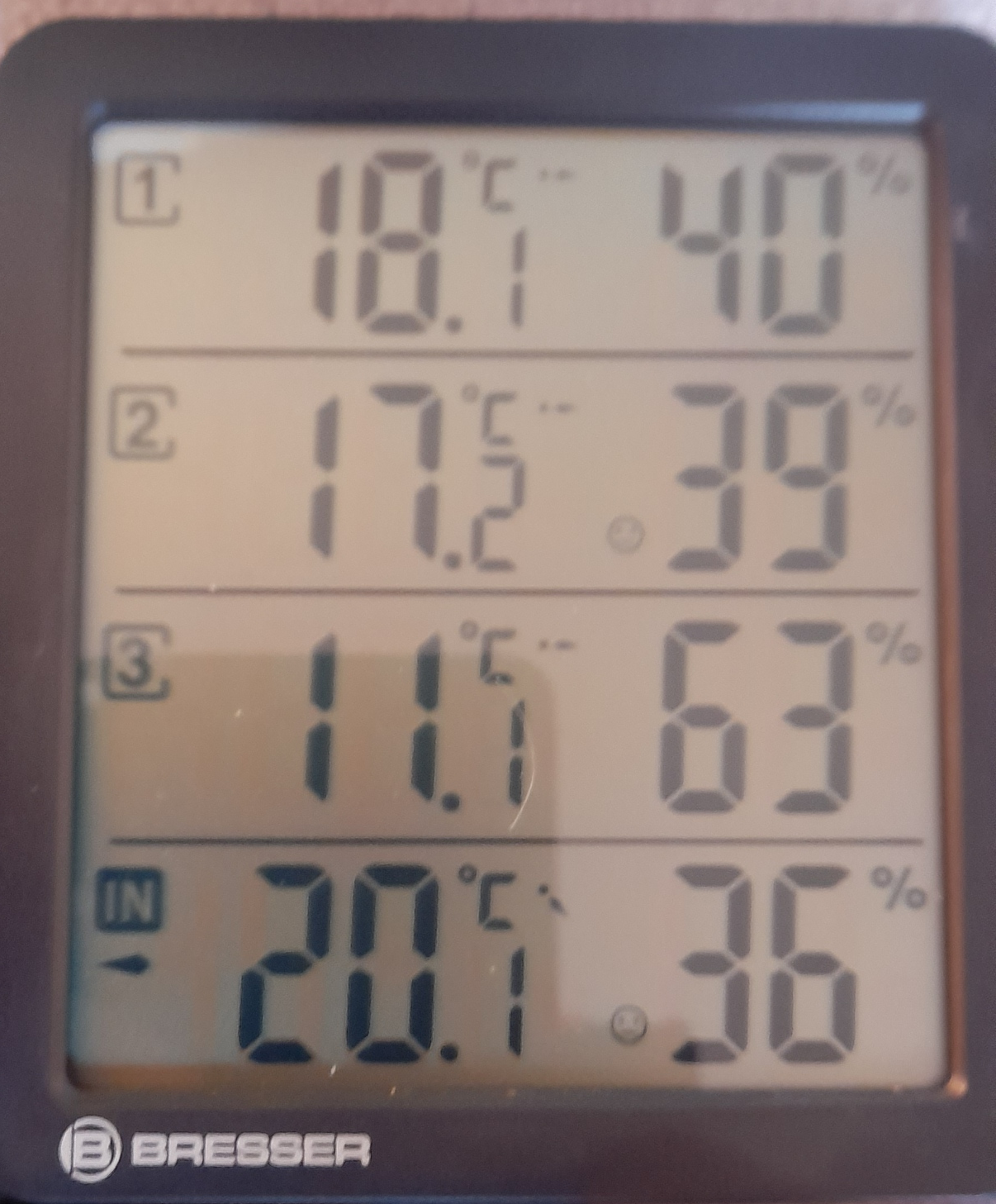

But assuming just spelt wrong, and you meant to say mould, start point is what temperature and humidity reading. My house 1769274790339.png with the relative humidity it compares how much water is in the air, compared to how much water it could hold, so at the temperature goes up the relative humidity goes down, at zero°C it can't hold any moisture, so the temperature of the walls and windows matter. But also wiping the walls with something to kill the mould also helps.
The utility room, unheated at 11.1°C as one would expect, is the worst room, at 63% on the windowsill. The flat under main house, also has heating set low at 17.2°C and 39%, my bedroom 18.1°C at 40%, and the living room 20.1°C at 36% are typical, I look today and about the same as picture taken 16th January.
I think in general mould has got worse, as I, for one, do not heat rooms not in use, but the shower I blame for most of the mould, and where the extractor fan is placed and when it is run.
My shower door seals on the bottom of the shower tray, so there is no chimney effect, I do not run an extractor while having a shower, all that does is drag the moisture out of the shower area, once the shower is completed then is the time to run the extractor, but also where does it drag the replacement air from?
Even when snowing, air from outside has very little moisture in it, it is too cold, we are looking at the dew point, so at 20.1°C at 36% how cool will it need to be to release the moisture. This calculator tells me the air needs to cool to 4.58°C to release the moisture in the air. So as long as my windows and walls are over 4.58°C they will not get damp.
Best room is my bedroom needs to cool to 3.14°C before it hits the dew point.
So last house, the bathroom got replacement air from inside the house, and the bathroom was cold, so it never dried out, so the only real option is a heat recovery unit, so one is taking dry cold air from outside, and heating it with the damp warm air from inside.
All that does is increase the surface temperature of that particular wall slightly. Any condensation will be more likely to occur somewhere else.
At best, this shifts the problem to some other wall.
Total waste of time and money, those things will take weeks to extract what a powered dehumidifier will do in a day.
Those crystal packs are only of use in a sealed airtight enclosure which is small and rarely or never opened, such as an electrical control panel.
It won't. Such things are intended to remove mould that is there, with a limited effect for a short time afterwards.
There is no magical spray or coating which will prevent mould from forming long term.
meaning the house and all surfaces in it will be cold.
This will have two effects - the air will be cold, meaning it can contain far less moisture and will reach a high relative humidity very quickly.
Then those cold surfaces will be below the dew point, so condensation will form followed by mould and rot.

The solutions are the usual ones:
1 - heat the building properly, which will increase the amount of moisture the air can contain and increase the temperature of surfaces within the building.
2 - Ensure that all created moisture is removed, which means installing and using extractors in the bathroom and kitchen, not drying clothing indoors including not hanging wet towels up in the bathroom to dry after use, using lids on pots and pans when cooking, not using any heating source with open flames including gas cookers, candles, paraffin heaters, those portable gas fires that use propane, not using any tumble dryer that vents into the room, not leaving pots, pans and whatever else in the sink full of water all day,
Dehumidifiers are a final option but are only of use if all of the above is already being done all of the time.
Otherwise they will just remove a bit of moisture one time, and then it will return.
