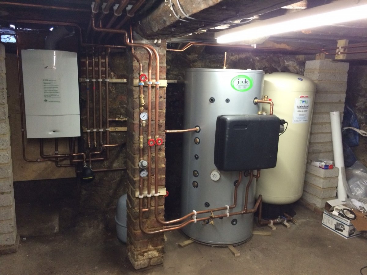

Your options are to consider putting a thermal store down there.
We are just doing such a job at the moment.

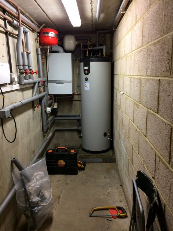

Or, if any of the cellar is above ground, consider an ACV Smartline, because the discharge is at the top. Just done one of them too.

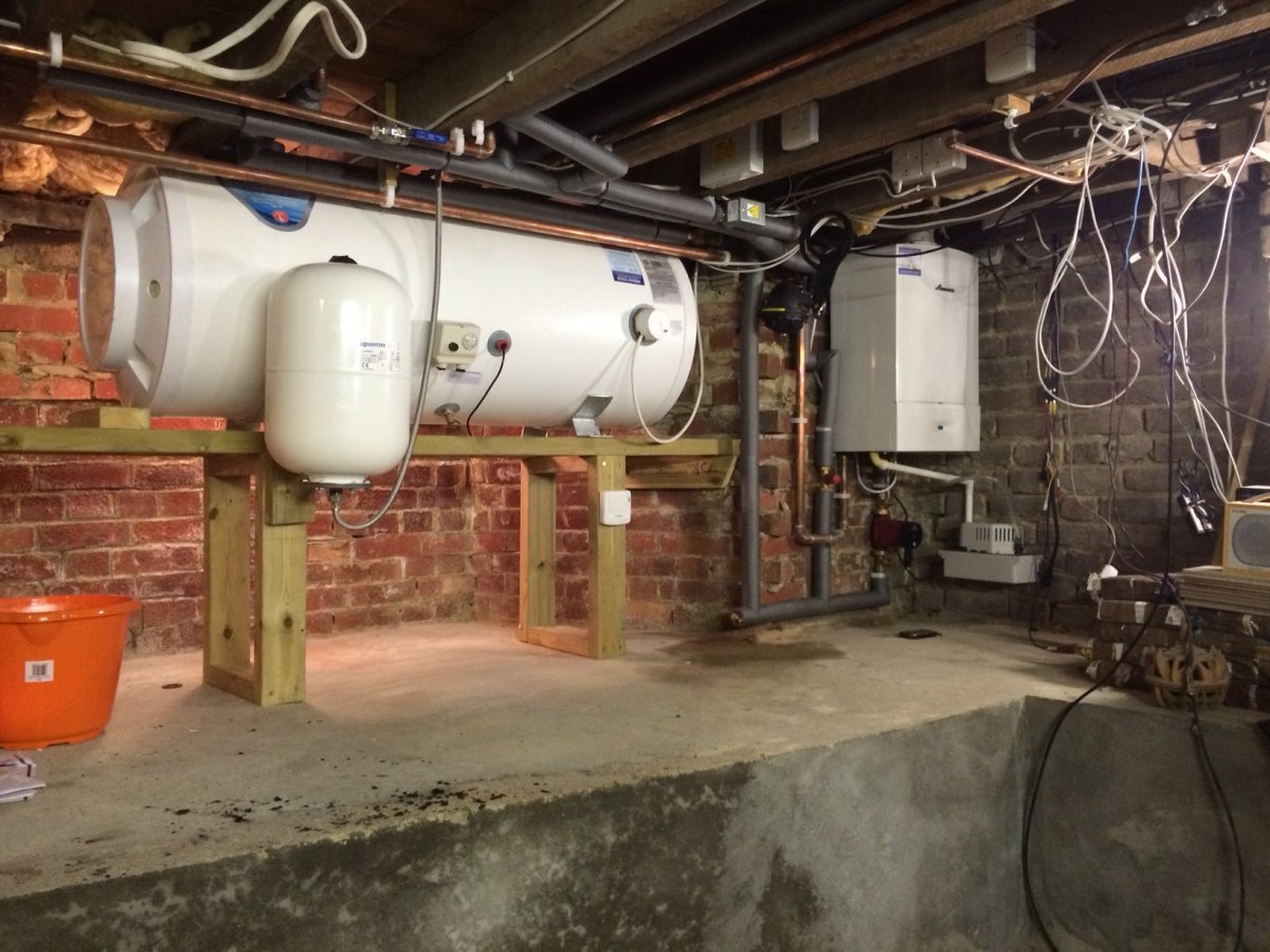

Or if you have room, flow and pressure in the loft, or an opening near ceiling height for a discharge in the cellar, consider a horizontal unvented such a Gledhill Stainlesslite. Did one of these in a cellar conversion, around 18 months ago, in South London,
with Evohome zoning. (Extra wiring belongs to client).
Coincidentally, there's another Evohome powered identical Gledhill horizontal cylinder we specified in a multimillion pound refurb in Richmond on Thames finishing next week.

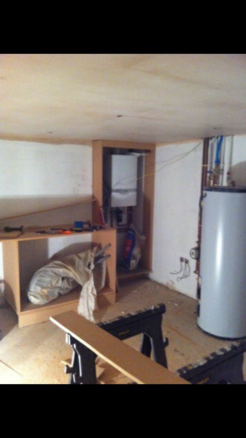

We have a vaillant ecotec plus 630 boiler and a fabdec excelsior 215l indirect unvented cylinder.
All of the basement is underground but at the ceiling height is slightly above ground. That is where the flue is vented. Maybe you can see from the attached picture. Please use your imagination as its a bit of a before and after job!
Does any of this information affect your advice please?
