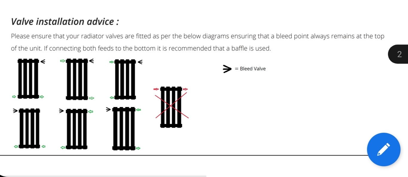

Hello all. I have a bit of a dilemma.
I recently completed my loft extension and I'd fitted 3 upright radiators up there. These ones
1780 x 280mm Anthracite Double Flat Panel Vertical Radiator
The radiators do not get hot apart from when the system is drained and refilled.
When the system is drained and refilled, the radiators get very hot for about 1 day, but then after that they only get hot along the bottom bar, but the rest of the radiator doesn't heat up.
I've balanced the entire system. Same problem. I've even turned off all the other radiators around the house, when I do this they get hot but again only for a few hours.
I've even switched over the flow and return pipes as they enter the loft but again same problem, the radiators do not get hot for long.
I've contacted Radiator Outlet who I brought them from but again not really much help.
There's no indicator on the radiator to say which way is up and which way is down. Could these have been installed upside down?
Some designer rads have a baffle in bottom run so possible to fix upside down (I've seen it)

I may be wrong, but I believe RadiatorOutlet and BestHeating use the same OEM - interestingly, the guide for installing the BestHeating Milano suggests:
So, baffles are recommended, but may not be installed!

If you turn off the other rads and these warm up properly then it seems there's nothing wrong with the way they are piped.
Is your loft the '3rd' floor? If so then you are probably right at the circulating limit of the pump, if the boiler is on the Ground floor. As the other rads in the house are all below those columns then there may not be the headroom left in the pump to provide enough circulation to supply every rad. Adding these columns, especially given their height and the way they need to circulate the flow to work correctly (up to the top to drop) may be asking too much for the pump to handle, more so if the system is convoluted with lots of bends, longer pipe runs, pipe size reductions, etc.

Don't forget the extra height of the rads, that's almost another 2m of head req, so if it is the '3rd' floor then that's around 6m of vertical head required, just for them, the other rads not withstanding. These columns need their flow to run to the top of the rad and then cascade down for it to heat the rad properly.
If the other are shut down and there is enough head in the system to reach them and then with the others on, there isn't. It can't be anything else unless there is a lower rad short circuiting the flow up to the loft.
Not knowing the pump for that boiler, I would presume it would be around 6m head?
