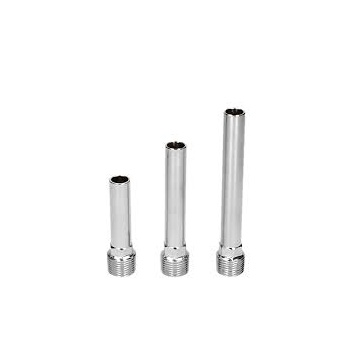

I prefer these extensions - you can cut them to exact size and I think they look better than the chunky barrel type!

I like the look of those extensions too, I believe my local screwfix has them.

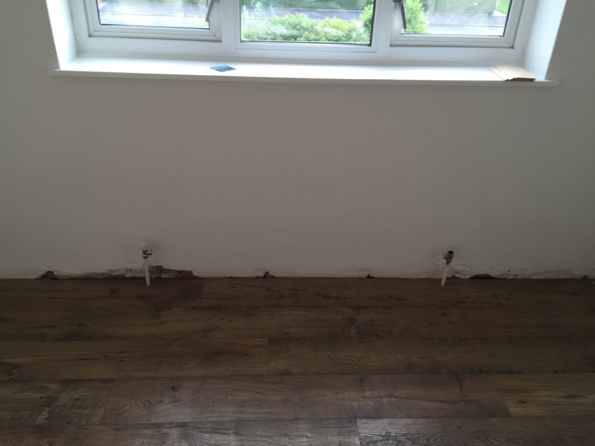

So after swapping out the union valves with the tail valves in my earlier post, I bit the bullet and partially drained the system (switching all the thermostats and lock shield off to retain the water in the rads).
Draining was simple enough from the hallway. And with a little effort I removed he old imperial valves, olives and nuts so that I could measure out my flooring and slot the new laminate over the pipes.
Spent most of yesterday in the room from painting to pipes to floor and I'm pretty pleased with the results.
I've not yet got he rad on he wall, still got a bit more floor to put down as well as the new skirting.
Switched the system back on. No leaks = success.
Thanks for the help, appreciated!
