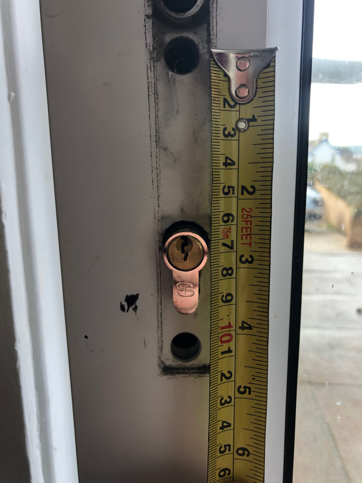

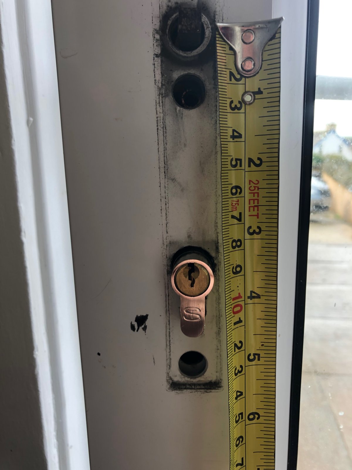

I have just moved into a new house and I am trying to replace the now very tired looking UPVC side door handles. However. It has a very funny length on it which I cannot seem to find anywhere. They are 92mmPZ but the distance between the 2 screws appears to be 105mm.
Any thoughts or help appreciated?
Just a case or trying local suppliers. Do you a local Eurocell, they carry spares. What about the likes of B&Q, Wickes etc.. it may have been just off the retail shelf.
Final option, remove the beads and take the door panel out to see if there's a manufactures sticker inside the door area.
Multipoint handles generally have 2 bolt fixing variants.
If you take the lock out you will probably find it will accept more than 1 option which might mean drilling new holes in the door.
Yep, that's what I am thinking.
