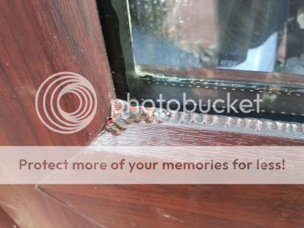

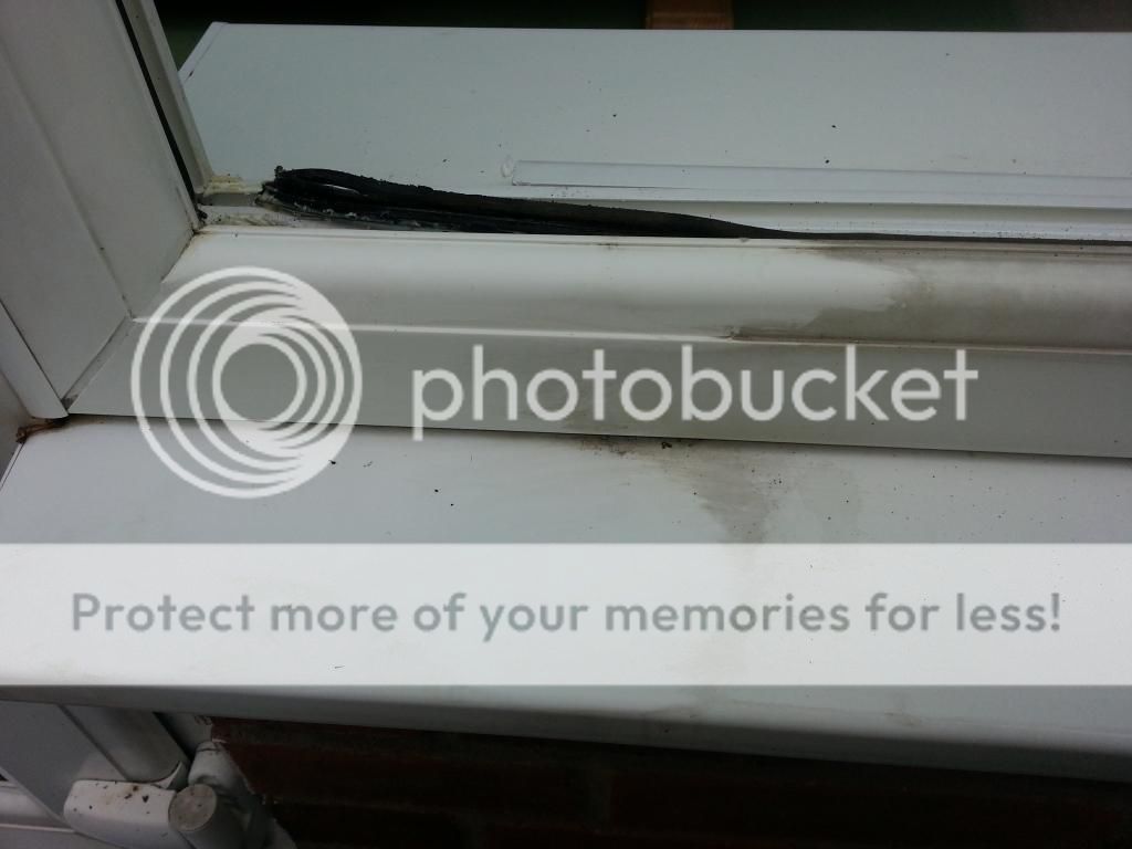

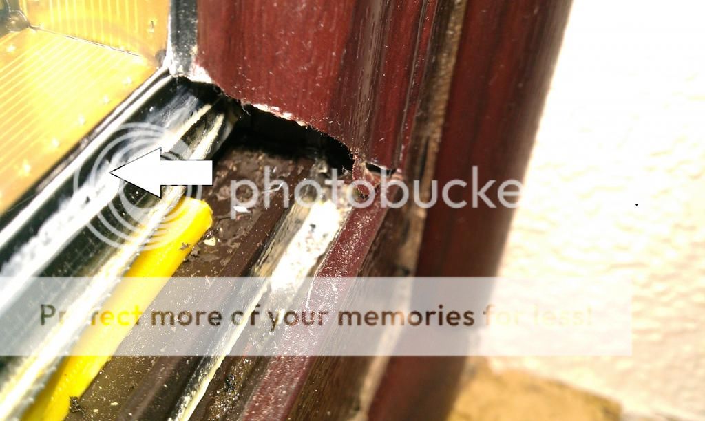

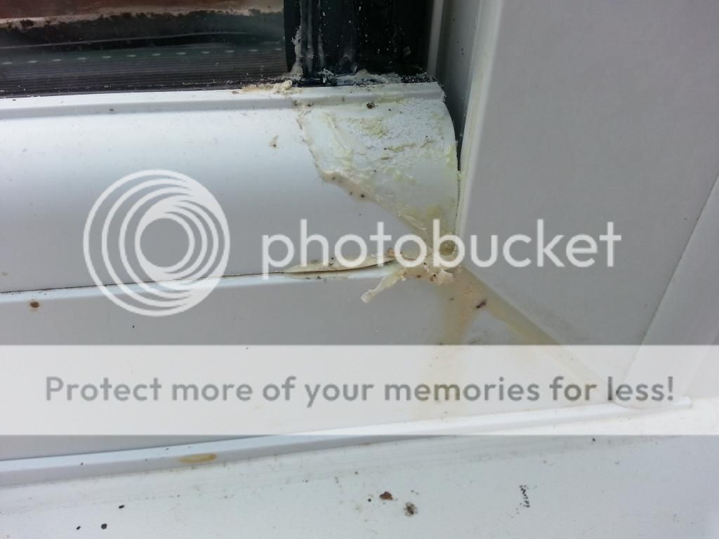

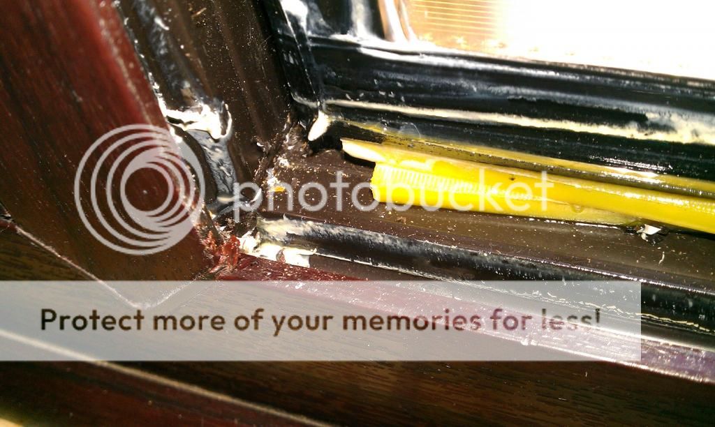

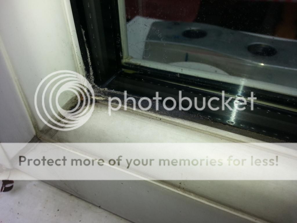

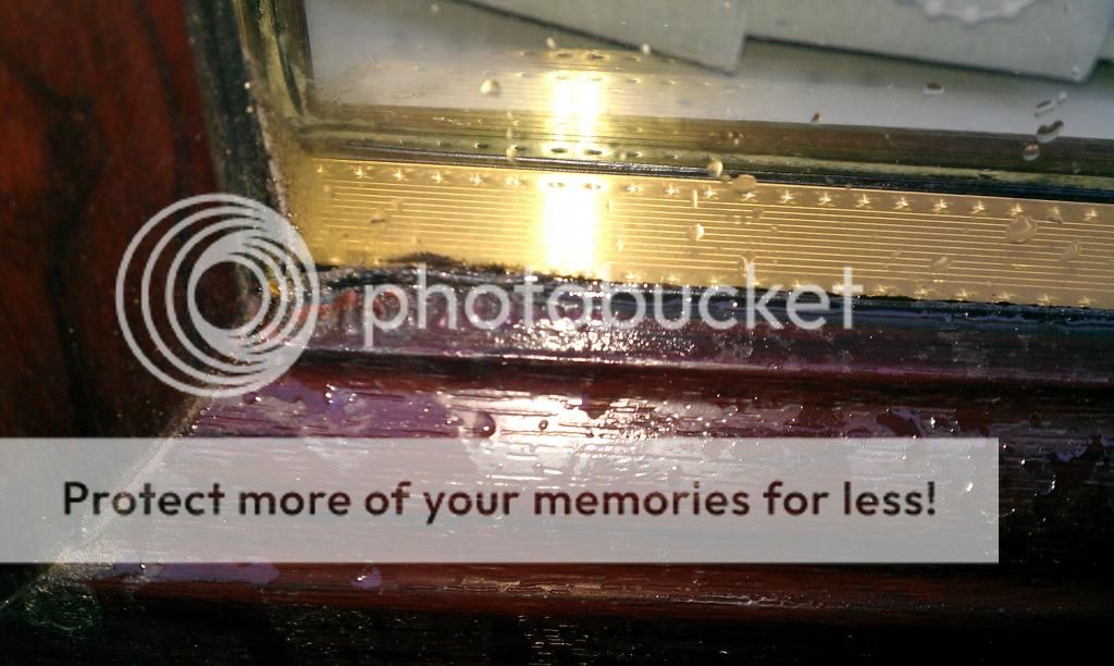

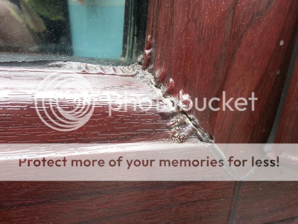

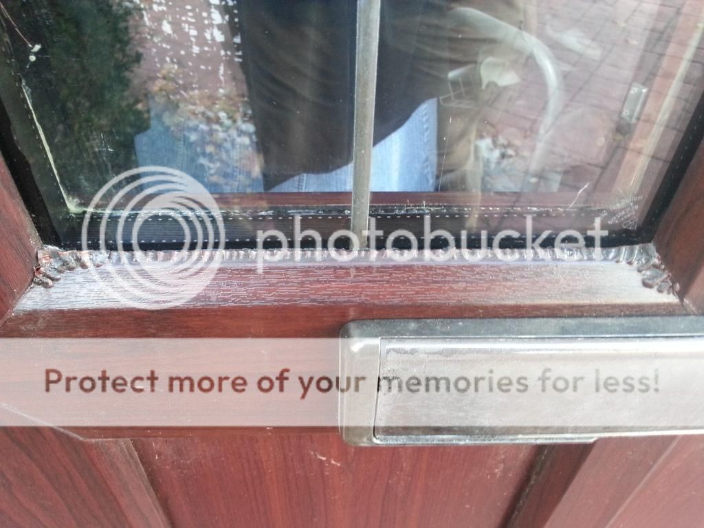

On my phone this so i'll reply in more detail when I get off site but it's probably the glue from the duct tape around the glass has turned gloopy and ran to the bottom, it's reacted with the foil and blown it away from from the profile, it's probably even seeping out the internal bead mitre joints? Tell me I'm right?
I'll post up some of my pictures of it I see, it's not a rehau fault but more of the glass unit/duct tape used
Heres some stuff i've seen while out inspecting for insurance companies
Thanks Crank. The blistering or bubbling on the wood grain photographs are identical to our problem. So if this is not a manufacturing problem could it have been caused by the person who installed the conservatory? How did you come across your cases and what was the outcome from the customer's point of view? We don't see to be able to get any advice as to where to go next. Our Warranty protects us for substandard goods that are not fit for purpose.
I can't say too much on a public forum (no offence you other guys) about who i work for but if you PM me i can be a bit more specific.
You have definately not caused this yourself, get the fitters or company boss back and get him to remove the glass from one of the windows affected, he/she should see glue dripping down from the tape and collecting in te bottom, if he's being honest with himself he will see straight away whats caused it, probably a bad batch of tape the glass shop used so it is their fault and not necessarily the installers. You might even find the company who fitted it didn't even make the frames, some companies buy everything in, the frames, the roof, the glass but your contract is with them so they need to put it right and they take it up with the glass shop, in some cases certain DG companies manufacture everything but thats reserved for the bigger more established ones.
You have no access to the edge of the glass so no amount of cleaning by you would of caused this.
There is no way to repair this, the whole frame will need replacing, if theres a fair few to replace then they won't be happy and i'd fully expect them to play awkward about it, in some cases its problems like this that can fold a small company/fabricator.
You have my permission to print off or email the photos to your installer to show you aren't alone with this defect, its nothing to do with cleaning, its defo the glue as can be seen in all my photos
