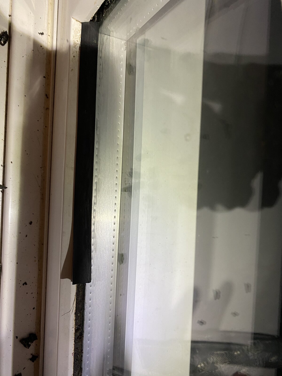

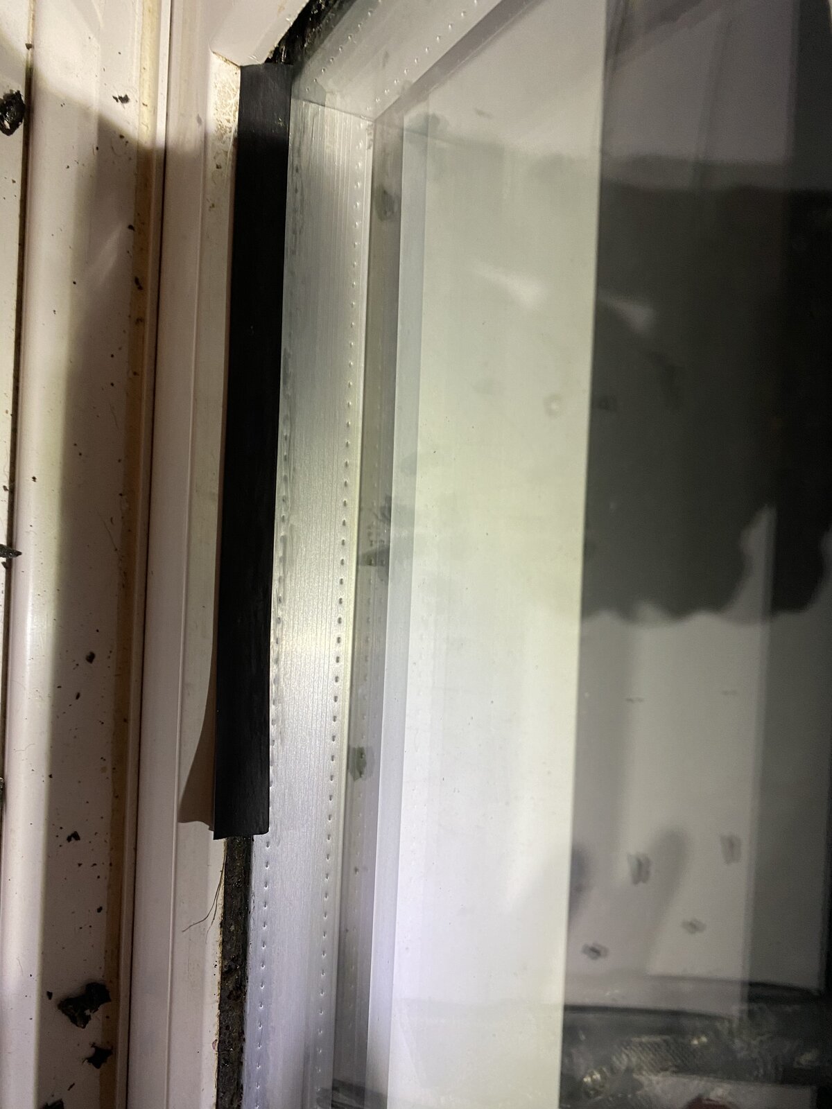

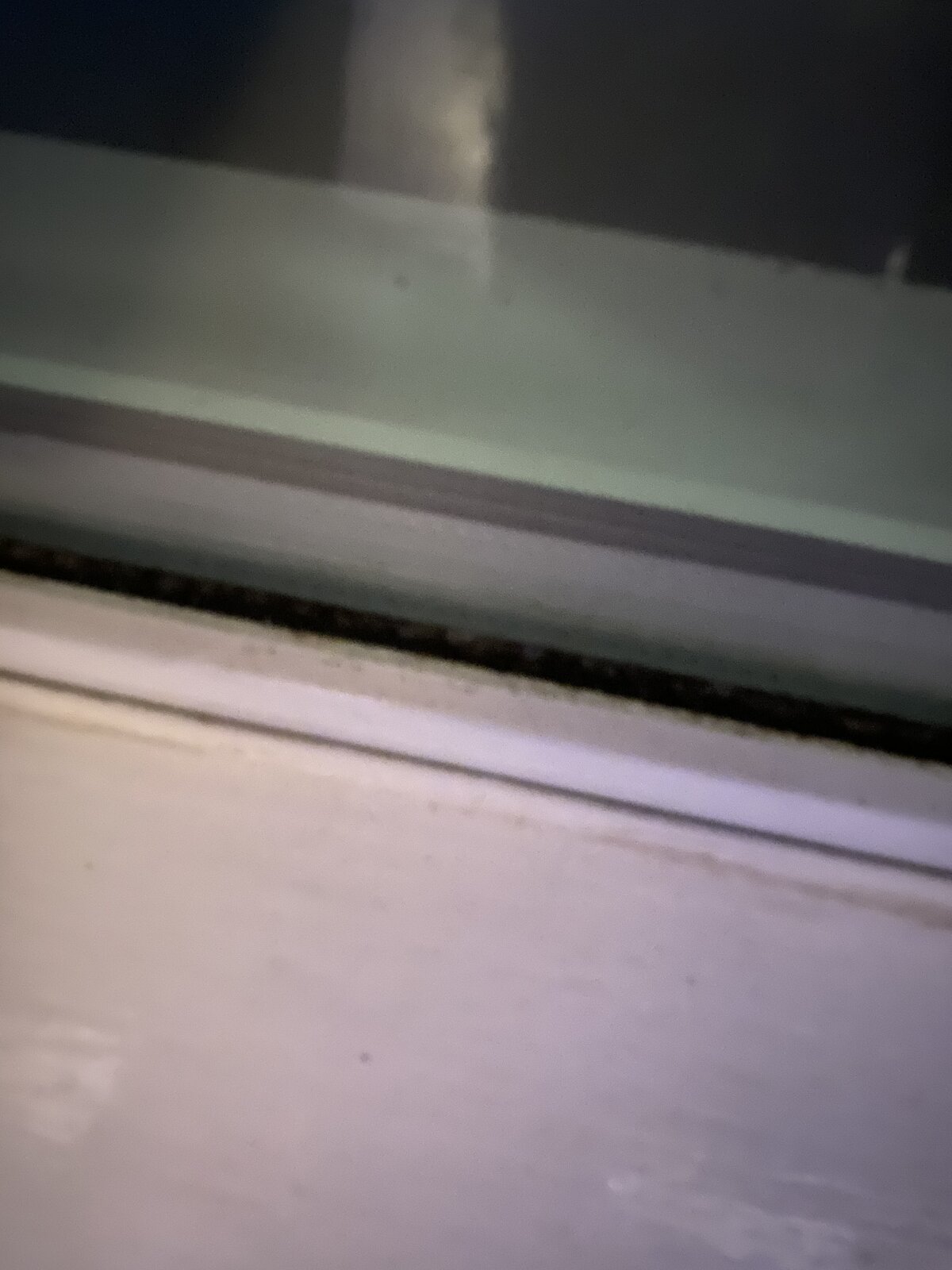

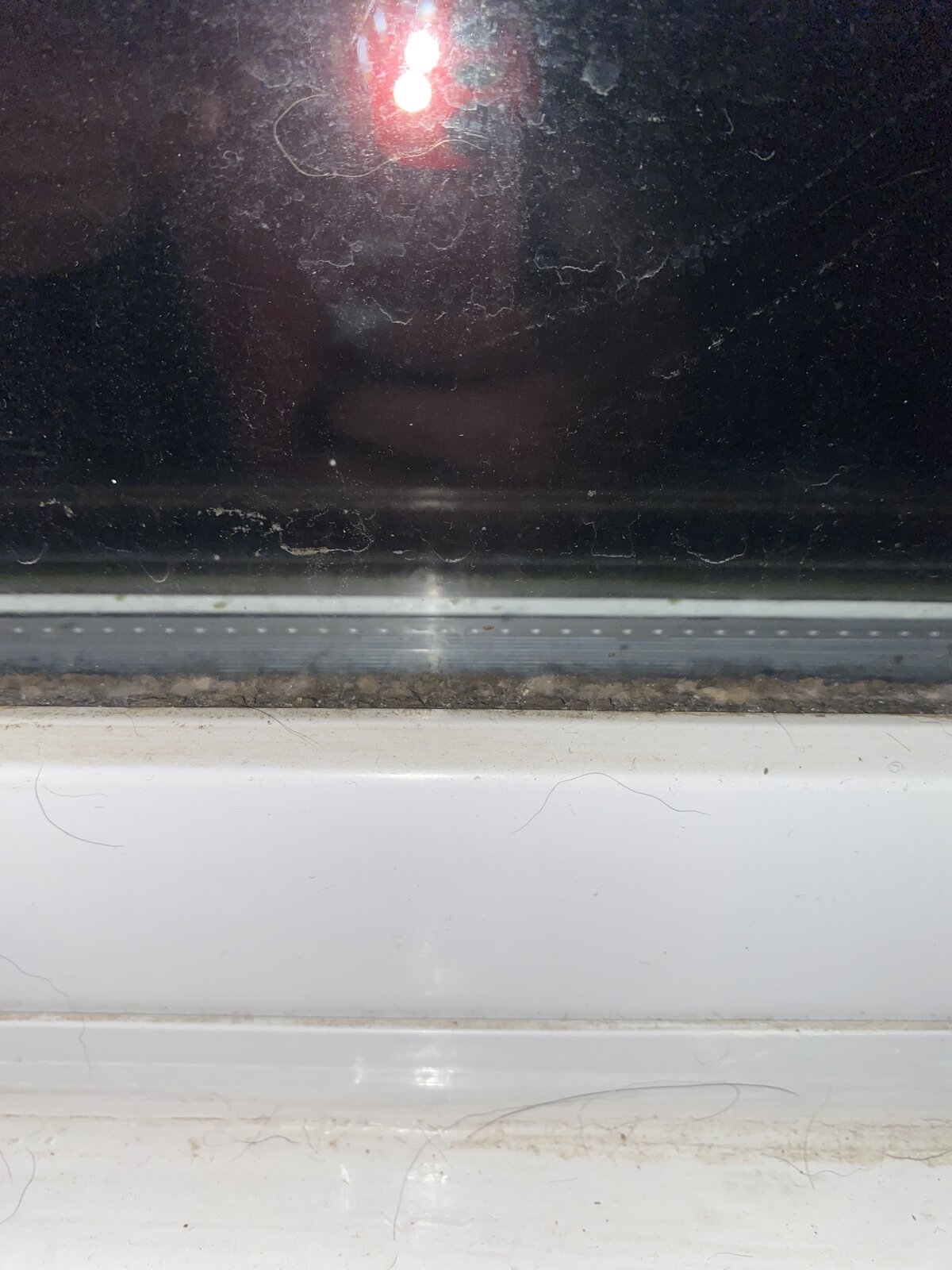

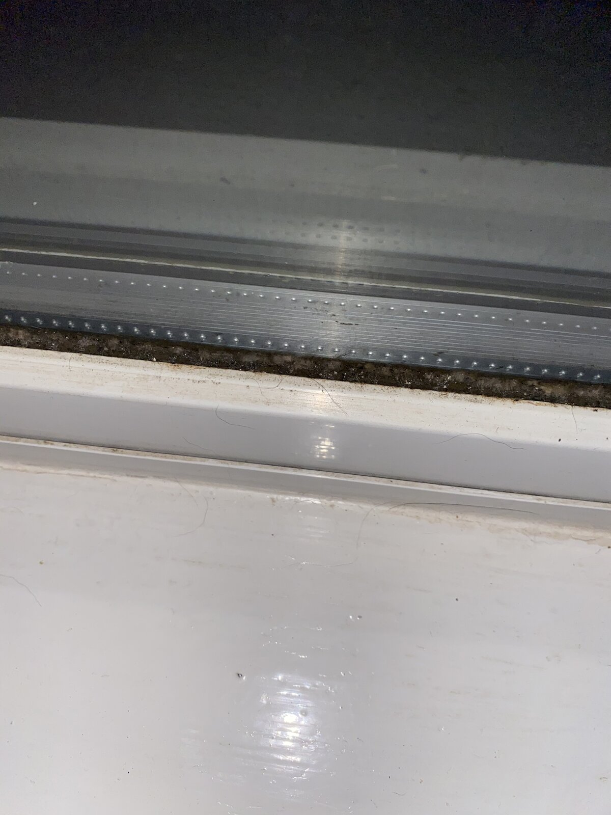

Hi All,
I have just bought a house with upvc windows which I believe are fairly old. In the long term I want to replace them but for now I would just like to give them some TLC.
I am intending to replace seals around the opening windows and seal around the frames.
The seal between the double glazed unit and actual upvc frame has seen better days however. Can I replace this by prying the old stuff out, getting a seal of the same profile and pushing the new seals back in? Pictures attached for reference.
Dan

Hi and congrats on your new home :)
As a first step, have you tried cleaning the rubber seals? Looking at them, I reckon they would clean up fine and the requirement to try and replace them would be avoided. I would definitely try that first and if they still look pants, then think about replacement options.
Thanks for the advice diy_fun_uk. Unfortunately they are past the point of needing a food clean. They have actually rotted and recessed past the edge of the upvc in places.

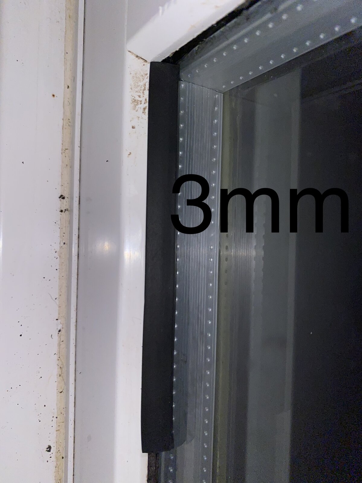

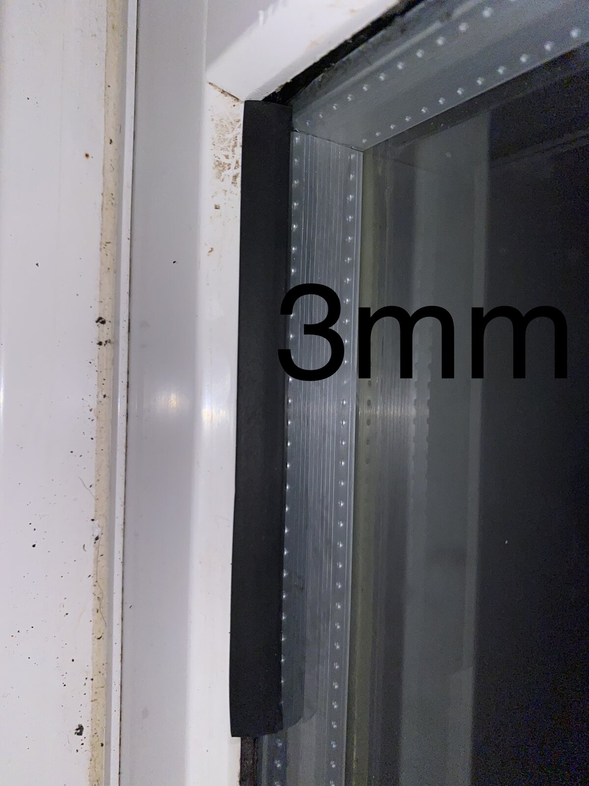

I have received the sample pack today, looks like it's going to work a treat as per the attached picture.
Any top tips for removing the okd gaskets. Mine appear to be potentially glued in. As they are in such a perished state they are crumbling apart. I will pick them all out if necessary but wondered if there was any tips and tricks to speed it up?
Thanks Again
Dan

That was quick! The one you've shown in the picture seems wider than the existing gasket? Before you order, ensure the gasket you've selected definitely fits into the space. Do this by removing a section of the old gasket and inserting the sample pieces until you find the right one, not too tight not too loose as they say!
I doubt the old ones are glued. If they're crumbling, all I can suggest is using a tool that can get underneath (e.g. something with a hooked end) so you can then prise the gasket up and out.

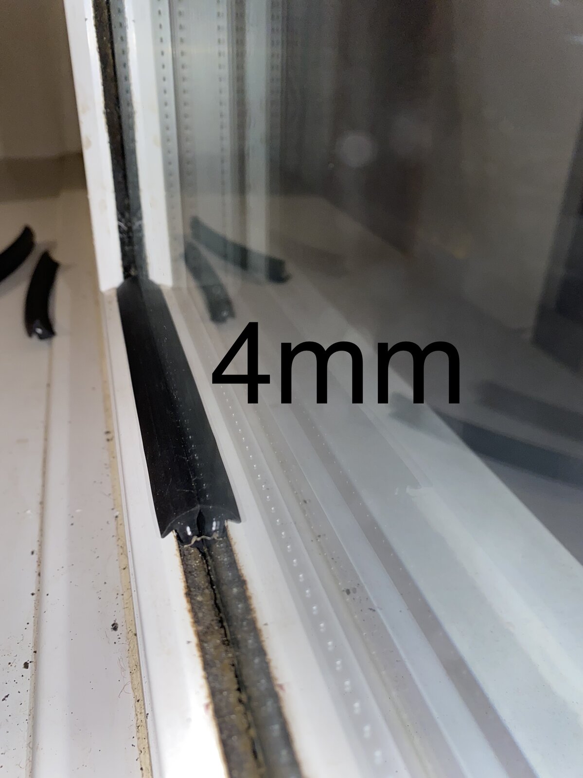

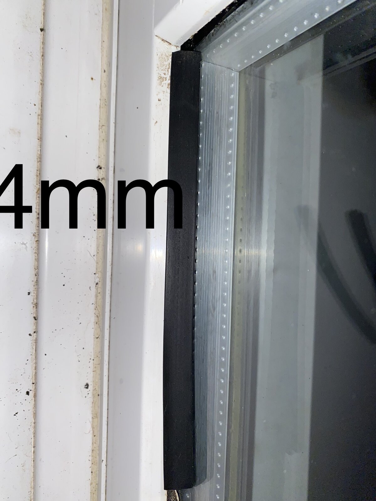

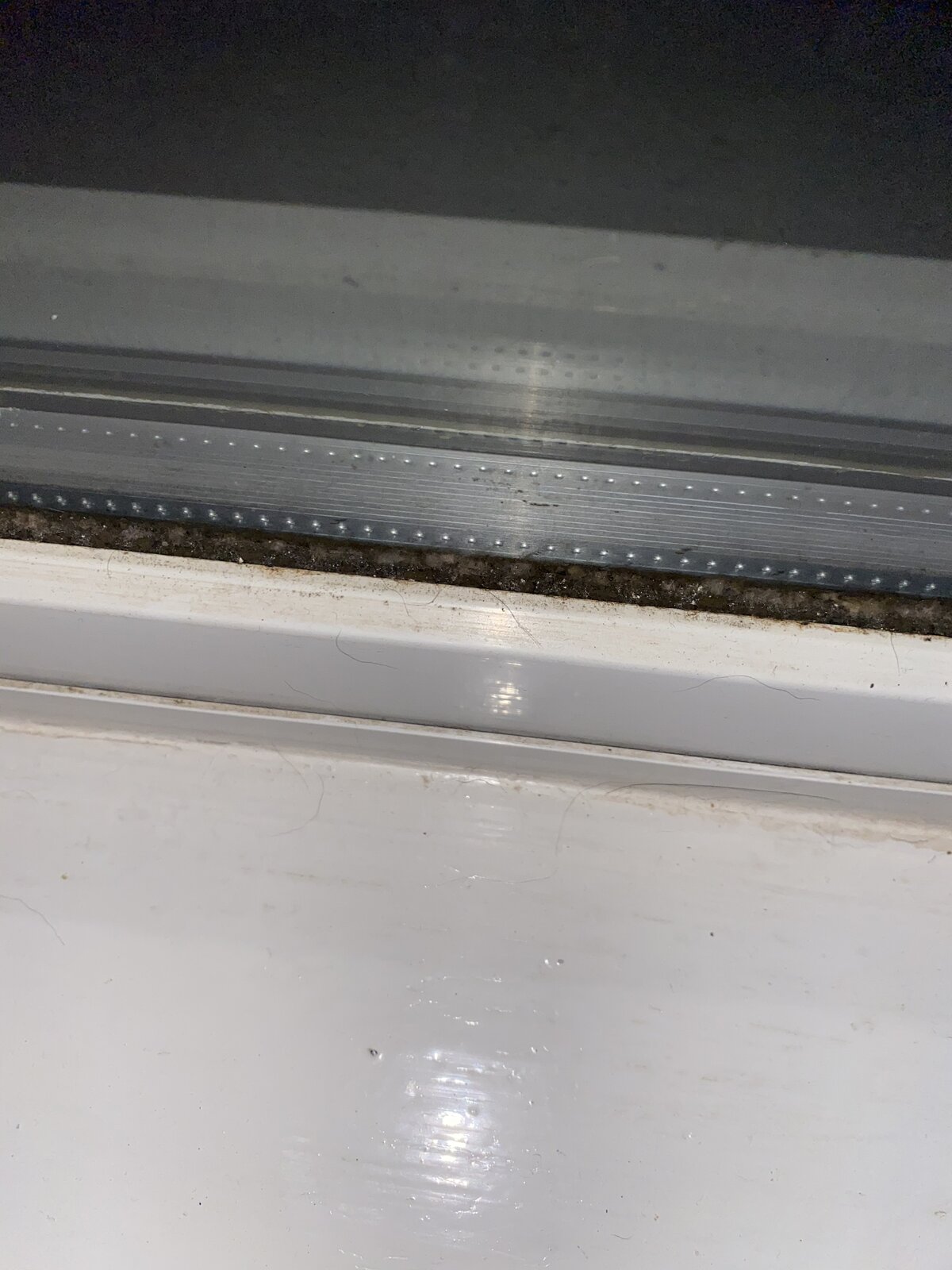

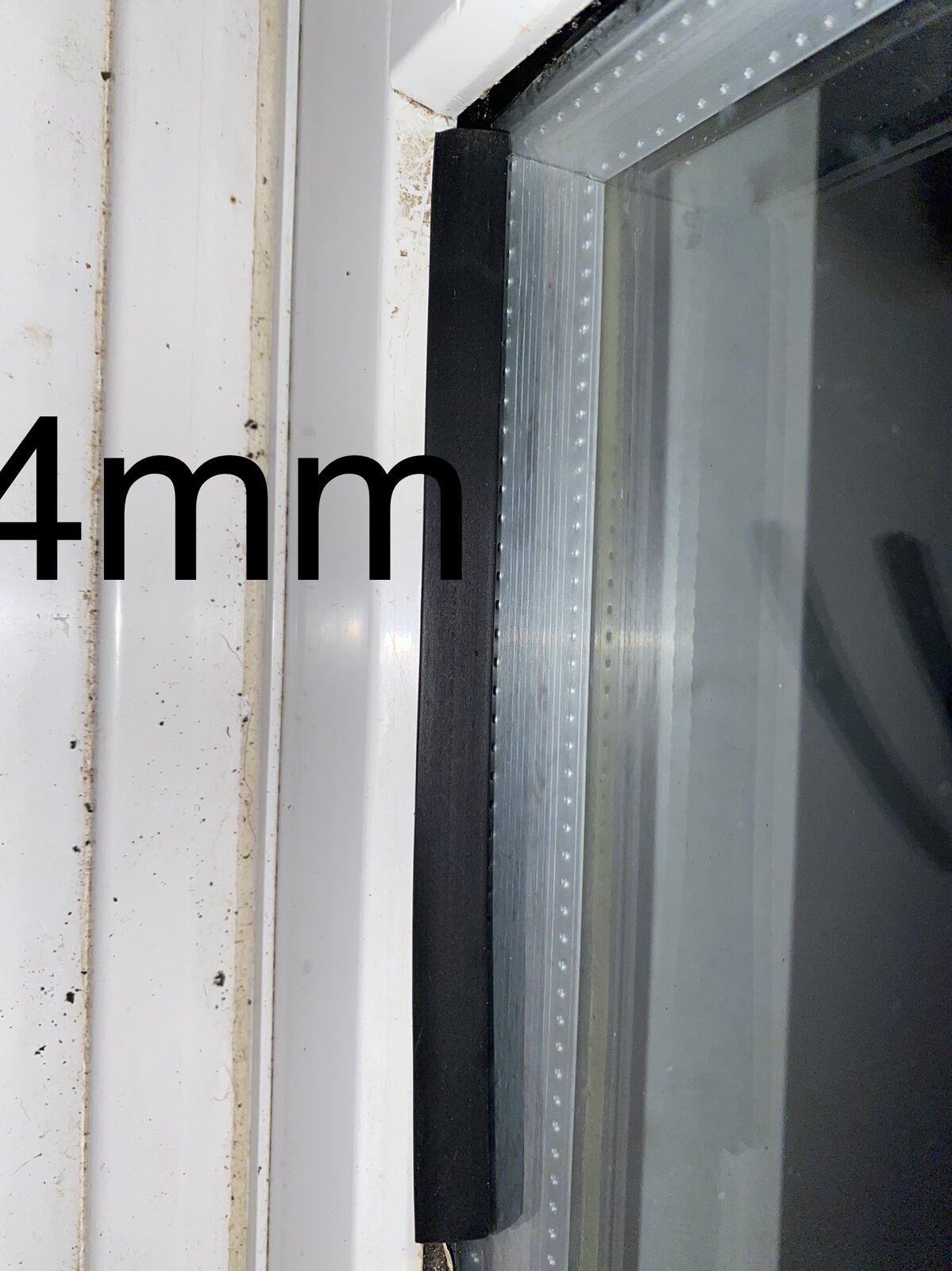

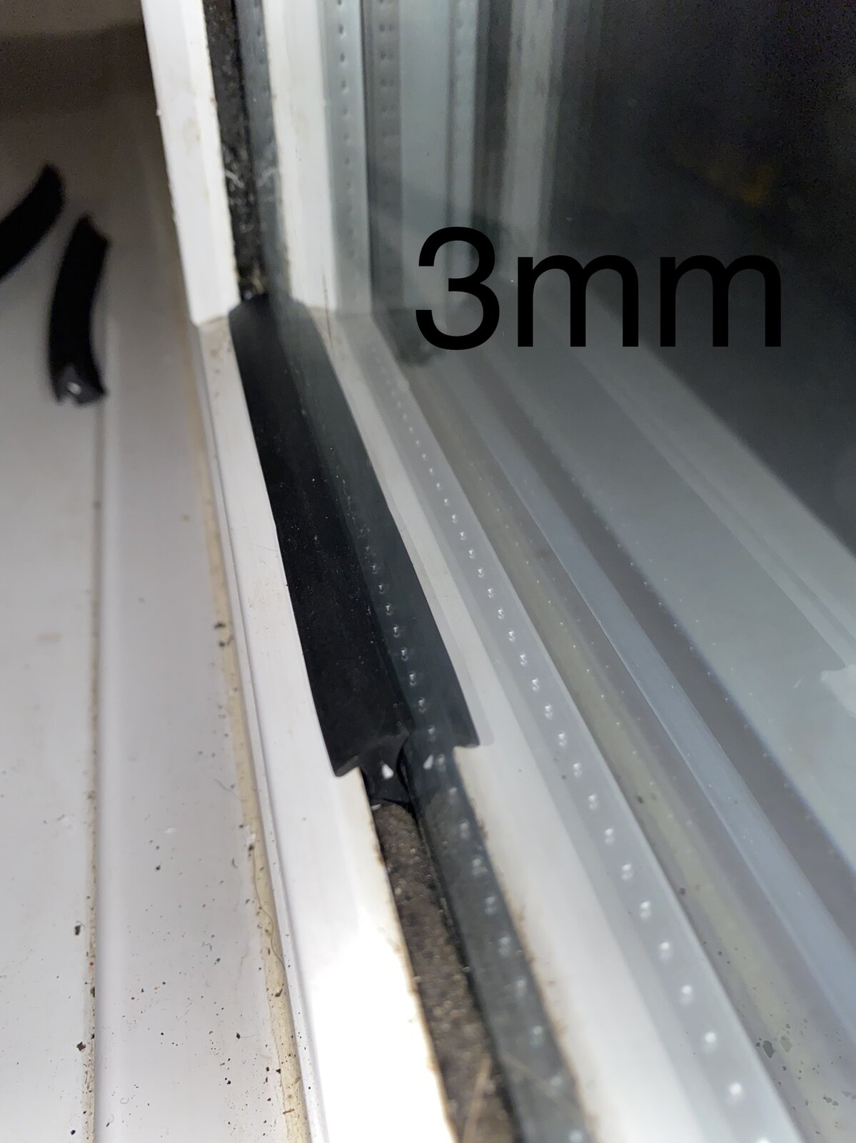

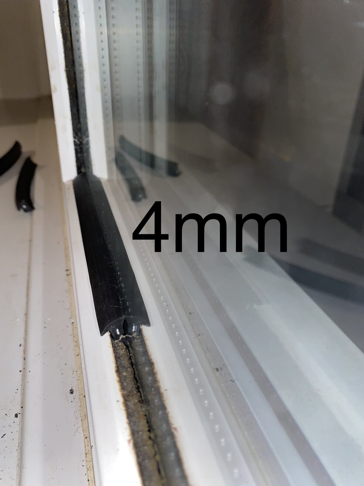

I think it's hard to judge what was there before as they are so perished as you can see. I just tried both the 3mm and 4mm after your message. I'm not now sure which to order? What is your opinion from the attached images. Thanks again!

I bought sample pack of ebay and replaced the mine when I found correct size. Your 3mm looks fine though. I'm still annoyed I cut 30mm too long and they still shrunk though. Could not squash in any longer though
'If' the 3mm is fitting well into the gap (i.e. snug fit) then it'll do the job. Ideally you'd want one a bit thinner e.g. 2mm - 2.5mm purely from a looks perspective. If you Google 2mm wedge gasket you'll find other options but as I say if you're happy enough with the 3mm then go for it
As I said before make sure you don't stretch it out when fitting cause it'll shrink back and leave gaps at the end
