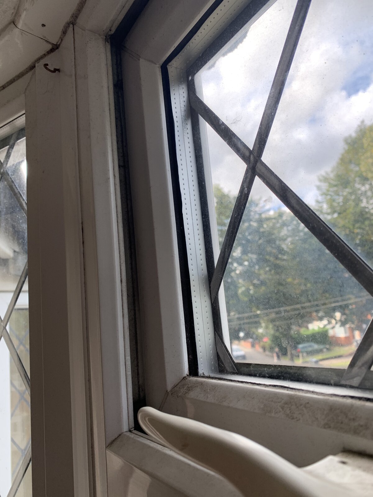

Hi and Good afternoon
I have a small bedroom window that won’t close properly on one side.
Nothing obvious appears to be blocking it and the handle seems to be working as ok (if not a little stiff to close)
any help would be appreciated
thank you
Worn hinge/s not locating at the top, open the window and look at the top of the hinge where its fixed to the frame, on the frame side you'll see a V shaped cup, on the opener side you should see a point, this point should slide into the V shaped cup, its very likely its running on the outside of the cup hence the gap
Zenith staybrite windows by the look of it so its about the sort of time handles hinges and locks start to fail
