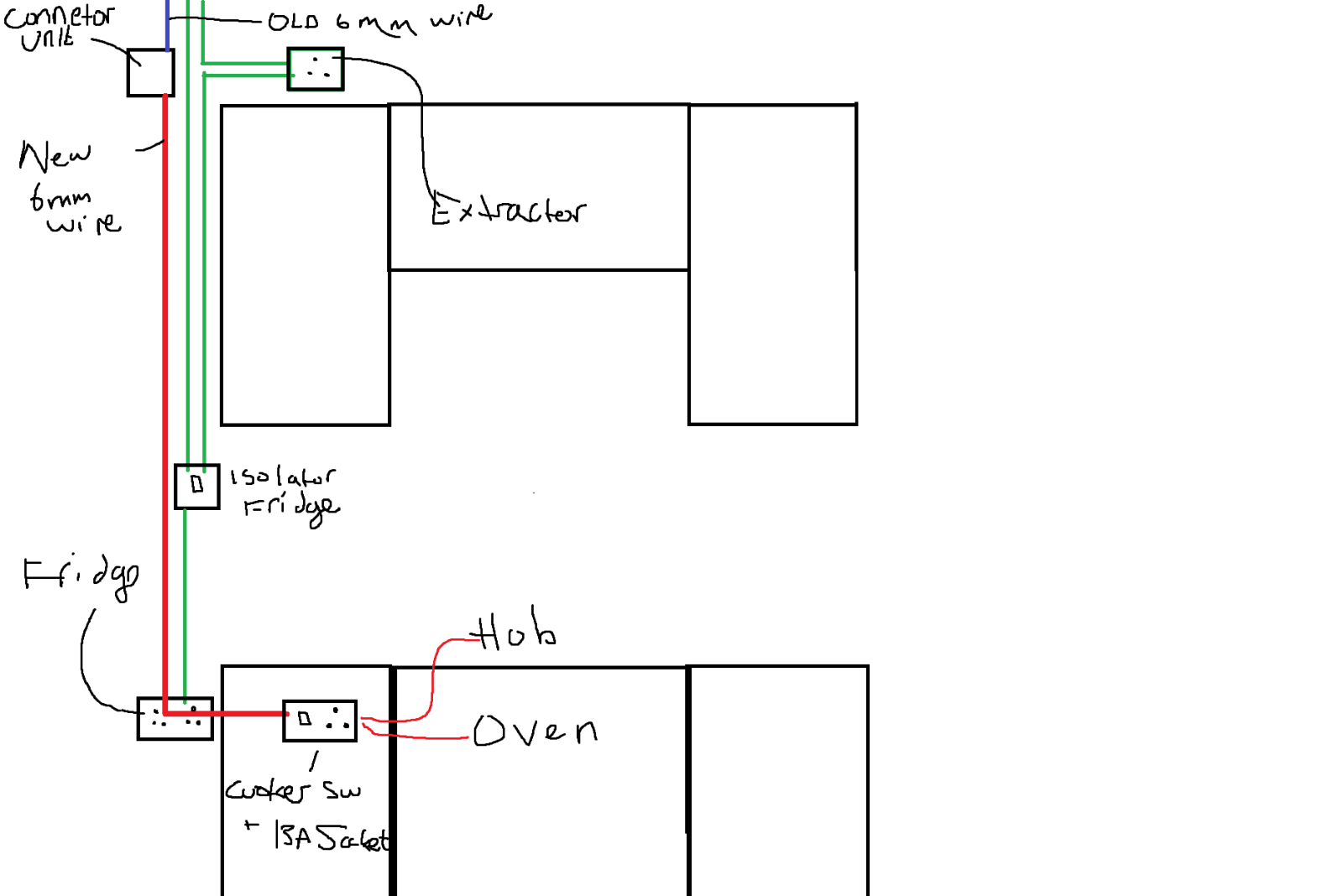

I am renovating my kitchen and have run into a problem. I need to extend a 6 mm cooker cable on a 40A MCB. The cable can’t reach the cooker switch, so I’m planning to use a 45A cooker connection unit as an extension point ~1.5 m before the isolator. Is this compliant with UK wiring regs?
Would it not be possible to fit the cooker switch at the end of the existing cable and then another cable to the cooker position?

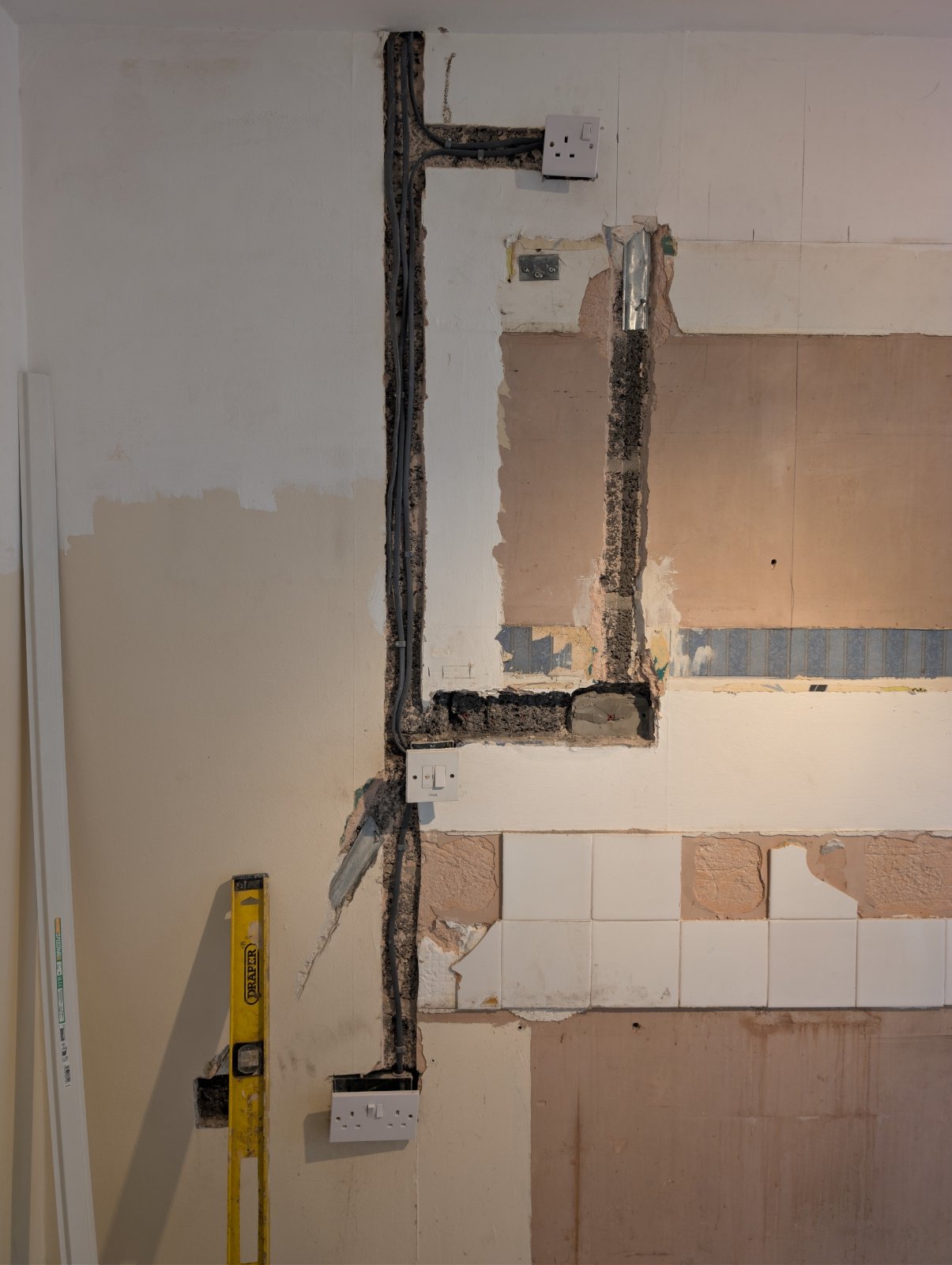

Hmm I think that would be possible. The cable is coming from the upstairs floorboards and will only reach to behind the wall units. I can put the cooker switch behind the wall unit and cut the back out to make it accessable.

I have added a picture of the whole situation on the original post. If you zoom in you can see the cooker wire going half way down the wall.

Not exactly, I agree. However, given the paucity opf information I thought (I now know incorrectly) that the cooker cable he wanted to extend was probably a currently-in-service one, hence presumably terminated in something (quite probably a 'cooker control unit') - but it now seems that he's simply talking about a new bit of cable which isn't quite long enough?
That would be acceptable for an isolator and save you a joint and £6.45.
Just to point out that local isolators for a cooker (or anything else) are not mandatory so placing in a cupboard is satisfactory.
Yes, that was the sort of thing I was talking about.
... so what did you mean by "1.5m before the isolator" in your original post? I thought you meant that you needed to extend the cable by 1.5m and connect its end to 'an isolator' forgthe cooker?
Sorry for the confusion, I didn't explain it very well, I have drawn a diagram to better explain it.
