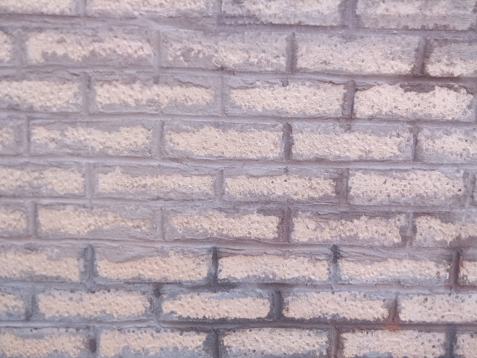

I've put a sample of my work below. I know I've got as much on the face as in the beds haha. I'm going to clean it up the best I can and paint it. I don't know what you call these sort of dints in them but the mortar seems to get nicely stuck into them when pushing it in.

You may be better off trying to cut as much of the mortar off as possible using a hammer and sharp bolster chisel and some steady light taps, and then use the acid on the stains.
Hi Woody, thank you for the tips, I will try with a hammer and bolster first as you suggest.
