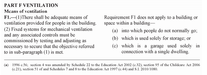

Need to put an extractor in my utility room at some point, as building inspector wants one in there as it’s a new extension.
Any idea if I can fit a pull cord one, and have it plugged into a socket with a 3a plug fuse (like some people fit hood extractors) to save having a separate fan isolator switch etc?
Don’t see why not. But you don’t need a fan isolator switch etc anyway. You could wire it directly into the lighting circuit.
I assumed (possibly wrongly) that it needed a timer overrun, and therefore a perm live so a fan isolator.
Yep, it has a window. They’ve still said I need the fan as it’s got a sink and washer dryer etc. Doubt I’ll persuade them otherwise but could try.
Does a fan with timer over run not need a means of isolating then if it’s fixed wiring?
No, but it might be a good idea.
The Building Regulations merely state:
