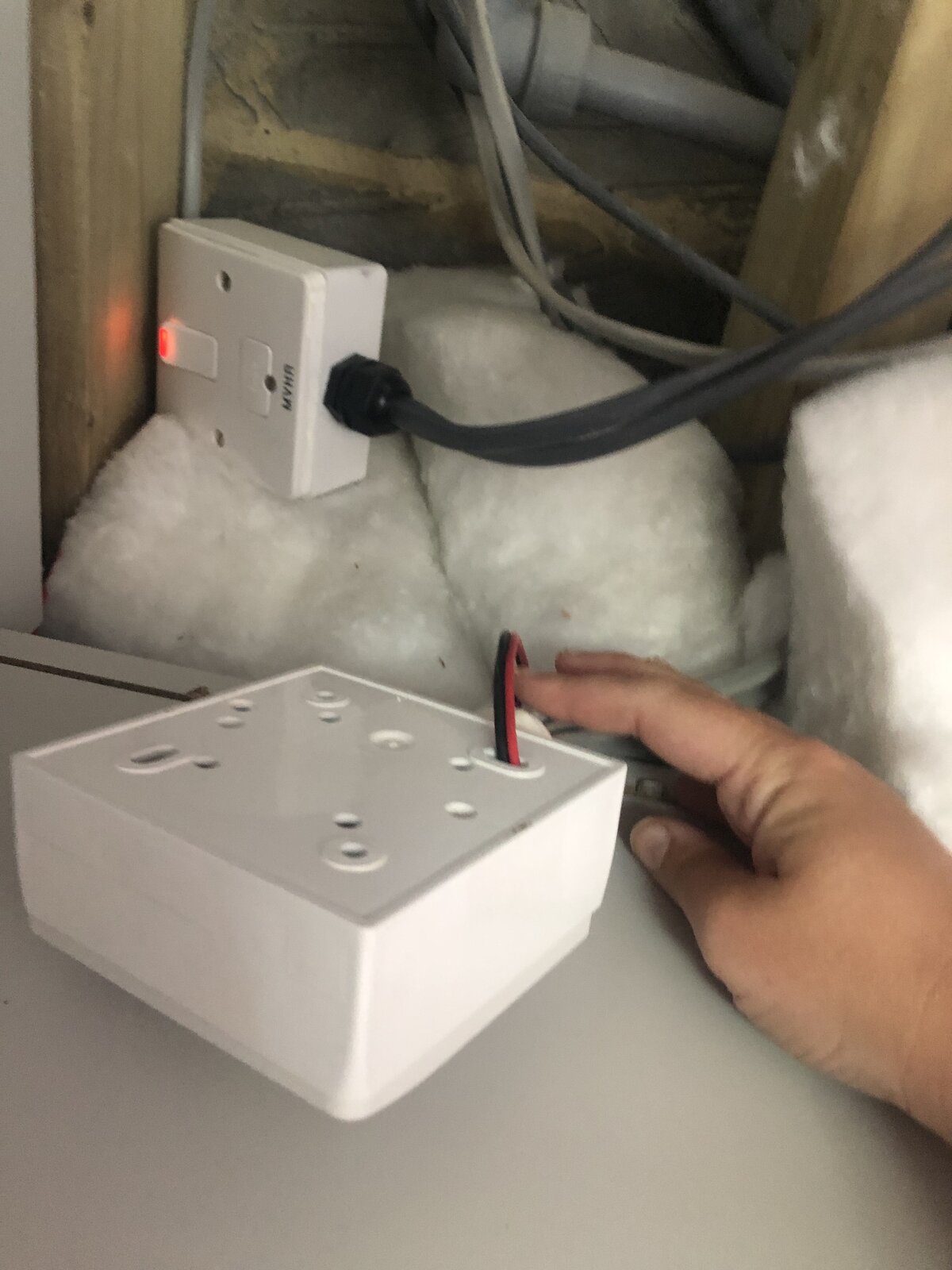

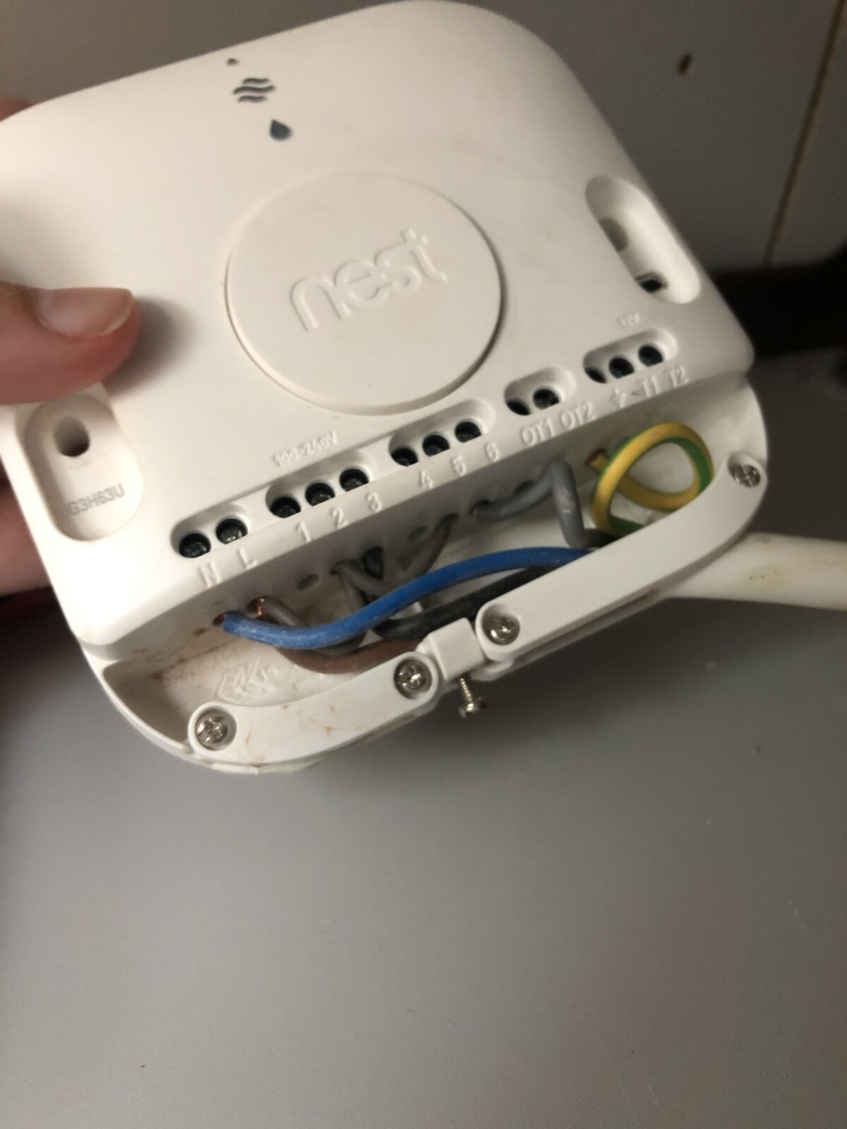

Hello,
I know this topic comes up a lot so apologies!
We have just moved into a new house that has a Vaillant boiler, megaflo and a nest 3 thermostat installed.
It is my understanding that the boiler always needs to be ‘on’ for the hot water to work, and then the radiators are controlled by the thermostat. When we turn off the heating on the Nest, the heatlink clicks but the radiators stay on. Is the hot water also controlled by the Nest?
i have a picture of the heatlink wiring which I’ve attached.
Our sellers left us no instructions for how to use anything in the house so scrambling around trying to make sense of everything so thanks for your help!
your Nest controls 2 x zone valves one for heating one for HW theses valves tell the boiler when to come on, it sounds like the CH zone valve is faulty

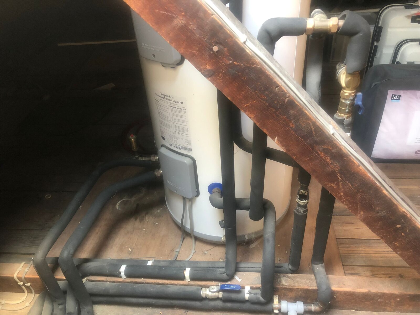

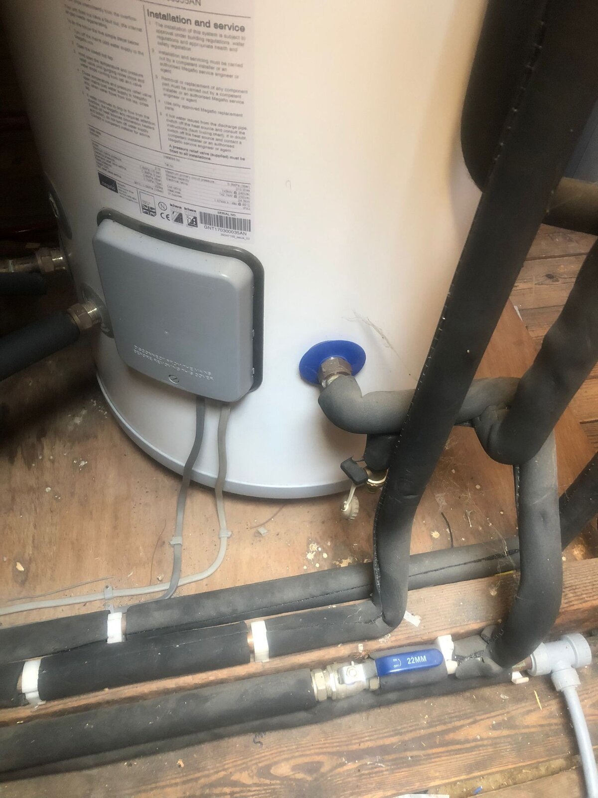

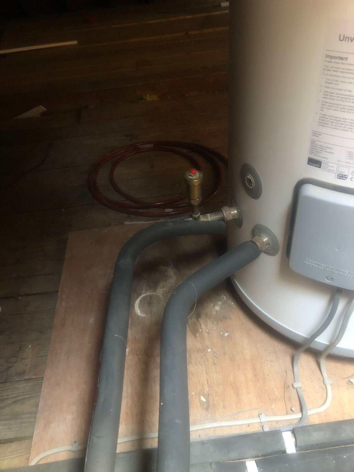

no on the zone valve itself, you have 2 probly in the airing cupboard where the mega flow is but not always , post a pic of the megalo and connected pipes and we will tell you how to chjeck them
Hi Ian,
The megaflo is the loft, the boiler is in the kitchen if this makes any difference.
Attached are some images of the megaflo

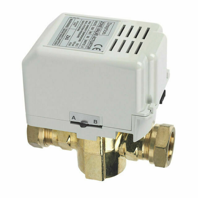

nope your valves are not shown there, you have what is called an S plan so you will have two valves some examples of what you are looking for
Different brands have different actuator heads but all do the same thing, yours might be plastic and different colours there are many variants
You’re looking for something similar to this:
so should be in vicinity of the megaflow or what would have been the airing cupboard.

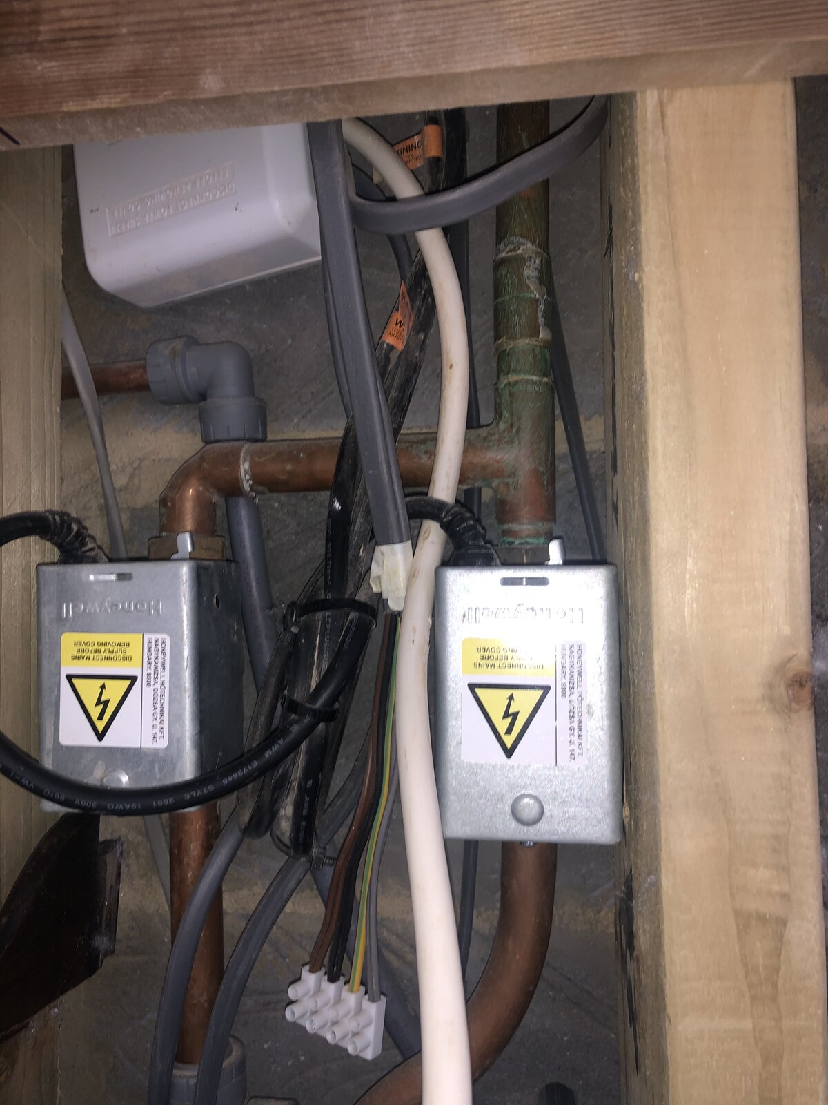

Edited to add -realized it must be those two silver Honeywell boxes - is there anything I can check or is this one for the professionals :D

The x2 metal ones with black cables and yellow/black warning sticker - they’re the zone valves.
we have got there eventually what you call honeywell boxes are the zone valves, you will see a small lever on each valve, when the valve is working correctly and doesnt have a demand for heat, when you try to move that leaver manuslly you should feel a resistance, if the actuator or valve is faulty the lever will offer no resistance when you try to move it into the manual position, switch the CH and HW both to off and feel the manual levers on each valve , they should both offer resistance when you try to slide them across, betting the CH one doesnt
Hi Ian - you are right, unfortunately :D could move one side with zero resistance!
now for the fix.. can it be done by me or is that something I get a plumber/electrican in for?
Depends on your diy capabilities, but we can offer assistance on here if needed. It’s likely to be the actuator (the head part).
