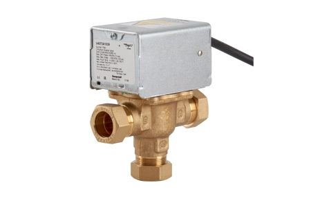

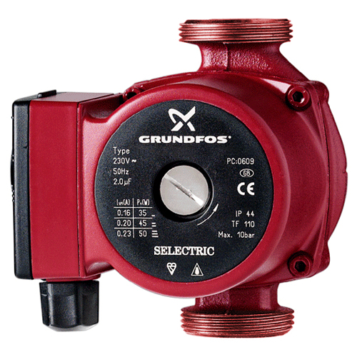

The 3 port valve was vibrating so loudly when newly attached, the tradesman came back out and put it on a lower setting.
That might actually be the pump. I don't think you can reduce the setting of a 3 port valve; it just opens and closes.
Does it look a bit like either of the two images below? Can you post a photo?

Hi @TheGirl, no I don’t mean the 3 port, the pump is likely to be located where the hot water cylinder is located and 3 port valve. You can’t adjust a 3 port valves setting so it’s likely the pump speed was lowered.

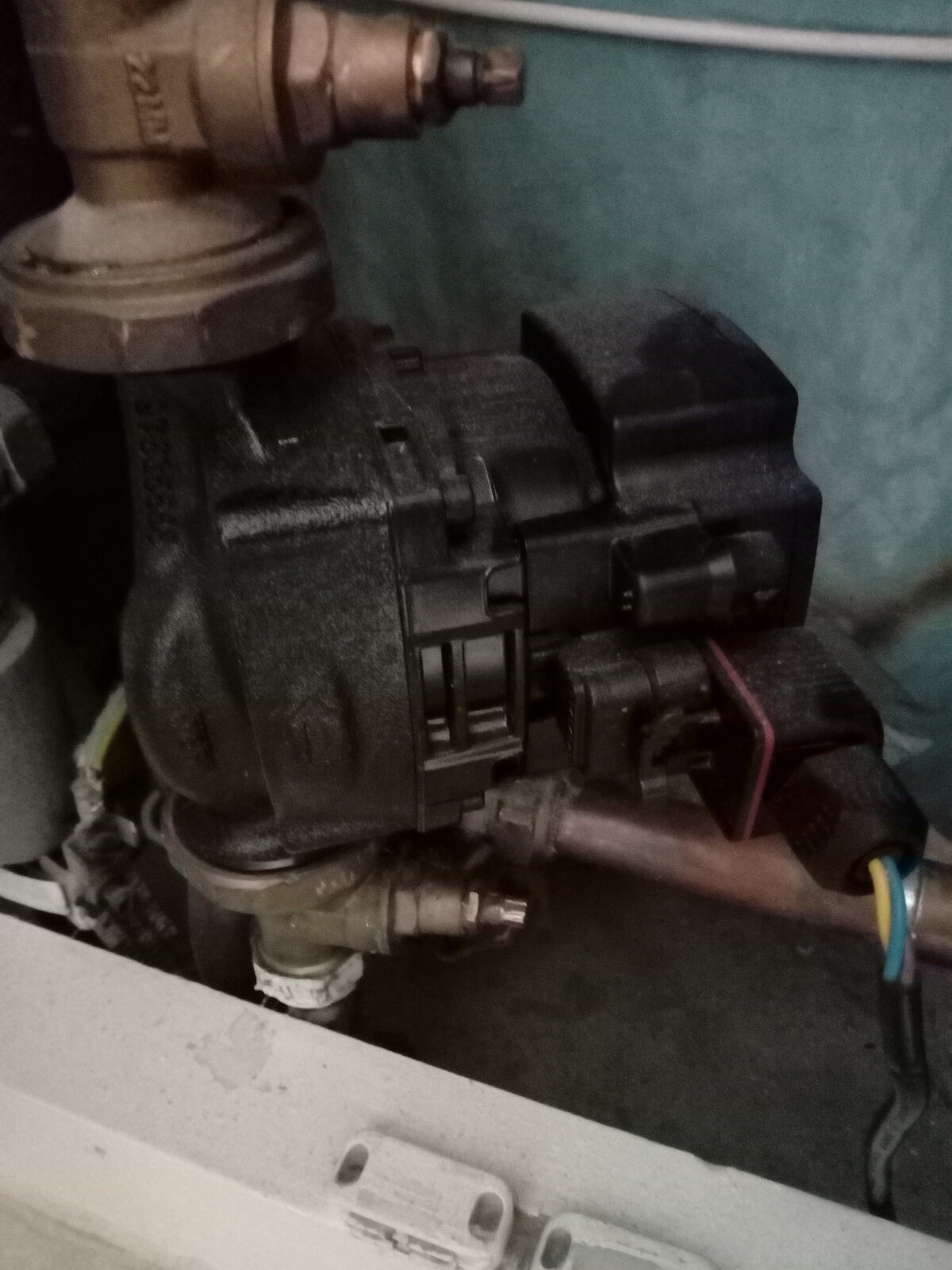

Thank you CBW, yourself and JonathanM are absolutely correct, the 3 port valve is sitting above the pump. Since it was the pump that was replaced this year, and the speed lowered, we can discount that, yes?
Could discount the pump, but check the pump speed - should be lit up on the front. Also those valves don’t look fully open
