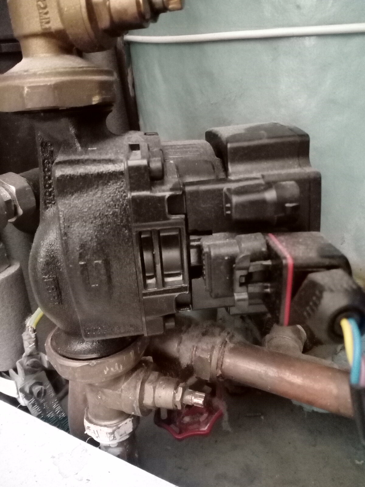

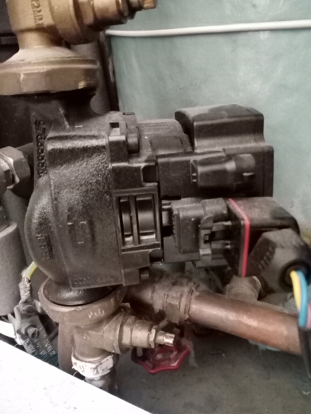

Could discount the pump, but check the pump speed - should be lit up on the front. Also those valves don’t look fully open
This is a better picture. I will check pump speed later- my worry is if it's increased, that very loud vibrating sound which transfers to other rooms will return. I am not sure where the valves are but if they are fully open does this contribute to the boiler firing up consistently without shutting off?

If its increased and the noise returns then there’s an issue of a possible blocked system, power flushes aren’t the be all and end all. The valves are the brass connections either side of the pump, if it’s overheating because they’re not fully open then this can result in firing up and shutting down, especially if it’s getting too hot too quick.

Thank you very much CBW. We have had this new pump around 7 months. It is only in the past week the boiler fires up and then turns itself off. I wonder if the pump is fine, otherwise issues would have been apparent earlier?

As an update: The reason the boiler can't remain on when it tries to fire back up is because on the display you can see the temperature rapidly rise from say 40 degrees Celsius to 65/66 within 5 seconds and so it shuts down immediately as it thinks it's reached the set temperature. It seems it can't understand what the temperature of the room is.

It's actually unrelated to the room temperature. The boiler can only measure the temperature of the water passing through its heat exchanger. It sounds like the water passing through is getting hot very quickly. This can be because not enough water is passing through. When only a small amount of water passes through, it heats up very quickly, and reaches the set temperature, and the boiler turns off, because it thinks its done its job. (Some people say this issue can be exacerbated on your particular boiler model, because they can take longer than some other boilers to modulate, or throttle down, to a lower burn level.)
If the reason is poor flow through the boiler, the answer would be to find out why. And why has it just started happening. It can be because the pump speed is too slow, but that speed was changed months ago. Or it can be that the heat exchanger is partially blocked. And there might be other reasons.
When the tradesman put the F3 in 7 months ago, what did he actually do? Did he just pour it into the tank in the loft, and leave it?

Thank you for connecting the dots JonathanM. To answer your question: yes, he came in with the F3. Poured the whole bottle in the water trough in the loft and left. He said it would take between a week and one month for the noise to reduce. It did but the boiler still kettles.
That's right the pump was changed 7 months ago and a few days later the speed reduced. It was two months after the F3 was added to the water trough that the pump was replaced because the kettling sound still existed. And the supervisor who visited said that if that didn't work, the next step would be to change the heat exchanger. That still hasn't been done as I didn't chase it up.
Regarding not enough water passing through and so it heating quickly: when I first switch on either the heating or hot water, the temperature very slowly increases. So this morning, it took the hot water ten minutes to get up to above 60 and then it switched itself off, tried to fire back up, couldn't. This evening, when I turned on the heating, I stood in front of the display for the entire hour (ouchy!). It took 27 mins to slowly, slowly climb up to above 63 degrees C. At this point, it turned itself off, temperature went down to around 40. It tried to fire back up- it did- and under 5 secs it had reached 67 degrees and immediately turned itself off. Same thing happened one more time. So that's 30mins of the boiler not being on out of an hour even though it's switched on from the console. I'm assuming the same thing is happening with the hot water. So, I wonder, if there is not enough water passing through, wouldn't it behave the same way the first time either the hot water or heating is switched on?
When it fires for the first time, it's starting from a much lower temperature, so the water going through it takes longer to heat up to the set point. The other thing which will probably be happening, is that the boiler will be modulating down to its lowest setting. So, it will be heating the water much more slowly. When it fires for the second time, there isn't time for it to modulate, before it cuts out.
