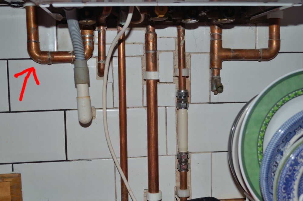

I'm very reluctant to leave the boiler banging away for a full minute in order to check that. By DHW do you mean direct hot water? I'm not sure how to check the central heating flow while I'm running the hot tap. It sounds as if it needs two people and the plumber didn't come today. I'm starting to look and smell as if I've been to Glastonbury for a week. I'll see if I dare test it, perhaps by running it for 30 seconds and then doubling it.
Done that as described above, starting from the instant the hot tap was turned on and it turned out to be a very neat 8 litres per minute. I've looked through the entire manual and can find no mention of this anywhere.
The only pipe getting warm was the one arrowed on the left. The room thermostat hadn't triggered the central heating to come on for hours, so all other pipes were either cold or with only residual heat.

If your flow pipe is getting hot/warm, then it suggests let-by into the heating when hot water being used. Usually the diverter valve

The pipe you have indicated is the flow pipe. It should not get hot when DHW is operating. But, feel the pipe further up as you may be getting some convected heat nearer to the boiler, which gives a false reading. Make sure Heating has been off for a while so that it's cool before doing the test.
