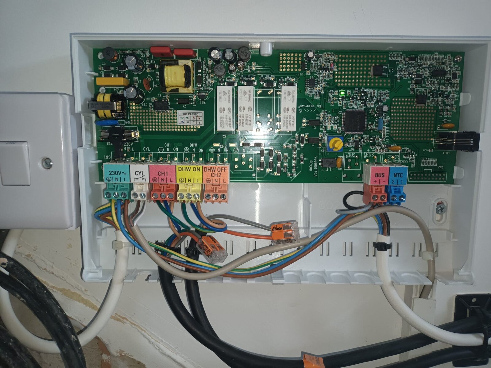

Using two zone valves and a vr66/2 wiring centre
Vaillant gateway with sensoroom
The cylinder stat has been replaced with a VR10 thermostat. The stat has been installed in the dry pocket and wired into the VR66/2
So the VR66/2 is set to 1 and looks to be wired as the diagram above
So I have the Vaillant gateway and can choose hot water boost which I think is a feature unlocked by the thermostat. The central heating works perfectly. The issue I have is when direct hot water is enabled and on it literally never turns off... I got concerned given my taps were burning hot and it was still 75 flat flow temp without any hot water use. So we have turned dhw off and awaiting the plumber.

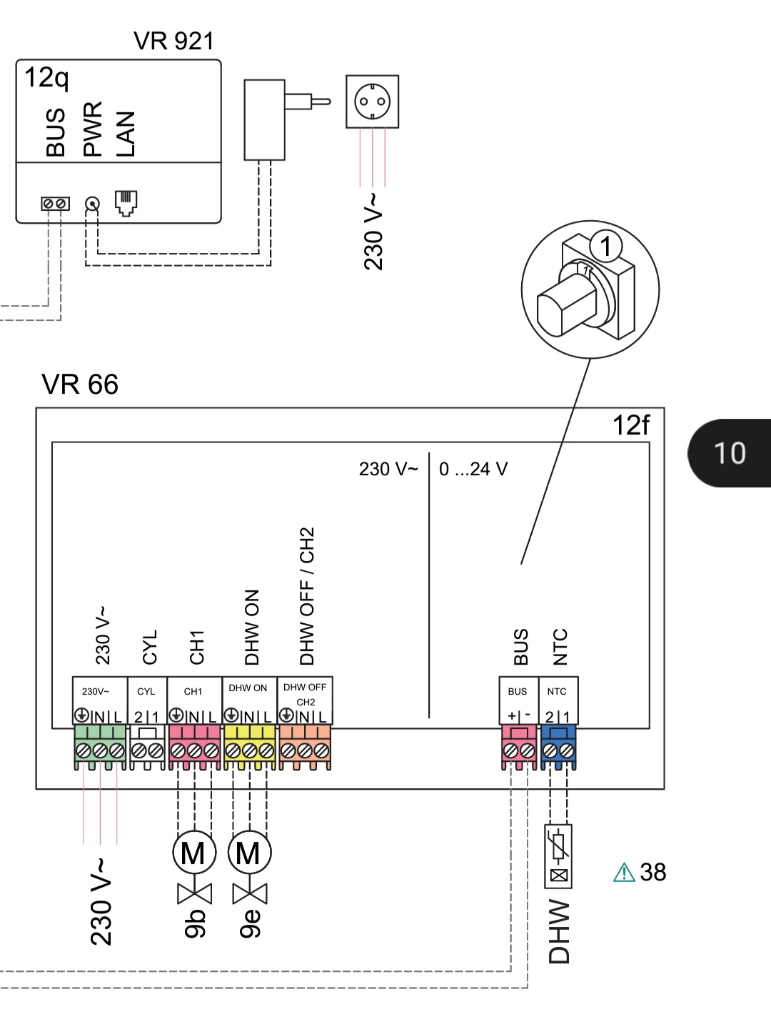

I may be wrong, but I believe the VR10 is a temperature sensor.
You currently have it connected to the stat terminals; these are expecting an on/off signal from the stat, not a continuously varying resistance.
I believe the VR10 should be connected to the NTC terminals...

Correct - Well spotted that man!
I wonder who wired it to the wrong terminals?

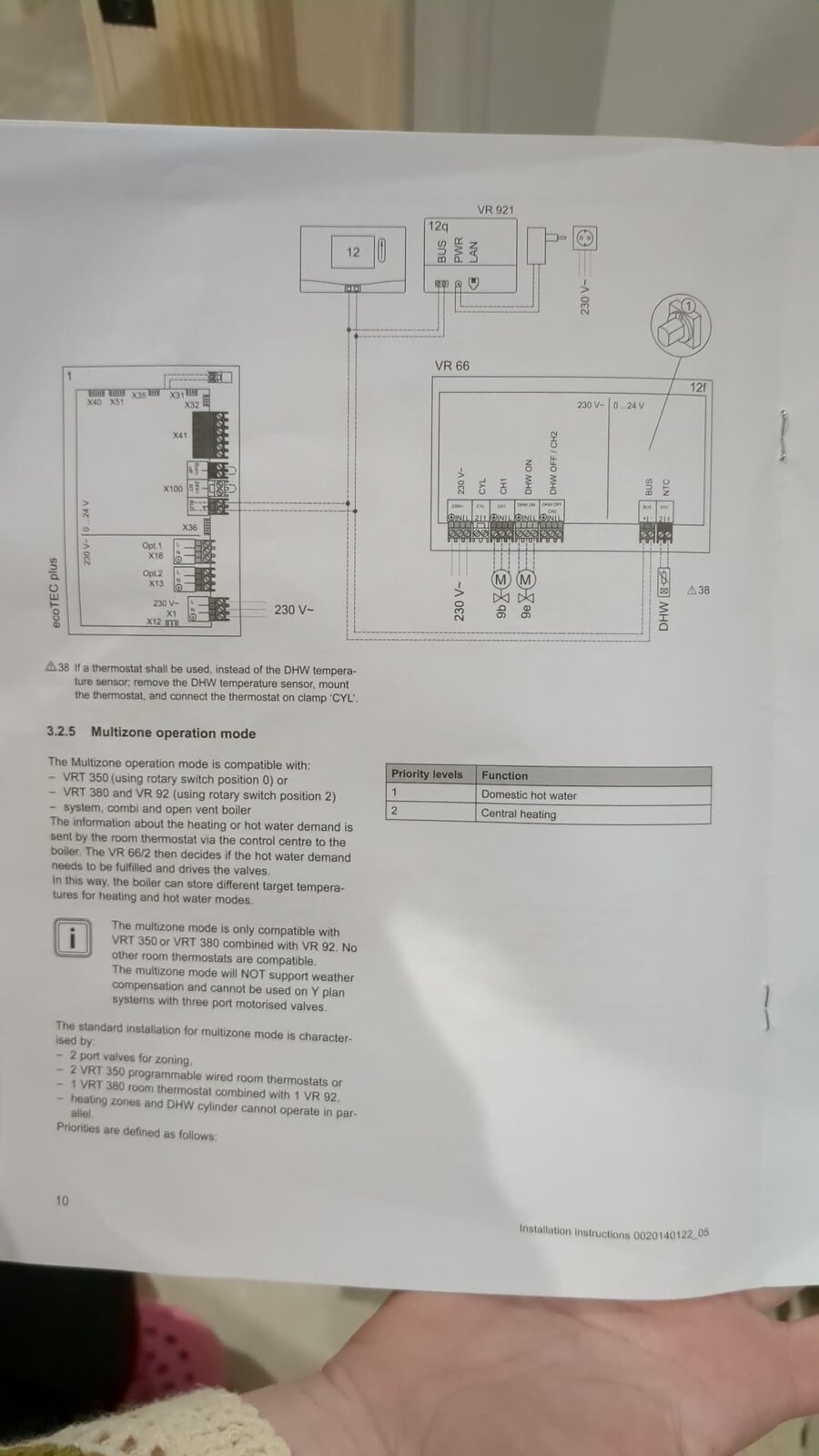

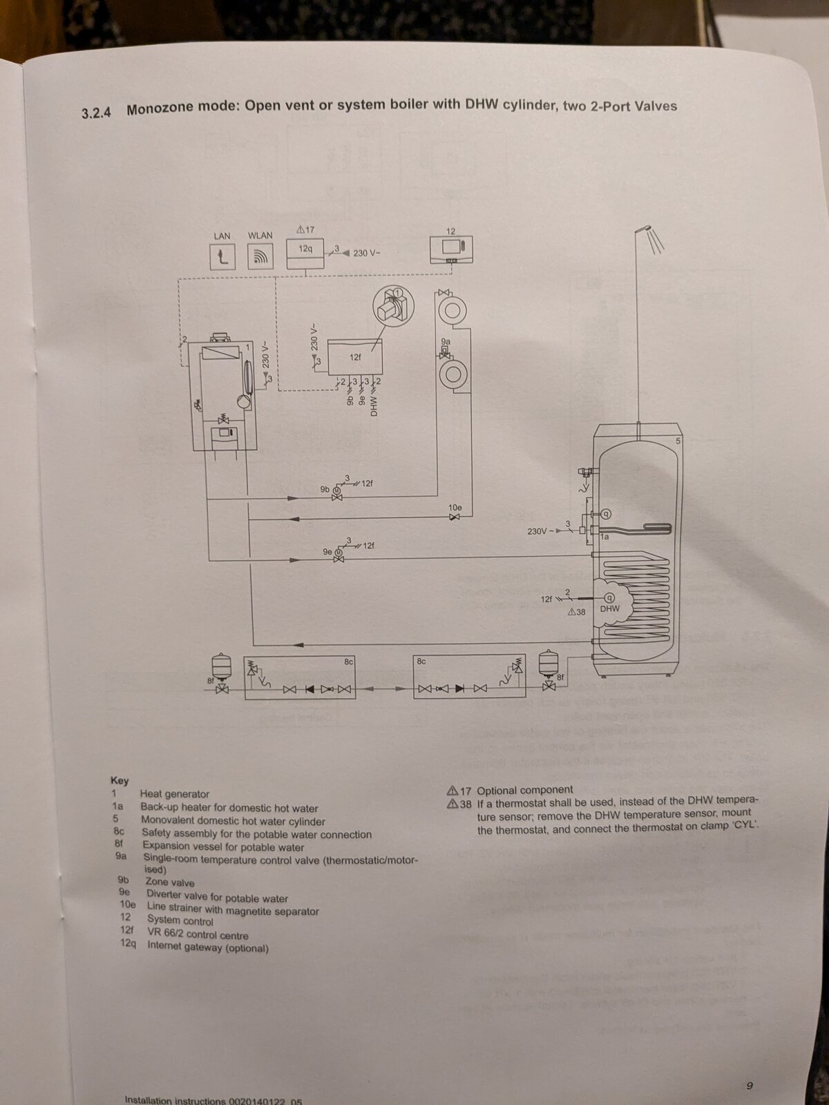

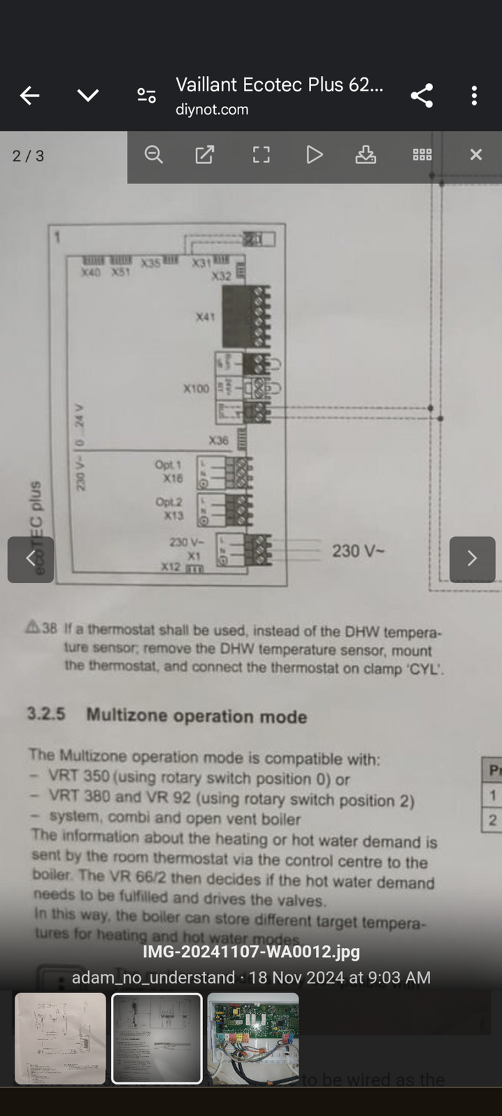

Oh I thought this was correct given the text under the wiring diagram, number 38
It mentions to install the thermostat to clamp CYL. I wonder if it's a difference between a VR10 and some of their other fancy thermostats?
The instructions are not that clear, it was obvious to me, that the thermistor might need to be connected to different terminals, to the stat., but the instructions didn't make it as obvious as it could be.
