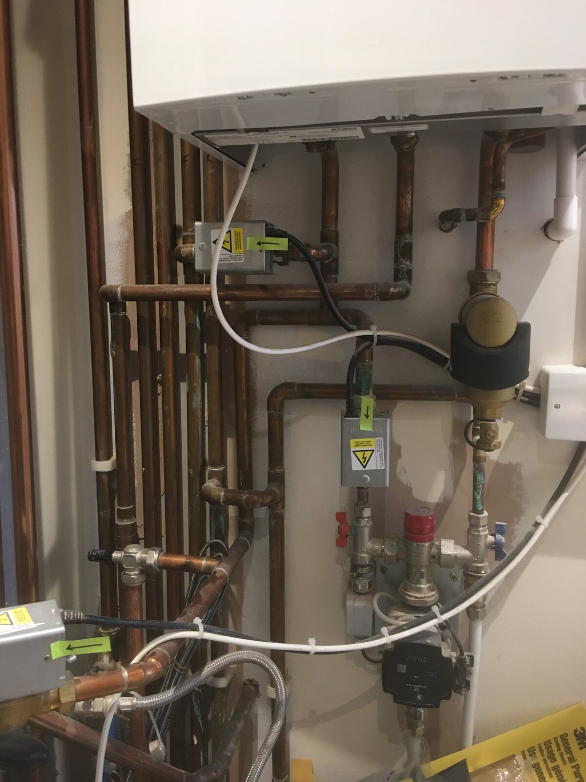

Some background. Went from vented to unvented system 5yrs ago when I added an extension to the house. I have 15 radiators and underfloor heating. Boiler fitted was a Vaillant Ecotec plus 637. It's a S-plan system for heating, hot water and underfloor heating. Water cylinder is 290 litres.
Problem I have is when the boiler goes into pump over run, get banging in the radiator pipes. Not in pipes around boiler, just radiator pipes, happens all day when the system has heated up so it's not the normal expansion/contraction of pipes when heating switches on and off.
Need help understanding why there is banging in the radiator pipes when the port valve has closed and isolated the radiator pipes when the boiler goes into pump over run and water flows through auto by-pass.

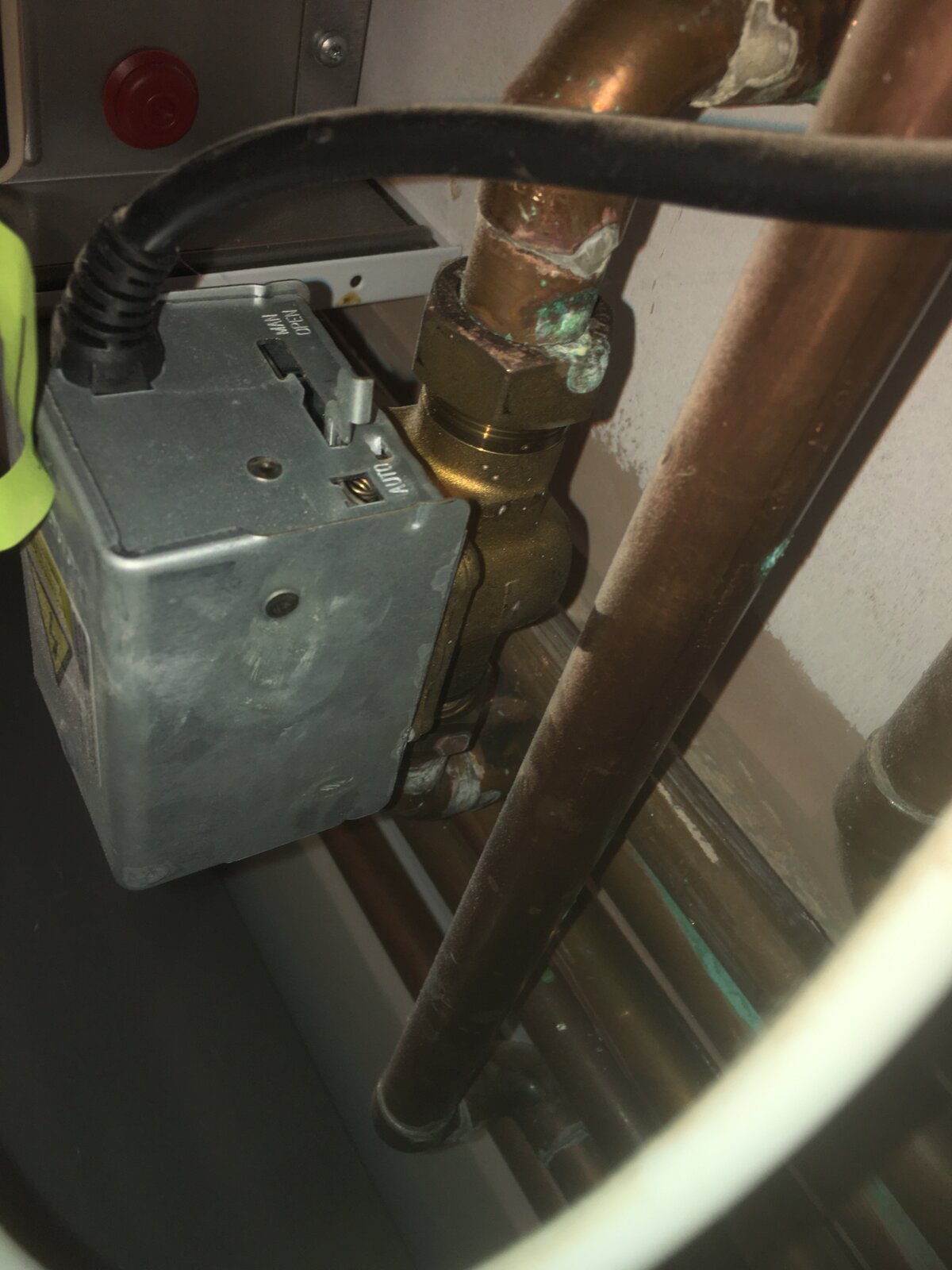

Attached some pictures below. First picture shows the S plan system. Green arrows on the port valve show the direction of the arrow on the valve. The second picture shows the valve on the flow for the central heating (Top valve in first picture). Looks like the valve is the correct way round.

Thank you for those. Yes, they’re in the correct orientation. Could be a trv pin then or a valve not flowing the correct way.
I did take all the TRVs off - made no difference. Maybe I'll just change the central heating port valve.
