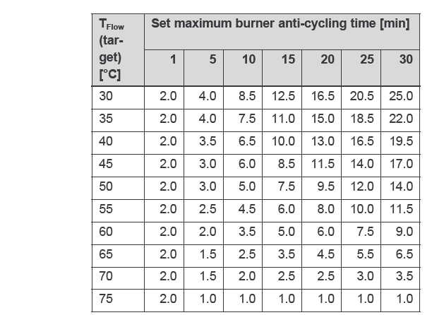

The anticycle time d.02, if set to 5 minutes, is way too low IMO to achieve a successful fire up after recycle, would suggest setting it to 25 to 30 minutes to give a actual recycle time of 5.5/6.5 minutes at 65C target temperature. If you have flowmeters on the UFH manifolds can you add them up, by knowing the manifold flow/return temps then easy to calculate the UFH output to see if < the boiler minimum output.

Based on chart you have shared either 20 or 25 mins would be the sweet spot.
