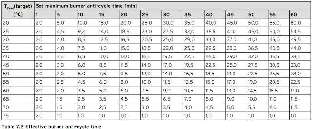

Boiler is an Ecotec Plus 438 and I wanted to know if the d.2 parameter applies to S53, as it does to anti-cycling?
From the manual:
d.2
Max. burner anti cycling period at 20 °C Flow temperature
Thanks!

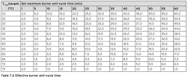

not sure what the question is but here is what d.2 is
View attachment 131784 not sure what the question is but here is what d.2 is
Thanks, I'd found this pic already, and I've set d.2 accordingly.
However, I don't think it does apply to S.53. In fact, S.53 seems to have a mind of it's own. Sometimes it'll recover after a few mins, and other times I've waited for over half an hour and it's still showing (not walked away, so it's not come out and gone back to S.53).
