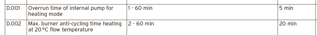

Please can you advise what is the best way to configure the DHW run time?
Also how to set the maximum hot water anti cycle for heating?
To set the anti cycle time? see below.
If you mean what value to set it to then if you have WC you may have to set it to a value that allows the boiler contents to cool enough to enable refiring after the anticycle time has elapsed, if you leave it at its default setting of 20 minutes then the anticycle time is 4.5 minutes at a flow temperature of 65C & 19.5 minutes at 40C. The boiler will normally only go to recycle if the heat demand is lower than the boiler minimum output when the flow temp reaches target temp+5C & burner trip. If the boiler shuts down due to all roomstats/programmed satisfied the it will do a overrun time based on the D.001 setting.
