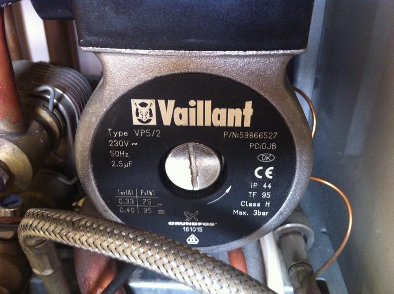

I currently have two issues with my Vaillant TURBOmax Plus 828E boiler, which have been confirmed by two different independent plumbers.
1. The boiler randomly turns on throughout the day & night, A plumber has recently changed the PCB, timing clock and thermostat but this has not resolved the issue. Both plumbers have no idea why this is happening. Do anyone know what else could cause this?
2. Only the first few radiators around the system get hot, these are located upstairs. The system has been drained and bled several times, also balanced. Both plumbers think it is the pump as its no longer strong enough to get the water around the system. The current pump model is Grundfos 161015 which is really hard to come by, but apparently I could use a Grundfos 160928?
Please also see attached images for references.
Many thanks in advance.

Your first issue is probably the dhw preheat keeping the heatexchanger hot, if you want to turn it off turn the hot water knob all the way off and then put it back but not fully hot or you will turn the preheat back on,
as your plumber has changed a pcb , clock and stat I wouldent take his advice about the pump, you need a better "plumber"

I always suggest a boiler engineer rather than a "plumber".
By now you should have been able to discover if the random firing was just caused by the DHW preheat.
Amazing if your plumber changed an expensive PCB without considering the preheat.
