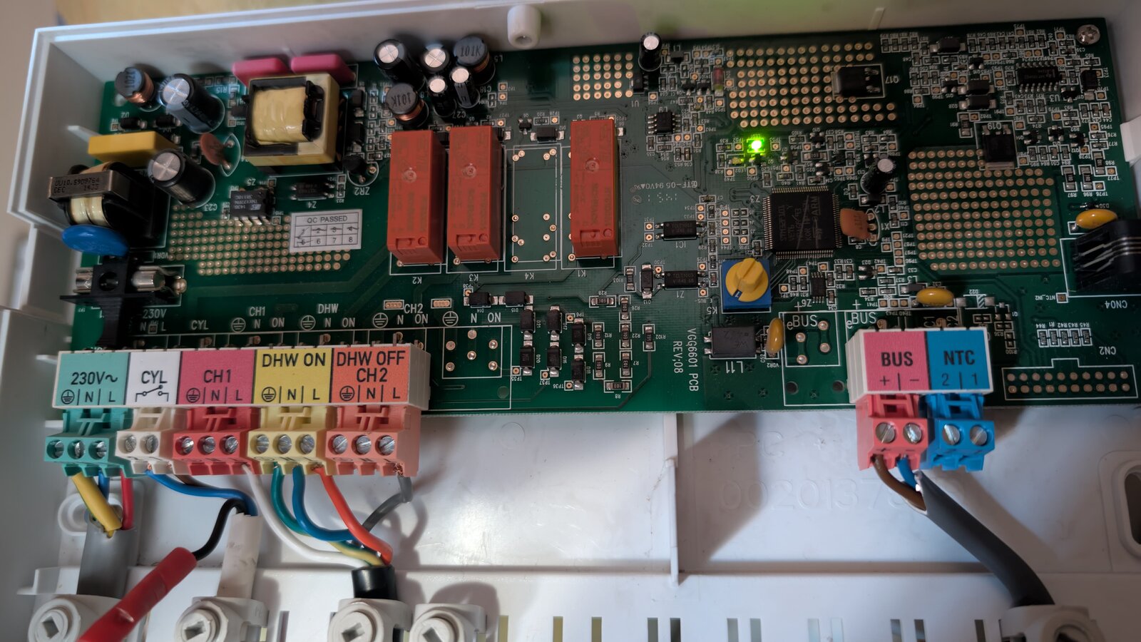

I have a Vaillant 418 boiler in a Y plan reconfiguration. I have just replaced the Honeywell thermostat and controller with a VSmart and VR66 system. Unfortunately I can't get the heating to turn on, but the hot water seems to run fine. I am getting a S30 No heat demand Controller status, but the thermostat is set higher than the room temperature. The 3 way valve moves to Water demand when requested, but when in Heating mode, I only get ~37V on the the white cable to CH1 Live. I also get the same reading on DHW ON Live, but I get ~240V on DHW OFF Live.

It reads to me, as if the VR 66 might be faulty. Does the valve move at all? Is the 37 volt always around the same voltage, irrespective of call or no call?
What is the voltage, on the white L VR66 terminal, if the white is disconnected with a call for CH?
Yes I suspect it is faulty, but potentially only on the heating circuitry? It's very noisy, almost like a small rusty bearing spinning, I've never heard a circuit board be so noisy. I'm surprised that the led light shines green on it.
Yes the valve will move over to W when I request hot water. I actually got a lower voltage during one test, it was about 14V.
I agree with @Harry Bloomfield, a circuit board shouldn't be noisy.

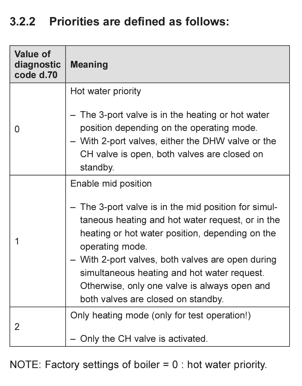

The only thing I wasn't entirely sure about was...

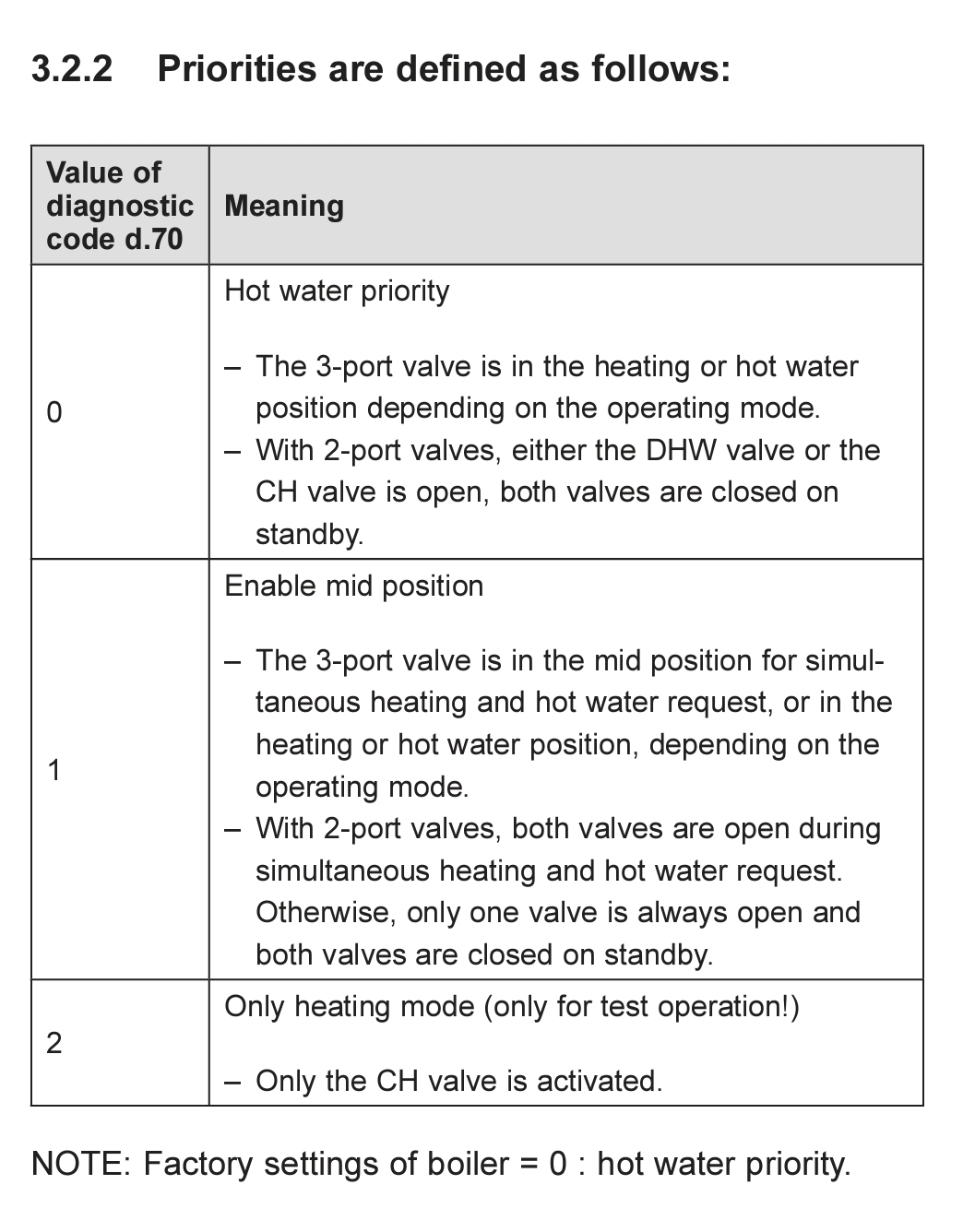

Have you checked what the D.70 codes were?
I believe I had it set on 0, I think this was called Normal operation within the boiler GUI. I didn't ever see it go to mid position during this time so that would make sense.
I'll make a guess at one of the relays being faulty, and chattering, hence the 37volts at the output.
I wasn't aware the Vaillant controls could use the mid-position of the valve, mine does not - it uses different boiler flow temperatures for heating, versus hot water. The only way it can do that, is by serving each, separately, at differing times. If there is a call for HW, then the CH goes off, until the HW is satisfied.
