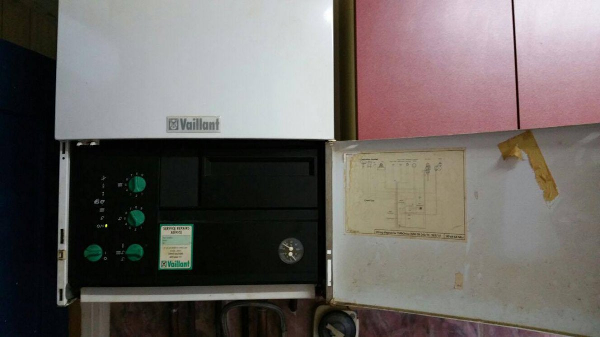

Hi all im not very good at these things but am willing to give it a go. i have an issue with my vaillant boiler as the overflow is leaking at the side of my house and when i have looked the pressure gauge is just over the 3 bar which is obviously to high. I have no idea how to try and relieve this pressure i was told to try and empty some water out of the system through the radiators so i tried this but the pressure drops to 0 but when i turn my boiler back on it slowly rises to just above 3 again. ive looked in the manual but have no idea where the pressure relief valve is and the valve that builds up the pressure is closed. As i said im not great with this type of thing but any advice would be great as i really need my overflow to stop leaking at the side of my house.
any suggests grateful
thanks
model of my boiler is vaillant turbomax vuw gb 242/ 1e, 282/1E hope that helps in anyway
add some pictures too

Fill loop valves are bypassing, disconnect loop to check,
ok fix the problem, was able to find the youtube video on the problem. here the video i watched if anyone else has same issue.
