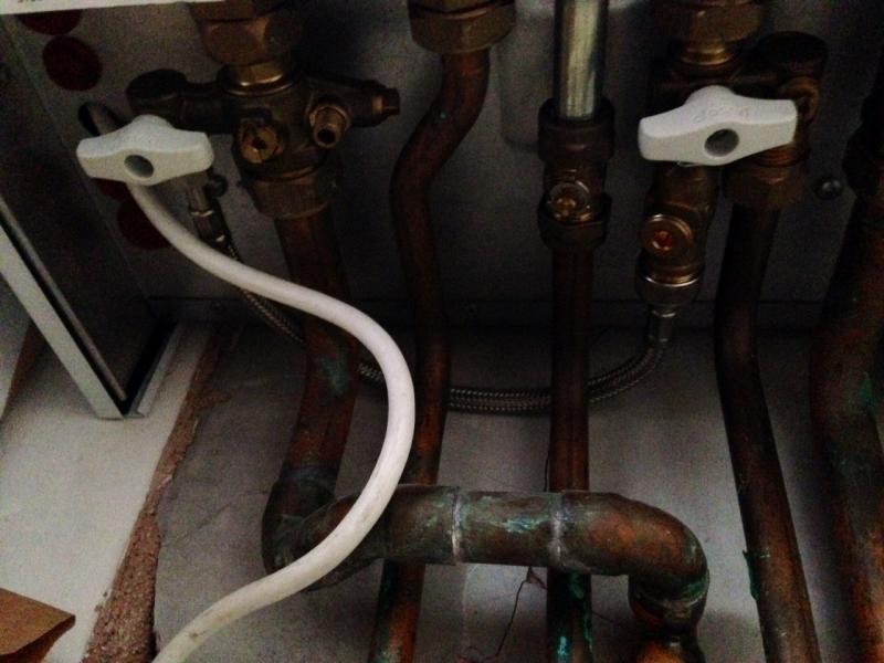

Hello,
I woke up today to find that my Valliant ecoTEC plus was showing the F22 code. After lots of googling I realise what the problem is and have tried followed instructions to turn the grey knobs underneath the boiler to re-pressurise it. The instructions I found said that I would hear water moving when I turned them, which I didn't. The pressure rose from 0.3 to 0.6, but that's it. Am I missing something or is there something else wrong?
Thanks in advance.
It sounds like you were probably doing the right thing but a couple of pictures of the filling loop area would be very useful.
You should repressurise regularly and not wait until the boiler fails!

Thank you both. I honestly had no idea that I was meant to be regularly checking the pressure, I'm clearly not very well house trained!
Here's a photo:
I am on the 4th (top) floor of an apartment block, does that explain the low pressure? Am I ok to use the boiler on such a low pressure (0.6)?[/img]
It looks like the boiler will actually work down to 0.3 bar without the dreaded F22 error.
Below 0.6 bar you may get a flashing warning in the display as a sort of early warning of possible problems but I wouldn't worry about doing any damage by using the system. The pressure will rise a little anyway when it warms up so don't freeze any more.
Just keep an eye on things in case there is a slow leak somewhere and when the system is cold sometime have another go at repressurising to see if the mains has improved.

Thank you, that's really reassuring. I'll fire it up and keep an eye on it.

That's exactly what I expected.
Check the pressure every week and top up if necessary.
Try at 0500hrs and see if you can get it higher.
If the boiler works then use it.

Thank you Tony, really useful to know that I should be checking this. Hopefully I'll avoid it falling below 0.3 again.
Most boilers are set to stop working below 0.6 bar.
