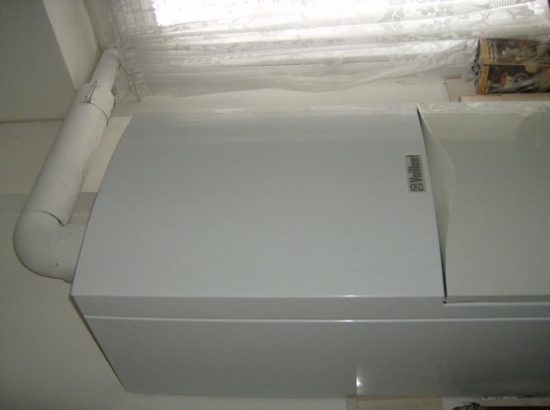

Advice needed please.
I've not not in my flat long (just over a year) and boiler worked fine. My boiler stopped working recently and my boiler insurance company sent someone to look at it and he said that the flue system was completely wrong. He gave me warning notice which says the flue is defected (inlet air duct not to outside source). As I'd already switched it off, he also removed the fuse. Anyway I've since had a plumber round to see about getting it sorted which was advised, and they've quoted me just over £2k because they say that the boiler needs to be moved higher so they can drill though the wall to put a new flue through. The dodgy flue goes through the top window frame at the moment.
This seems really costly considering I was told that a new flue is the only thing needed. I'm also shocked that the property developer didn't check whoever put in the boiler as its only about 6-7 years old! I'm going to ring around for more quotes to see if I can get a better deal, but is that the sort of cost I'd be looking at?
Sorry message is abit lengthy, would be grateful for any advice.

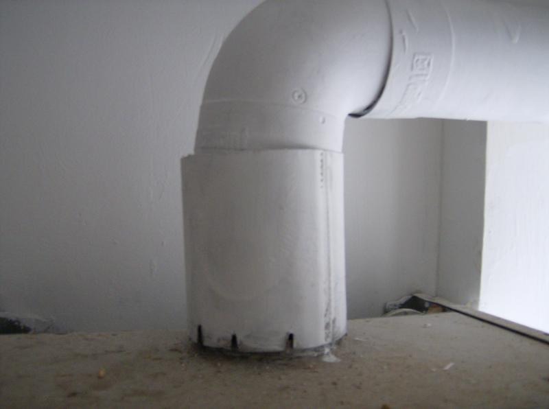

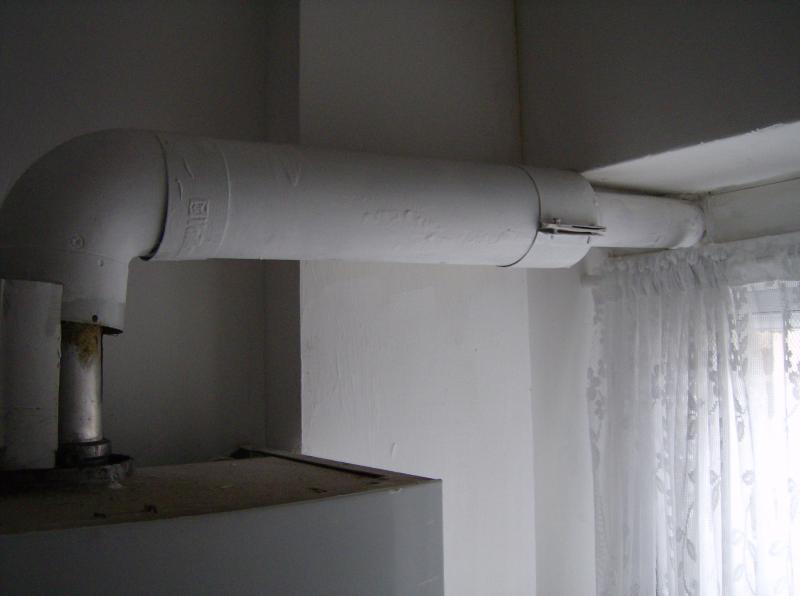

Evening all, I've took some pictures as suggested by Tony so here there are. Hope their clear enough.
sorry about angle of pic.
That installation is outrageous and totally unsafe :shock:
I cannot believe this was fitted like this from new when the propery was built.
It needs riddoring and the **** who installed it reporting.
Flue needs chucking away and a new proper one fitting. Hopefully there is enough space above the window lintel to fit it through.
It will also depend on whats outside where the flue will terminate.

It needs a new flue, extension and elbow and maybe some other flue bits.
Perhaps about £100 worth.
The whole question is whats the distance from the ceiling to the underside of the window opening.
It really needs about 500 mm to do the job properly within the regulations.
Some may agree to do it if its a little less although it would not give the correct minimum spacing of 300 mm between the flue and top of the window opening.
As far as I can see there is NO need to raise the boiler as a short vertical section can be added.
Tony
