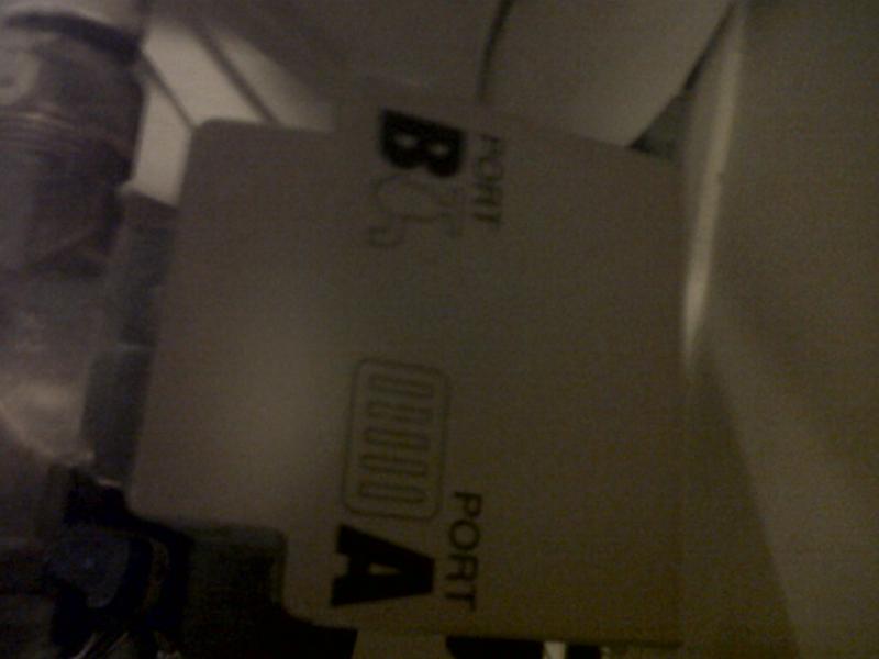

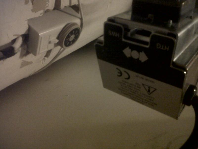

Hello,
Over the last month the valve in the pic has started to make a buzzing noise and getting hot on the side where the black cable goes in. The noise is now quite loud and can be heard at night.
This valve is for hot water or hot water and radiator. I'm not sure why as i can only have the hot water radiator as the gap for hot water on own is blocked by a metal plate. I was told this is a basic system (???) so we use the immersion in the summer for HW.
Anyone know what this buzzing is? The noise/buzzing is all the time even with the central heating off. A bit concerned how hot the meatal plate is too.
Many thanks!
That looks like a motorised valve.
They do sometimes buzz a little and occasionally quite a lot. They also get warm but too hot to touch would be unusual if the circulating water is cold.
It can sometmes just be a mechanical resonance and rarely the motor itself. But the motor can usually be changed on its own.

Sounds to me like the motor isn't switching off after moving to the alternate position.

The motor does not swich off (as you put it) after moving to the alternate position (which I assume you mean heating).
Power to the motor will remain, even with the heating turned off, and will only be cut when there is a demand for hot water. It remains open, in a 'stalled' position.

My guess is that this one is worn and continuing to run (ie Not stalling). It's easy to reach - switch the whole valve out. That'll sort it.

A stalled motor produces more heat than a rotating motor. ( back emf ).
Whilst it could have worn cogs on the end of the quadrant gear it would then be clicking and would be less hot.
Tony
It would only click until the cogs had worn. Then it would produce the symptoms as stated. The whole thing needs replacing doesn't it?
