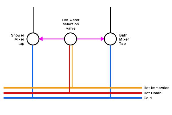

Hi!
I'm having solar panels fitted soon and to make the most of the power during the day I'll be fitting a low power immersion heater and water tank in the loft. Having a combi boiler that means I'll have two forms of hot water supply.
I'd like to have a "selector" valve wall mounted above the bath taps which will change from combi hot water to immersion hat water. This valve won't need to adjust for pressure... just be a mixer.
Then for the shower i'll need a shower mixer valve (which will be adjustable for pressure as well).
I just wondered what valve is necessary for the "selector" Have searched the internet and find 2-way diverter valves and 3way diverter valves but not sure of difference. Any recommendations?
Cheers,
Matthew
The hot water storage vessel for the solar/immersion, will this be vented or pressurised since this will have a bearing on what sort of mixer valve you need for your shower as you are no doubt well aware.
In terms of divertor valve, would a 3-port valve do the trick, hidden and with a control switch somewhere convenient (presumably outside the bathroom, unless you use some kind of wireless version?) to toggle the valve?

The system will be vented. In terms of valve I was actually just thinking a manual one. Kind of like a shower mixer http://www.plumbworld.co.uk/architeckt-avus-recessed-1739-384 . Then I could have it mounted just below the shower mixer but above the bath taps. Just wasn't sure of difference between 3-way / 2-way etc.
Cheers.
Sounds a bit complicated and you can be sure that people will forget to switch it to the solar tank - they'll switch to combi when the solar tank is cold as there'll be an incentive, but the other way round is rather doubtful. Unless you are the only person in the house that is.
Alternatively, you could wire a 3 port valve to a thermostat on the hot water tank (or program a spare relay output on the solar controller) so it will switch automatically.
There is also the issue that your combi produces main pressure hot water, your tank is vented - so there will be a noticable difference in flows between the two. And I'm not sure what the regulations situation is with connecting the two systems since a leaking valve could allow water from the tank to backflow into the mains - probably need a double check valve.

Regarding the 3-port valve. Do they usually have any non-return check valve in them? I wondered if it's definitely possible to have them work so instead of the usual set up of water flowing out to A or B they could flow in from A or B (combi or immersion)?[/b]
In general, a 3-port valve doesn't have check valves incorporated. You will need these in your arrangement to prevent cross flow between main and stored water as any means of backfeeding non-mains (and hence potentially non-potable) water into the mains is a big no-no.
in fact, I still don't see why something like this http://www.ukbathroomstore.co.uk/va...h-square-backplate-p-148378.html?currency=GBP (low pressure too so can accept immersion tank HW) can't be used assuming (like the 3-port motorised valve) that it can be used in reverse as 2xInput--1xOutput rather than 1in--2out
It would do (provided you add sufficient check valves) and you reduce your mains pressure. As I read it, max pressure is only 1 bar - but I'm sure there are other options. But as said before, I personally think a manual valve is a complete waste of time unless you are the only person in the house - anyone else will forget what it's for and just switch it back to the boiler the first time they get a cold shower. So you'll not get to use any of the solar heated hot water.
